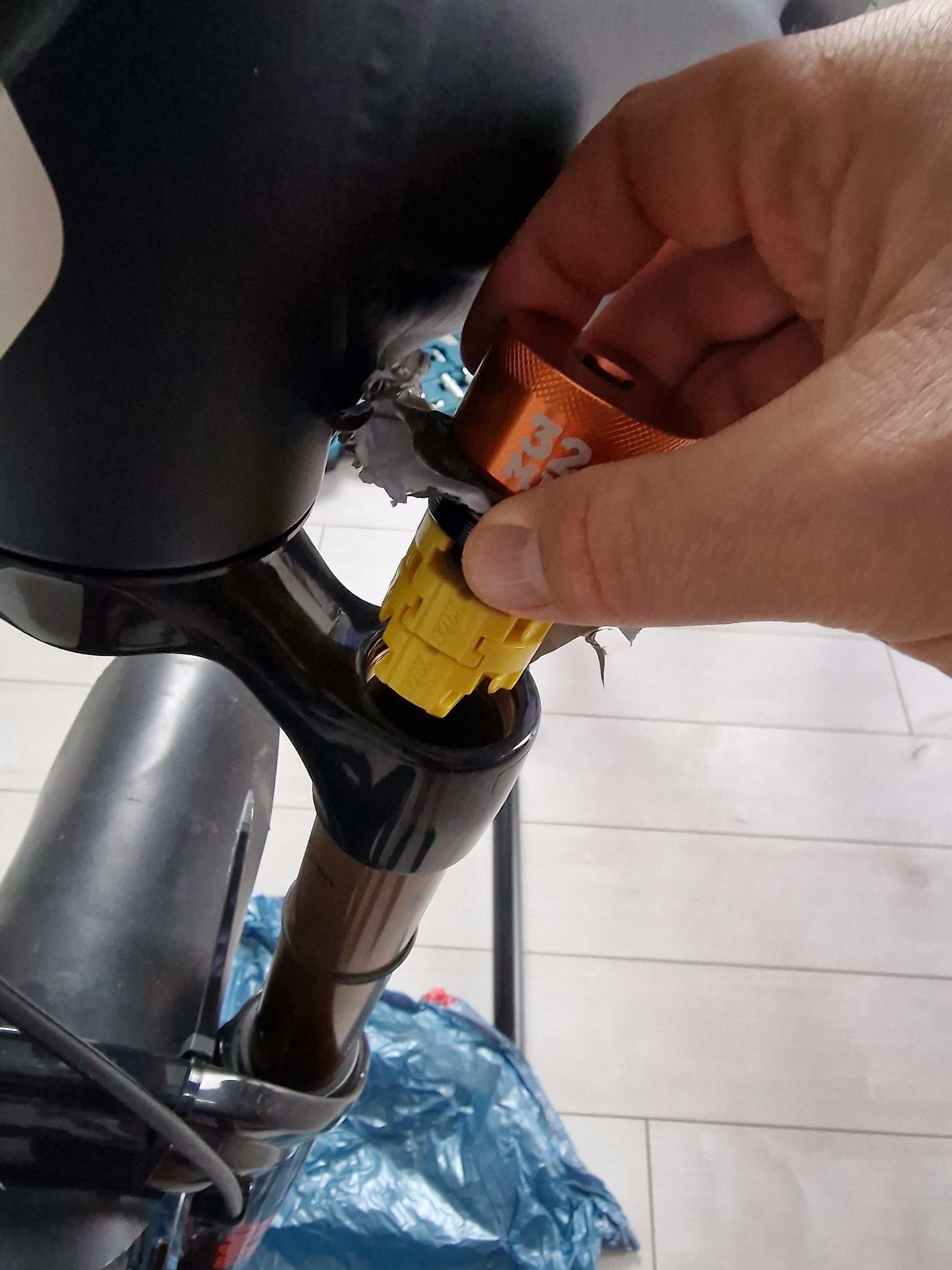

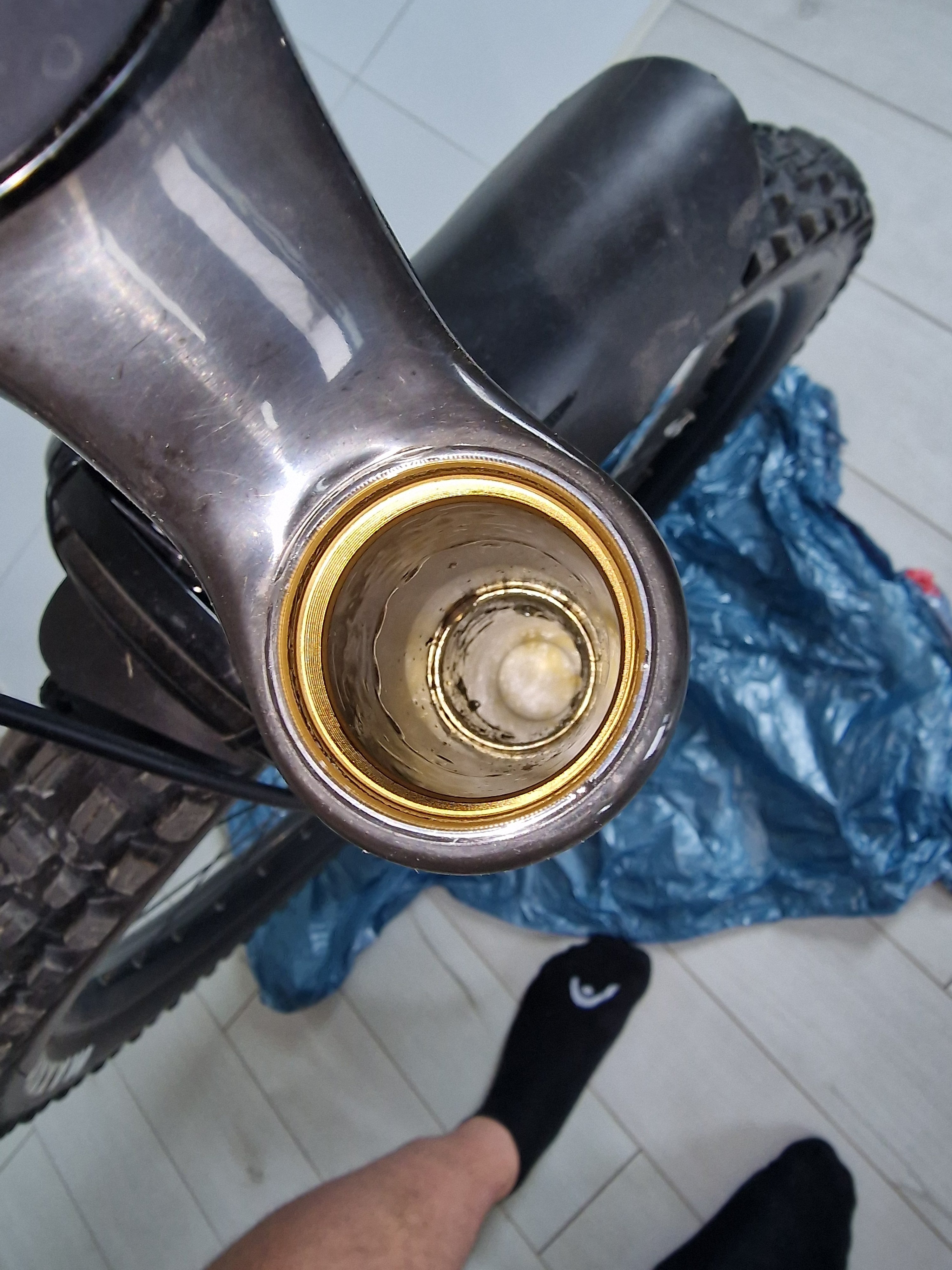

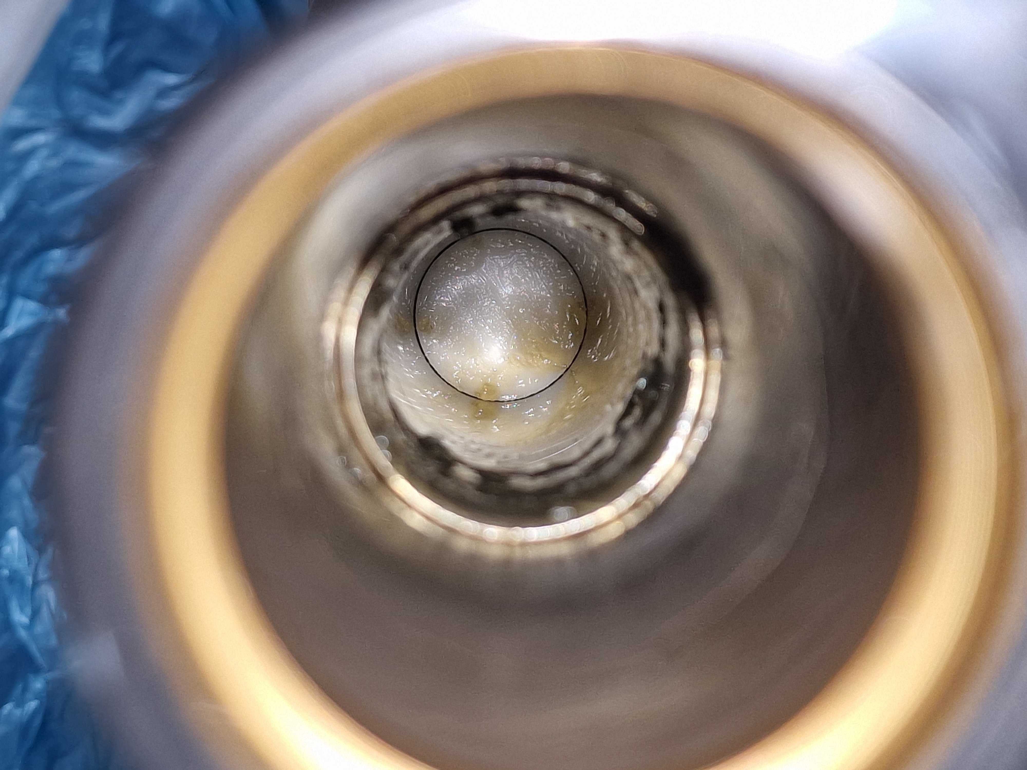

Hi, what do you think about all the extra grease and tokens, here are pictures
If all else fails and you are still unsatisfied with the performance of your fork after trying to adjust it, then there's the option of custom tuning. It's expensive but a good tuner will set the damping specifically for your weight, bike, and riding style. You might need to add or subtract a click here or there but it's pretty set-and-forget. All of my bikes have Avalanche Downhill Racing cartridges and I'm sending a shock there this winter. Warning: once you feel how good a custom tune is then it's hard to accept stock suspension, so call your banker.
