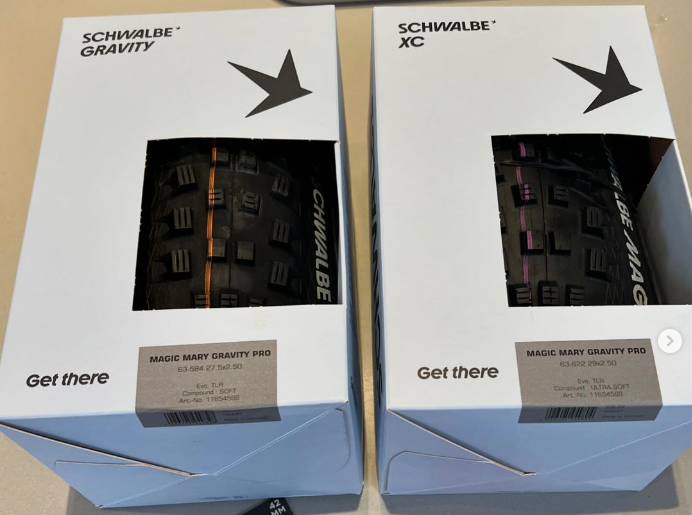

I got a Magic Mary coming for the front, I like something a little bit more aggressive for the front.

I’ve had seven rides (80 miles) on the Magic Mary tires, and I can’t imagine going back to regular tires.
I like the damping and how they mold around trail obstacles. There's more grip, though I’m not entirely convinced it’s the 30% that Schwalbe claims. They’re not a cure-all for slick, wet roots; you still need to unweight.
It took me some time to figure out the right psi for the rear tire. The front needed 1.5 psi more than usual, while the rear required 2-2.5 psi extra.

The MM 2.5 measures a solid 2.47" and works very well as a front aggressive tire.

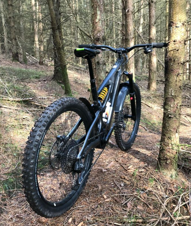

The 29 x 2.5 Albert measures about 2.32". It's working well now as a front trail bike tire on another bike, but it was inadequate for the front of my Relay e-bike.
I have a 27.5 x 2.5 Albert and it measures a real world 2.41" and works really well as a rear tire, that said next time I'll be using the 2.6 version which is supposedly about 2.5" width.

What was inadequate?

The traction was mediocre, at best.

I tried the 2.5 Albert up front on my Relay and that bike is only used on the steepest, loosest trails. It did not perform well. although in the rear the Albert is great.
I now have the Albert 2.5 up front on my trail bike, that sees a lot flatter hard pack riding and very much like it for that application.
