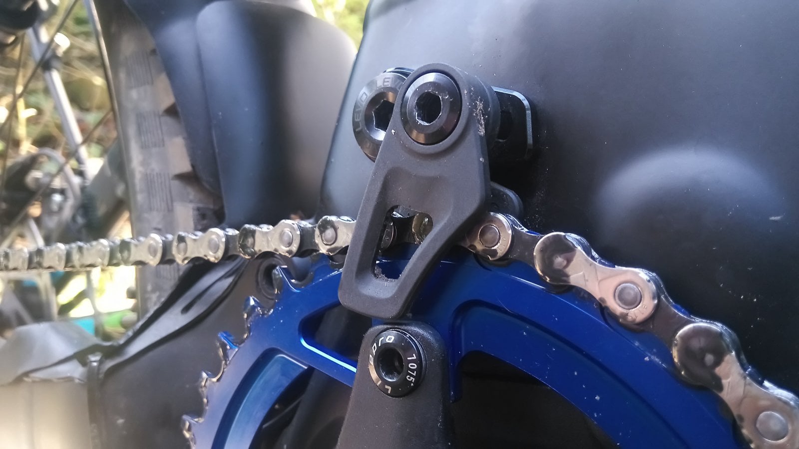

Anyone else had issues once they have swapped out the oem 32T to a 36T front sprocket getting the original chain guide back in a decent position?
Mine keeps catching thought I had it then tried a higher gear and it started to catch again.
anyone got any pics of there’s?

Position with T38, without any modification, which would be a better option. In all farnes does not do a proper job, but hey, with narrow wide chainring you don't even need it.

Thank you for the help guys!
mans thomas that pic was great I copied yours and it works perfect no catching ect

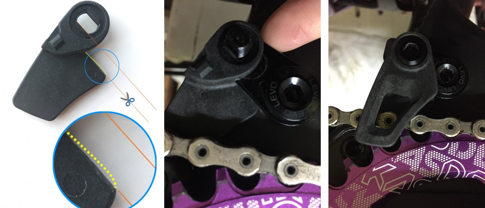

Chain guide can be used; for 36 or 38 tooth chainring shave a small amount off the inner plate so you can mount it rotated 180º
I used a craft knife with several shallow cuts. -- If try to cut too much off in one go you'll find the the blade will get stuck because the material is too hard.

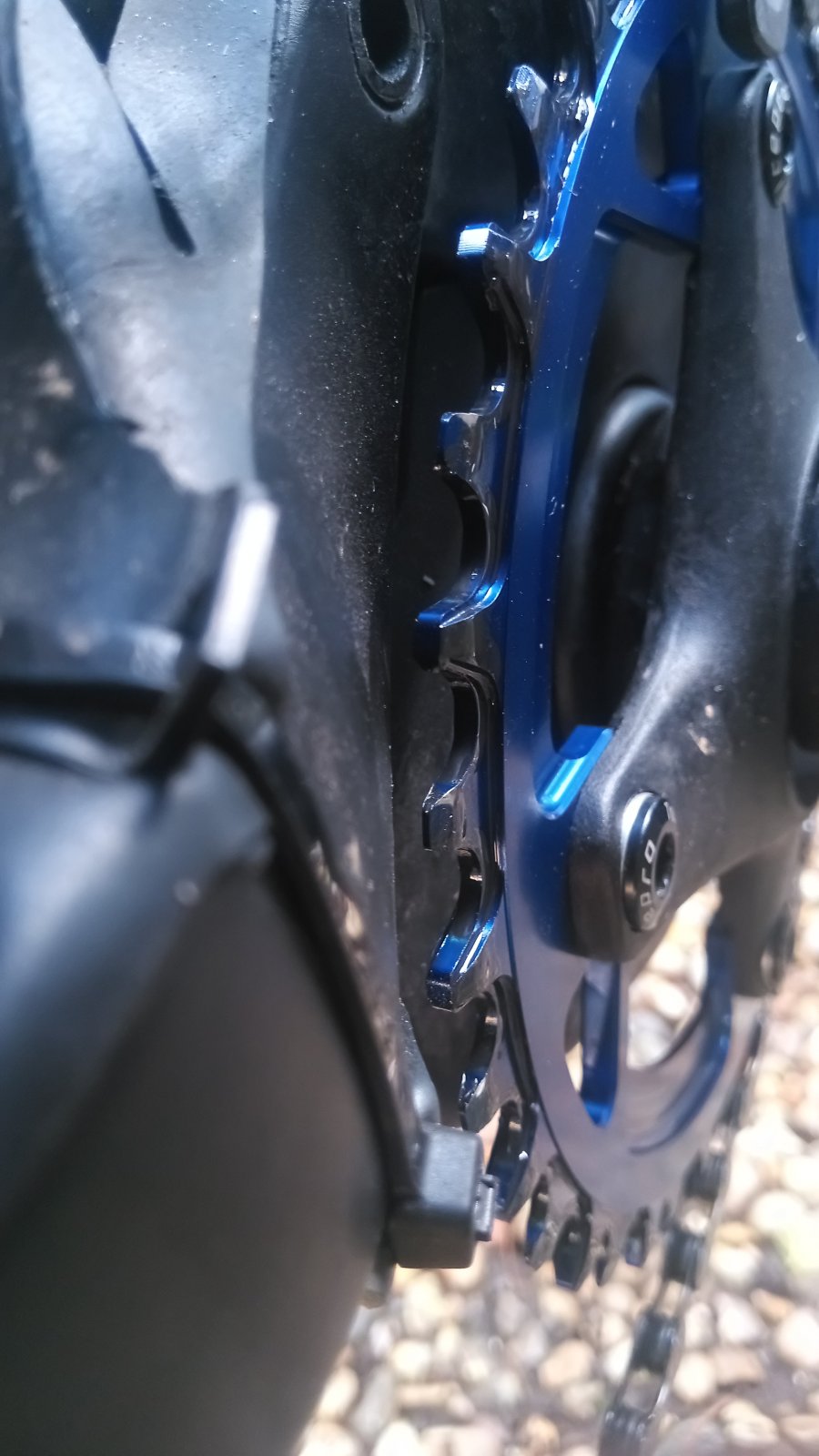

I recently fitted a 40T to my S-Works -- maybe the carbon chainstay has a little more clearance.
How I did it might help those having trouble fitting a 38T.
Mine has the flipchip in the default 29er setting. If you have flipchip set for a raised BB height you will have less chainring clearance. At first the 40T appeared to fit (only just) but suspension was not fully extended. When extended it rubbed...
So I removed the chainring and used a file to change the shape of each wide tooth by making the tip sharper on side that faces the frame. The width of the tooth body was not changed, just the tip. I then mounted it back on the spider and to be sure of enough clearance I put a sheet of sand paper between chainstay and chairing with rough side facing chainring and spun the cranks to smooth off the tips of any teeth that were still a little too close. :)

Yes, the original chain can be used. I upgraded mine and it works well, I will try the suggested guide solution in the picture to see if that works for me as well.
this works because its behind the cog, directing the chain onto the chainring, the other option is pointless due to it being after the chain has arrived on the cog
