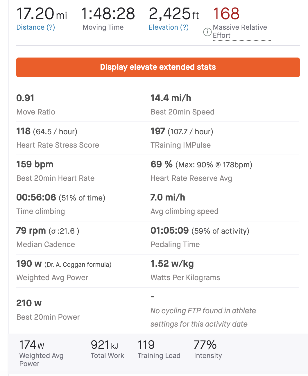

The max current of the SL is 7A but looking at all the rides posted the riders are getting about 1.5-2hrs use out of an extender battery which would translate to and average discharge rate of .5 -.67C which is less of a compromise. I agree that the lifespan of the smaller battery will be reduced compared to a higher capacity battery and I wouldn't do it just to save weight but the slightly shortened lifespan of using just the extender battery should be acceptable considering the convenience of being able to fly with two of theses batteries in your carry-on. Can't do that with any other eMTB battery out there.
I agree, if a rider gets that kind of ride length out of an extender then cycle life should be fine, but that would imply that riders are only averaging 80-100 watts which is pretty low. It's another argument, of course, but when have you crippled an eMTB sufficiently that assist is no longer justified?

You bring up a good point on the ride length, but in reality, the "Pedaling time" or when the motor is active will be less than that full amount. So the average wattage and by extension, the average discharge when in use will be higher. Of course, that will vary with terrain.
Side note: There is a cool third party app called "Elevate" that integrates with Strava on the desktop. One of the parameters that you can check out is "pedaling time". I back out my average wattage (from bike) this way since when I am not pedaling, the motor output is nil.
