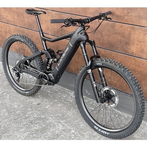

For Shimano certified OEMs like us here at LaMere Cycles, where we build high end carbon eMTB bikes, we can set the EP801 motors to any speed limit up to 28mph. We ship bikes all over the world and there are different regulations in every country, and different regulations all around the USA even, so we talk to the customer and make sure they know what the rules are on the local trails they will be riding and as long as they are in compliance we sell them what they order.
