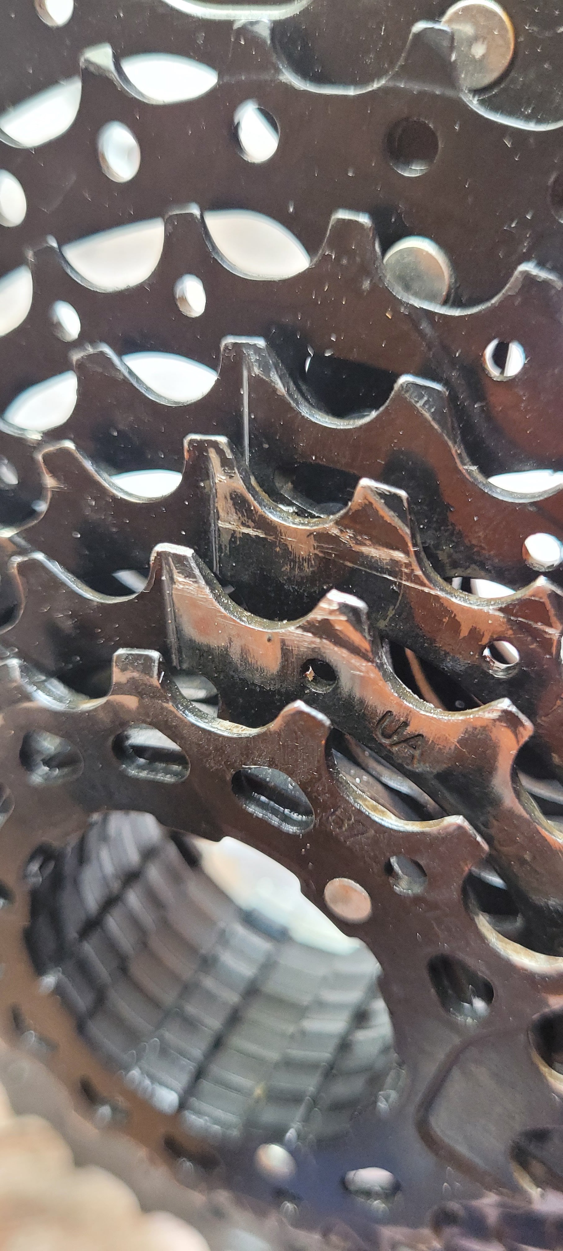

On looking closer the smallest 5 or 6 cogs the paint/protective coating has worn away a touch, probably expected as I've probably been using those the most. I couldn't see any signs or wear or damage......except in the 4th smallest which I've been having issues with. Nothing on the 4th smallest looks worn as such, but what I'd maybe call 'burring' around the edges of several teeth. I tried to lightly file a couple down back into shape just to see if it made any difference, but it hasn't. I ordered a shimano M4100 last night so I'll see if that cures it.
For all I mentioned earlier I'd maybe been a twat on occasions I am surprised at the damage and how easily its been done. I had one big misshift on a big hill (not even sure i was in that high a gear anyway), but generally I'm quite careful when shifting easing off and giving it a moment to shift before applying power again. I had noticed after the misshift on Saturday when coming down the cog that on occasions moving at a decent pace I'd lift off pedalling, shift into a higher gear, give it a moment two to shift and the apply power again and it was almost as if the chain was snapping into place. From there on the slipping got more frequent.
Have you removed the cassette to see if it is still properly rivetted where it ought to be?
I had a Shimano cassette where the gears were in clusters, the clusters were formed by riveting the gears together. On one cluster the rivets had failed and gave me chain slipping symptoms.

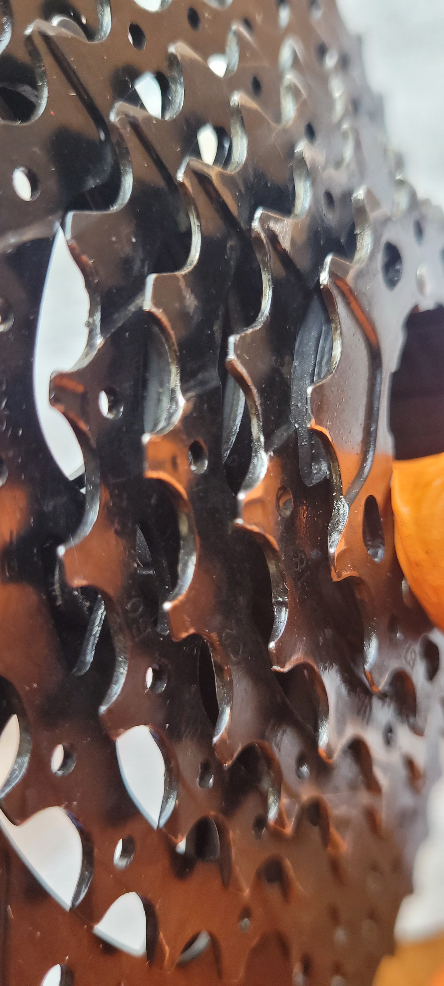

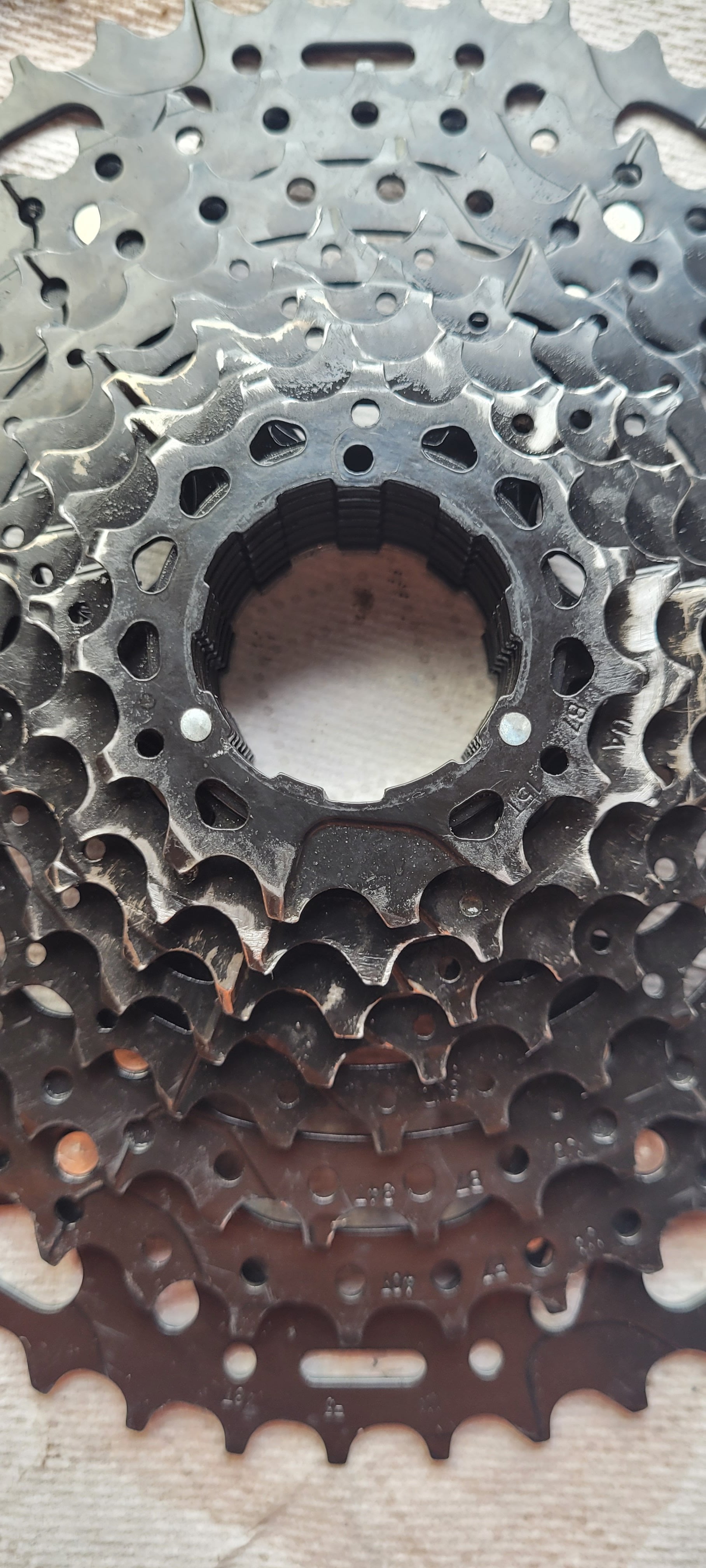

Take a pic and post it on here, showing the damage that you believe is causing the problem.
Can't really see much of it as I've filed a bit off. Presumably there should be three rivets rather than two?
I wonder if the damage I'm trying to show, has been caused as a result of that cog flexing due to only having two rivets as opposed to three.

I think the only issue I've had has likely been caused by a missing rivet or a rivet that has detached in the cassette. That's shown itself in wierd 'flexing' sort of feeling when shifting up and eventually just slipping all the time.

The smaller cogs on the cassette that have damage, can you feel play in the smaller cogs when using your fingers?

Yes. Obviously it's off now but the area where there's no rivet if I go around with my finger behind the 18t that was the issue there's two or three teeth where there's just the tiniest bit of movement.
The bike is a ex-demo that came with 20km on and ive had it just over a week. It was bought from a guy who sells ex demo Konas (he checks out as being pretty high up) and I'm down as original owner. Hence any warranty will likely be me direct with manufacturer, though I have contacted him for advice.
