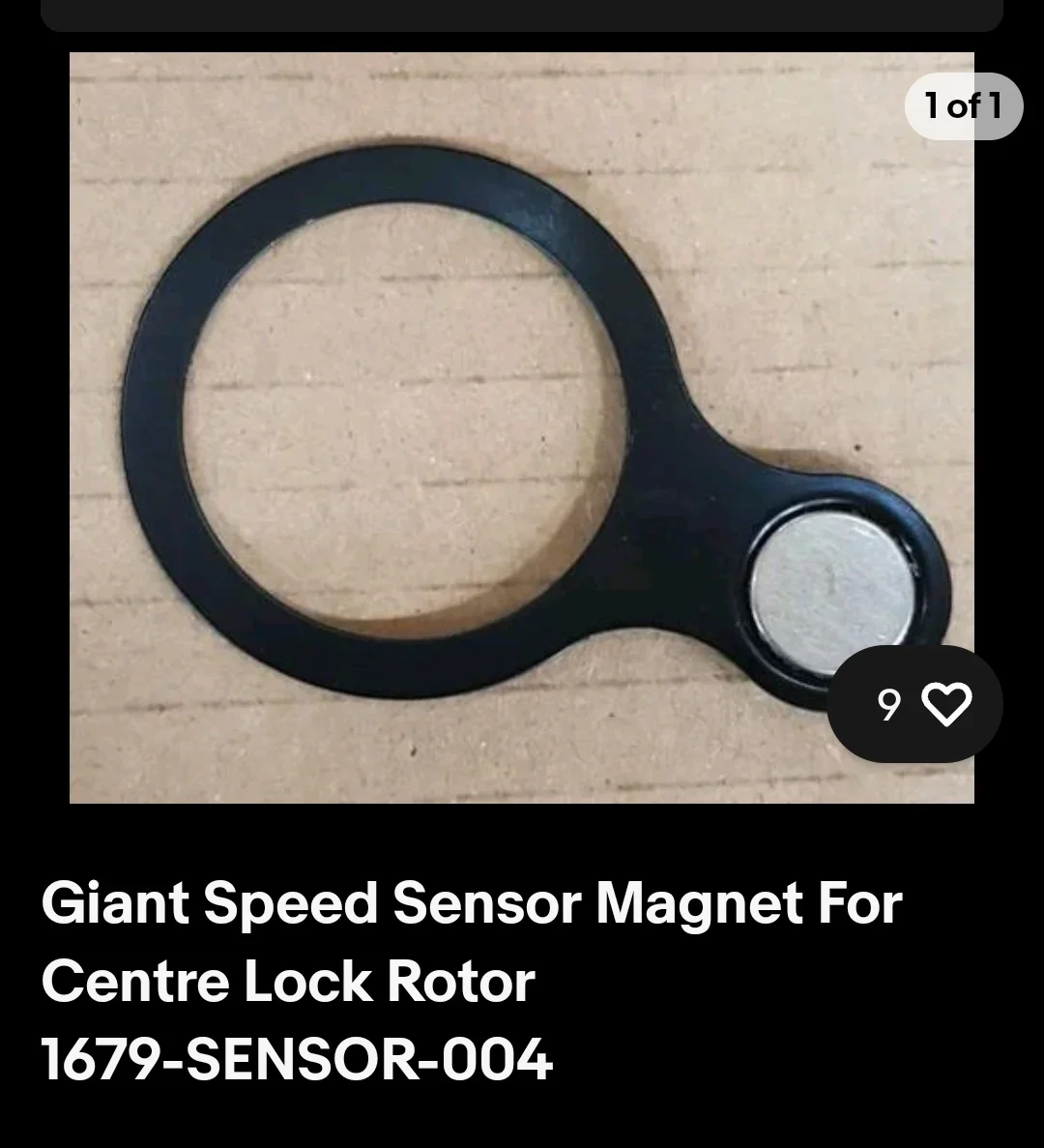

Hi all! I'm unsure which reasonably priced 203mm centrelock rotors to buy. Ideally I'd like them to be 2mm thick & one piece. They must be able to accommodate a speed sensor magnet somehow. Any recommendations? The Magura MDR-C centrelock rotors don't appear to have the hole for a magnet to fit into like the 6 bolt versions?
Context: I currently have 203mm Magura MDR-C rotors which I love, they're quiet & work very well with the stock Sram Code RSC brakes of my Giant Reign E+. However, I have recently changed wheels which are centrelock & would like to replace them with dedicated centrelock rotors as I'm currently using 6 bolt adaptors which, although work fine, I fundamentally distrust
This Specialized magnet works with Shimano also:Specialized Turbo Speed Sensor Magnet, Silver | Bikeinn. Don’t know how is it with Yamaha. Galfer has also discs where you can get their own magnets. Those work with Shimano but not with Gen3 Specialized…and again, don’t know how is it with Yamaha. Quick look through google and you can get all different kind magnets for CL rotors.
Magura MDR-P Rotors Ebike rotors are really good. I've had no issue on my ebike or dh bike 2.5 years of use
Thank all! I ended up buying this which works great & means I can now use any centre lock rotor. It was only £12 too. Screenshot_20260412-105737.webp
