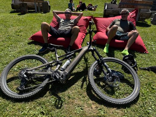

Yesterday I tested the aluminum Turbo Levo Comp. I could title this short review with the title: "Bikes should be tested before passing judgment." Anyway, these are my two cents on the new Specialized e-bike: I have to admit that the Specialized engineers have performed a small miracle.
Despite the bike's considerable weight, from a dynamic standpoint the surprise was remarkable because on the terrain the bike proves agile, responsive, stable, and very fun—in short, a small miracle due, in my opinion, to the great work they managed to centralize the masses.
From a suspension perspective, another significant step forward: the plush effect is evident, the fork and especially the Fox Genie really work excellently (in this regard, it's a shame not to have the 38 front, on this bike it's almost mandatory). Being 1.86 m tall, I'm happy with the result. I tested an S4 that seemed agile on the technical and difficult mountain trails I rode, responsive, very well balanced, even on small jumps, and stable on rough terrain.
The Maven brakes were also excellent, another nice surprise, finally a SRAM brake that works! There's little to say about the motor, it excels in every area and releases the abundant power available smoothly and always usable. So, overall, a truly remarkable bike.
But it's not perfect, and I'll explain what didn't convince me or convinced me less. First of all, fuel consumption: it's true, the motor pushes hard, but this means it consumes more than the old-generation Brose, so much so that it equals it in terms of battery life; despite having a larger battery, overall battery life hasn't increased, and this is, in my opinion, the main limitation of this new Levo.
Note that I used the Dynamic Microtune setting at 10/100 for almost the entire route and at 50/100 on the more technical uphill sections. Another aspect I didn't like was the walk mode: it's too fast on alpine trails where the bike consistently overtakes the rider, creating problems and forcing an unpleasant on/off ride. The assembly: Specialized looks like a bum by installing old-generation SRAM Centerline discs on a bike that costs €7,000 and a Fox 36 fork instead of a 38, which would make the front end more stable and the overall balance better.
The T-type 90 drivetrain, on the other hand, works very well, no complaints there. The weight of the bike is certainly a limitation (we're almost 27 kg with pedals), especially when performing bunny hops and nose presses on tight sections, not to mention when you're forced to lift the bike to overcome obstacles or put it in a car.
In short, it's a good bike, very good in fact, but it's the philosophy behind it that still doesn't convince me: more power (but do I really need it?), therefore a larger battery (hence an increase in weight with the resulting disadvantages) with a final range that hasn't increased compared to my Gen. 3 despite the increased battery capacity for a result aimed at a generalist user, an e-bike that winks more at the motorcycling world than at those who come (like mine) from a cycling experience in which the act of pedaling still prevails over everything else.
One more thing: applause for the construction of the new Levo, which is really well finished, even in the details. Would I buy it? Maybe, but the question I'm asking myself is: Is it really worth replacing my Gen. 3, which does essentially the same things, is lighter, and has the same battery life? I'd have to think twice...
Would I buy it? Maybe, but the question I'm asking myself is: is it really worth replacing my Gen. 3 to get a bike that does essentially the same things, is lighter, and has the same range? Let's just say I'd have to think twice...
