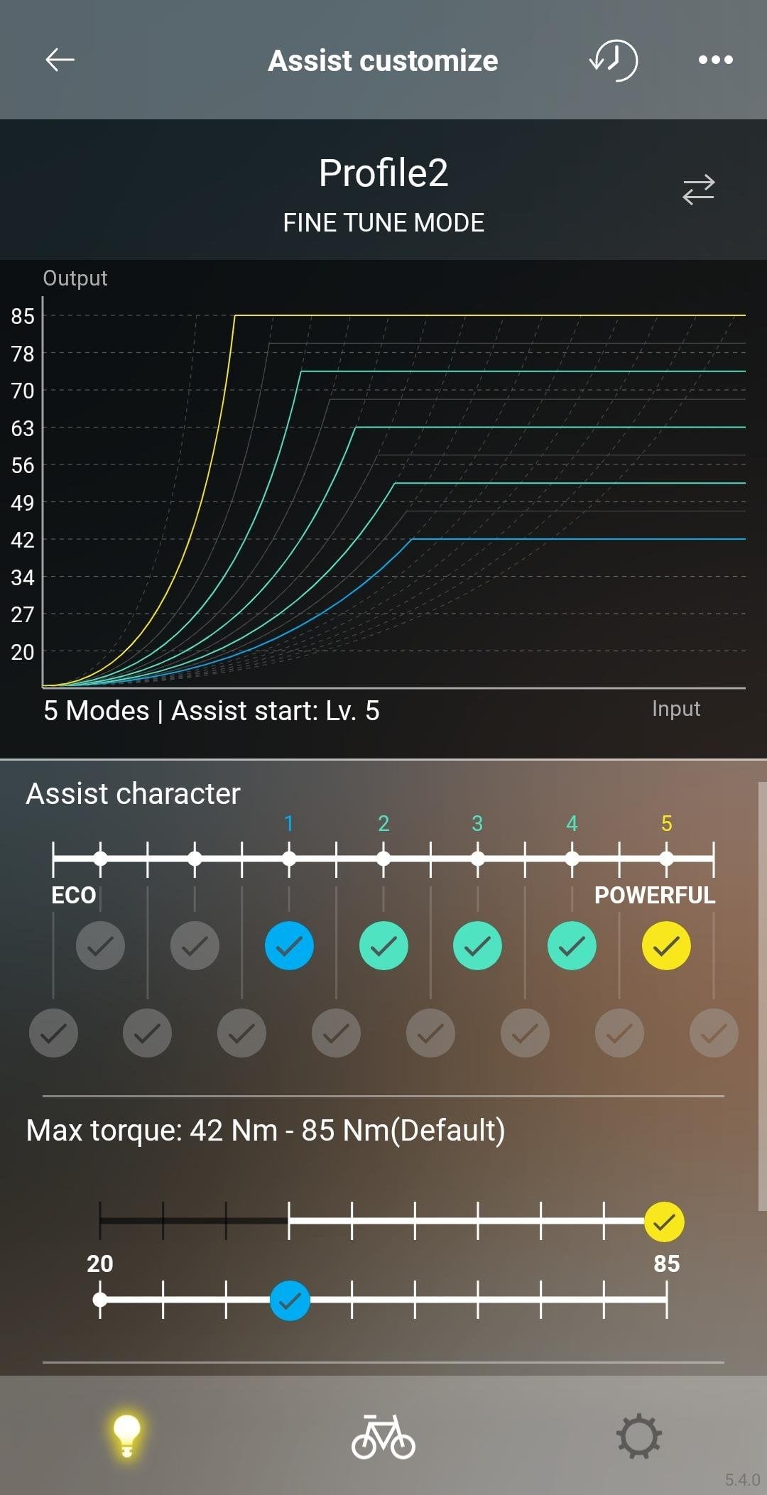

I’ve adjusted the settings in the E-Tube app and do everything I can to maximize range, including "shifting" into the most efficient assist mode for the terrain.

You have set all your lower power modes very high. Level 1 and 2 could be set much lower, so when you are on flatter terrain, the bike isn't adding so much power. You have 42Nm as your minimum assist, which is 50% of maximum torque. That would be like running a TQ50 or Bosch SX in Turbo constantly, when you are at minimum assist. No wonder you are chewing through the battery.
There are 15 power level settings for the 5 Modes. Maybe set Mode 1 to Level 1 or 2. Then Mode 2 to to Level 4 or 5. Then whatever for Mode 3,4 and 5. This way you can set Mode 1 or 2, and be using much less battery.
