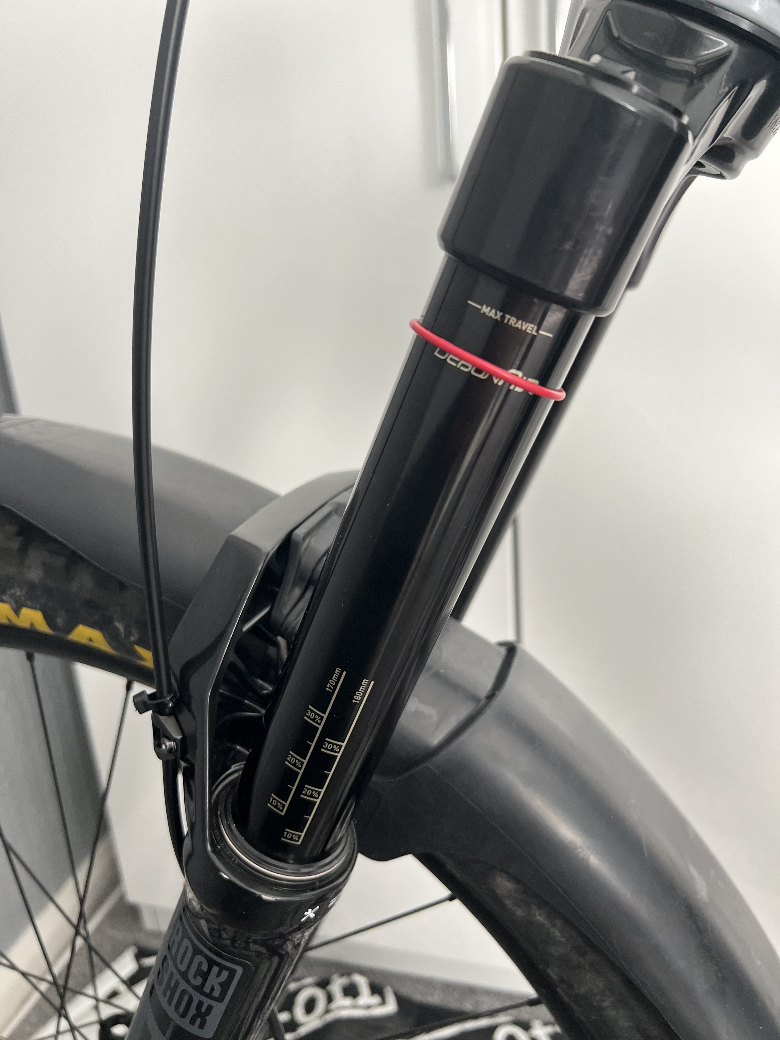

I’ve got a new 2023 Zeb ultimate on my ebike and think I’ve got few issues with it:
* Meant to be 170mm travel but only shows around 163mm of stanchion when correct sag
* Not reaching full travel even when running lots of sag
* Sits quite low in its travel
* Quite rough and keep getting sore hands when riding fast down rough trails

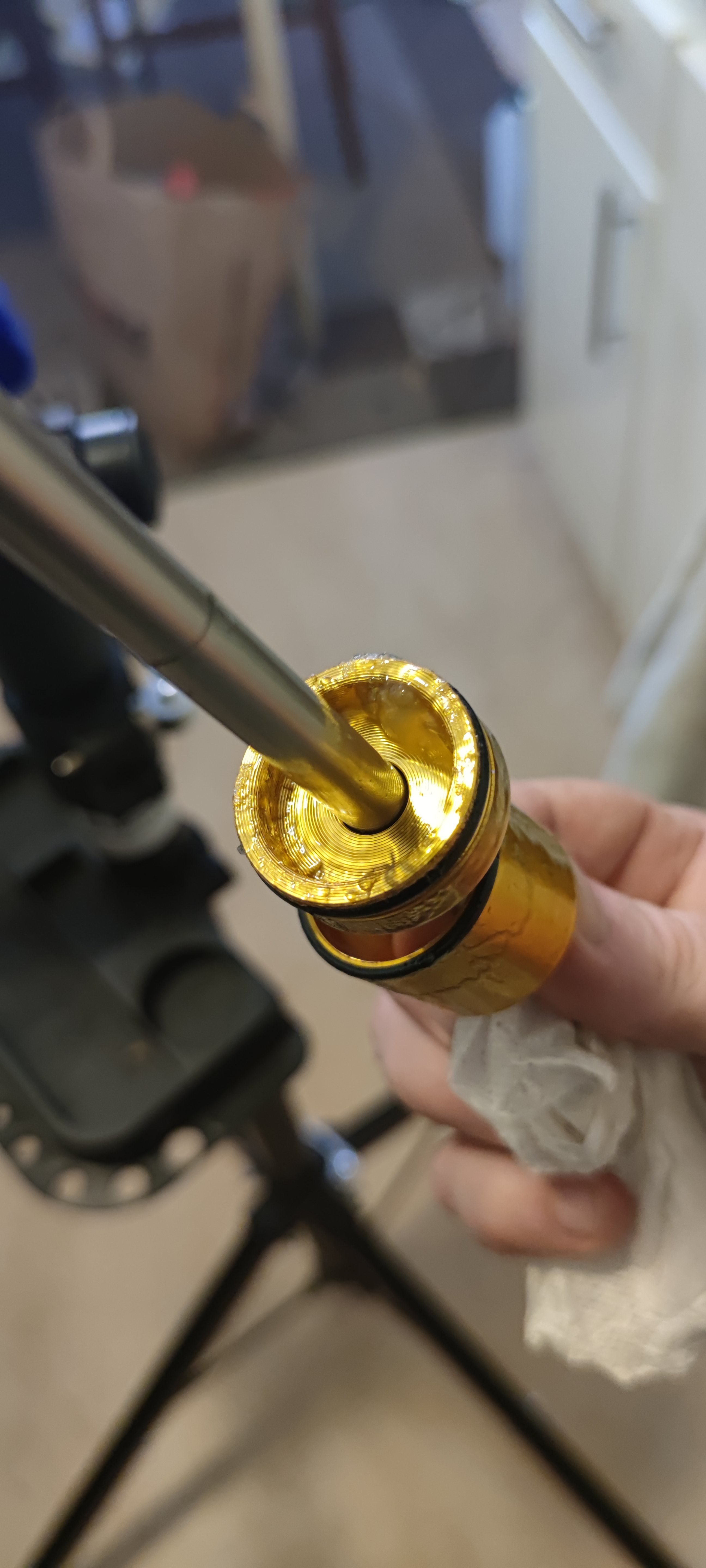

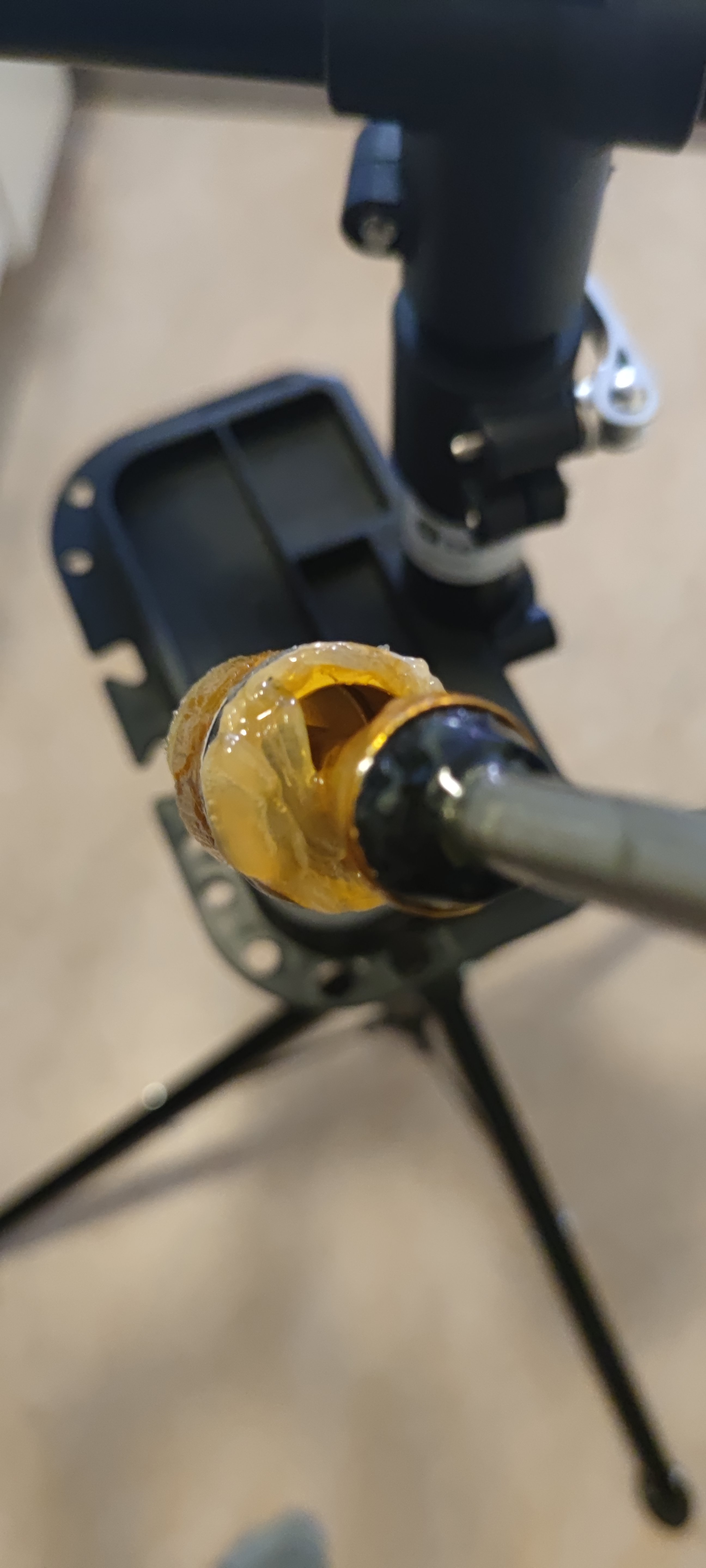

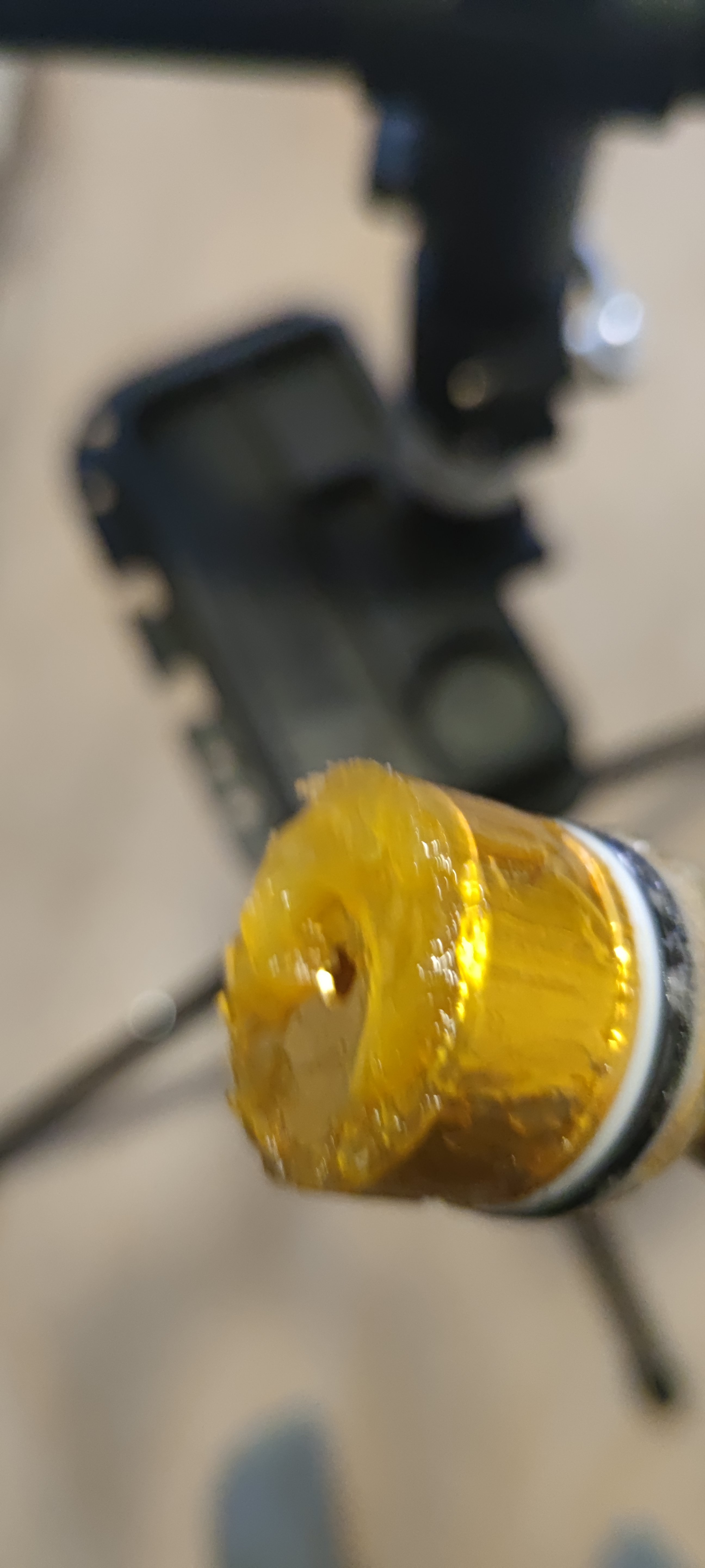

What's the pressure? what's your weight? how many tokens you have inside? (ah, I see 0... maybe too much grease on a piston? it happened before - a lot of grease - decreasing neg chamber volume)
New Lyrik/Zeb have reviews saying they are a bit more damped - sit a bit higher in travel - thus also a bit worse small bump sensitivity.
I pressed both bleed valves on the back of the fork, Right one did nothing but when I pressed the left one it let a load or air out and sucked the fork right in.
You could try pressing the bleed valves and simultaneously pushing the fork lowers down as if to extend them, ie get the pressure in the lowers equal with atmospheric pressure at full fork extension,then close the bleed valve.
Or it might just be that there is a fault with the fork,maybe time to send them back to rockshox?
Airshaft with grease from factory.
And missing crushwasher.
no one is going to apply that much "grease" to the piston so looks like it has gathered all of that "grease from the leg.........in fact is it actually grease or congealed oil?
I think grease, the Zeb is quite new.
In factory i think they just dunk the piston in grease.
When I updated to the c1 air shaft and foot nut on my lyriks, the sram instructions said to use the dynamic seal grease for rear shocks. You use a lot less than the sram butter. Even using sram butter you don’t use that much

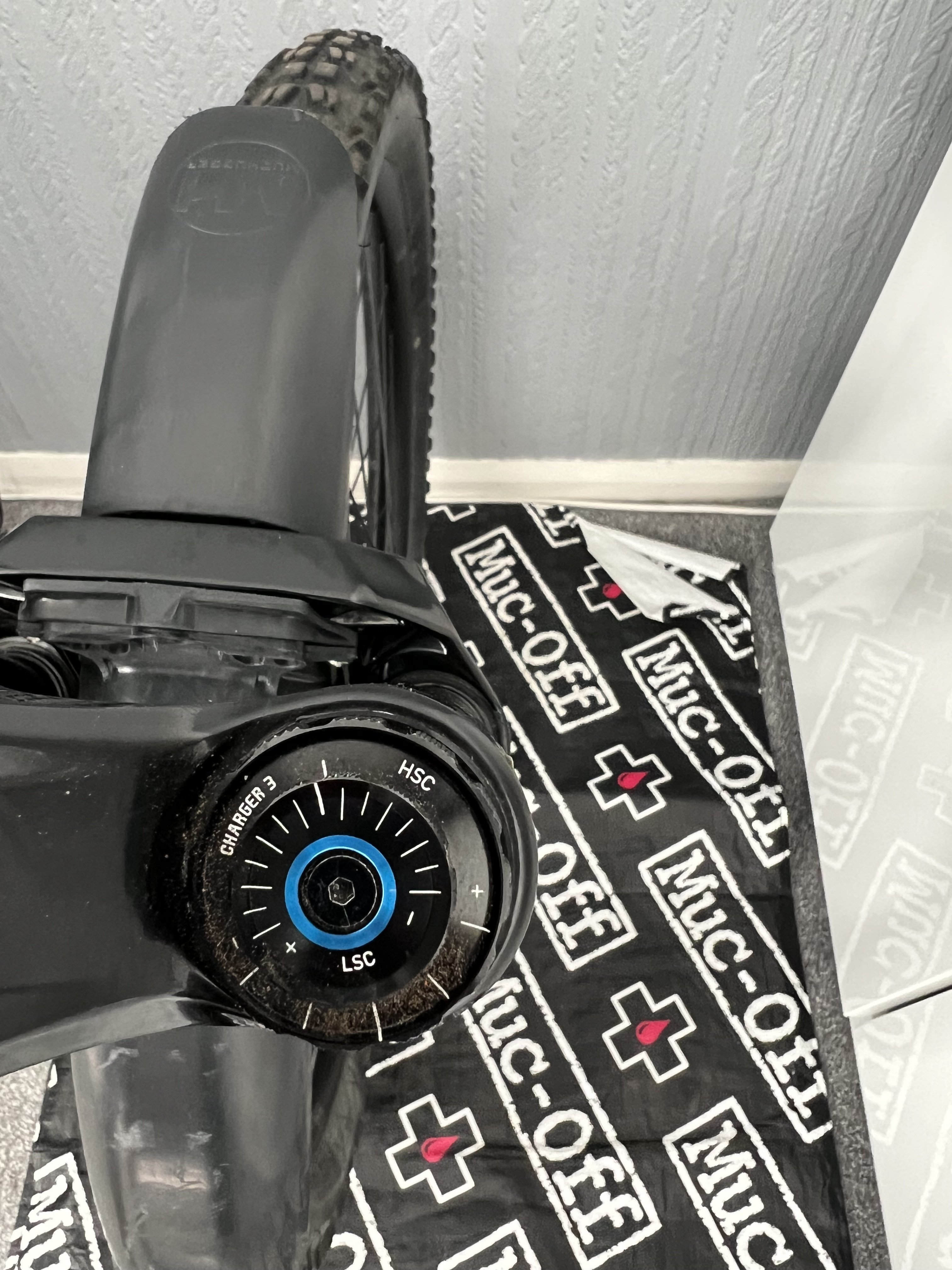

My 2021 Zeb select with upgraded airshaft and charger 3 feels great. i'm around 85kg fully kitted and im running the fork at 63psi (Rockshox reccomended 85psi) and the HSC-LSC is in the middle setting and I’m 6 clicks out from slowest on rebound. That’s how much travel I used on my last ride.
