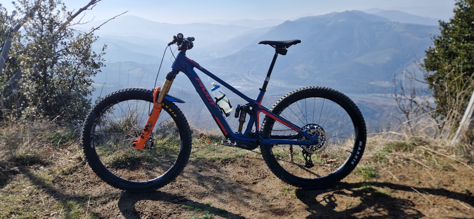

very short review after a first ride.
the pivot sl it's replace the Levo sl.
the shuttle sl it's more stiff, responsive, not really a plush on the downhill. maybe for the 132 mm at the rear.
yesterday the bike fork don't work well.
I set the sag but not the hydraulics and it was wrong. with the return too slow.
It stuck on the steps and stay too low when ride on descend.
the shock also needs to be calibrated well.
when i have the time i mount my fox factory 36 orange one. this is 160 instead of the original 150, not ebike version and perfect setting for me.
for my opinion 1 cm and 0.5° more open steering work well...
at the moment the changments from the original PROX01 version are the disci brake (from galfer original to Galfer shark), the stem form the 45 mm original sl to the 35 short Joystick Binary, the Fox Kashima seat post to AXS170 seat post, the specialized phenom Carbon seat and specialized bottlecage with swat
as soon as possible i'll mont my AXS transmission, my OneUp handlebar and other little thinsgs...
the engine compared to the specy is a bomb...pushing much more.
i used the default motor setting. with mtb trail, athletic person, 67 kg and 50 years old.
23 km - 800 mt dsl flow trail. winter morning -1 to 9 °C. condition from dry to muddy. i've use 5% off, 50% breeze, 40% river, 5% rocket, 1 time superboost. i finished with 52% of battery remaining.
the SL looks like a muscular bike with an engine that help you. from little to enough.
the fazua looks like an ebike whit a not so overly motorized.
i've ride with a friend smilar to me like weight. my friend with my old levo sl.
specy is more "enduro" in my opinion...
it has 150 from rear and is softer. more easier in downhill.
on enduro trail the pivot sl it's more phisical
see to next opinion. i hope form dry trails, where i can push more the bike...and with a better setting

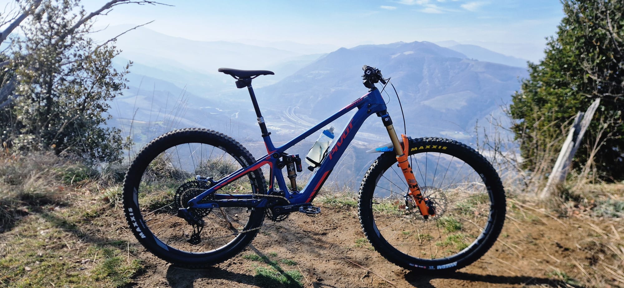

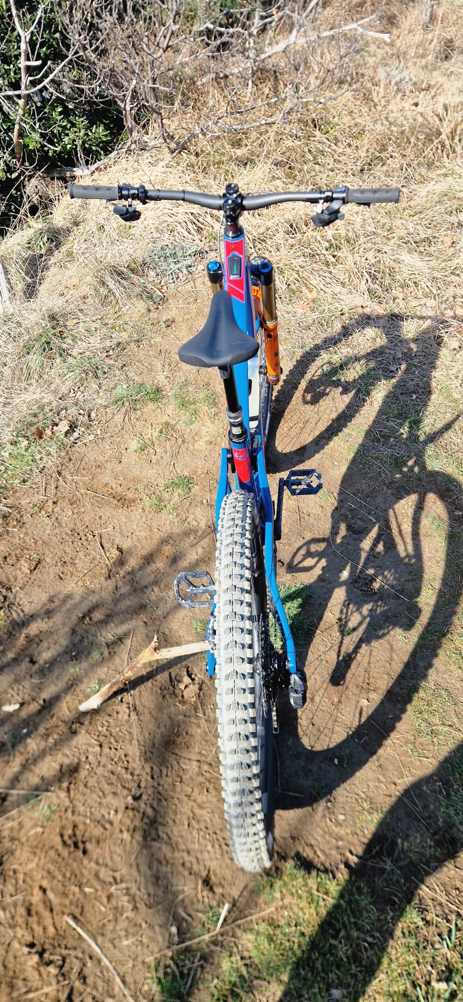

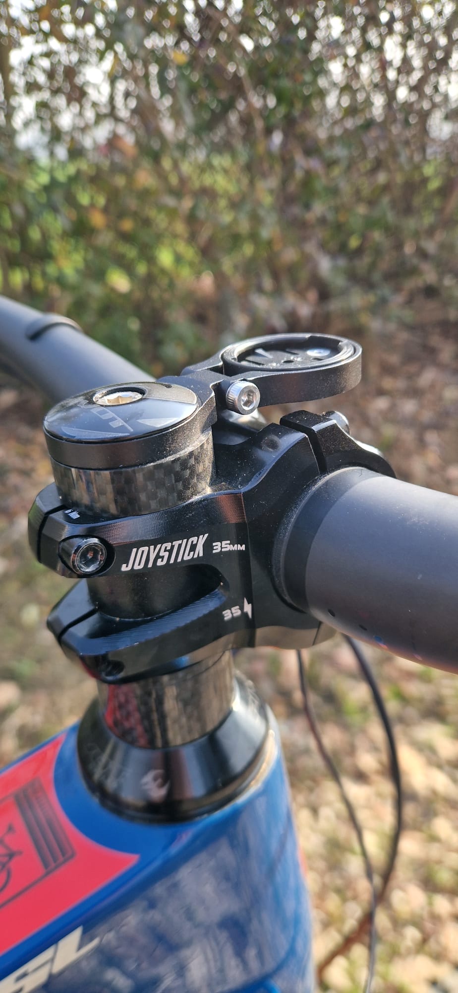

after maybe a month I'm doing a mini-review of my shuttle SL with the upgrades...
all the parts I had from the old LEVO SL1 bike and my another bike Yeti SB115 (not used now. it's for sell).
the updates:

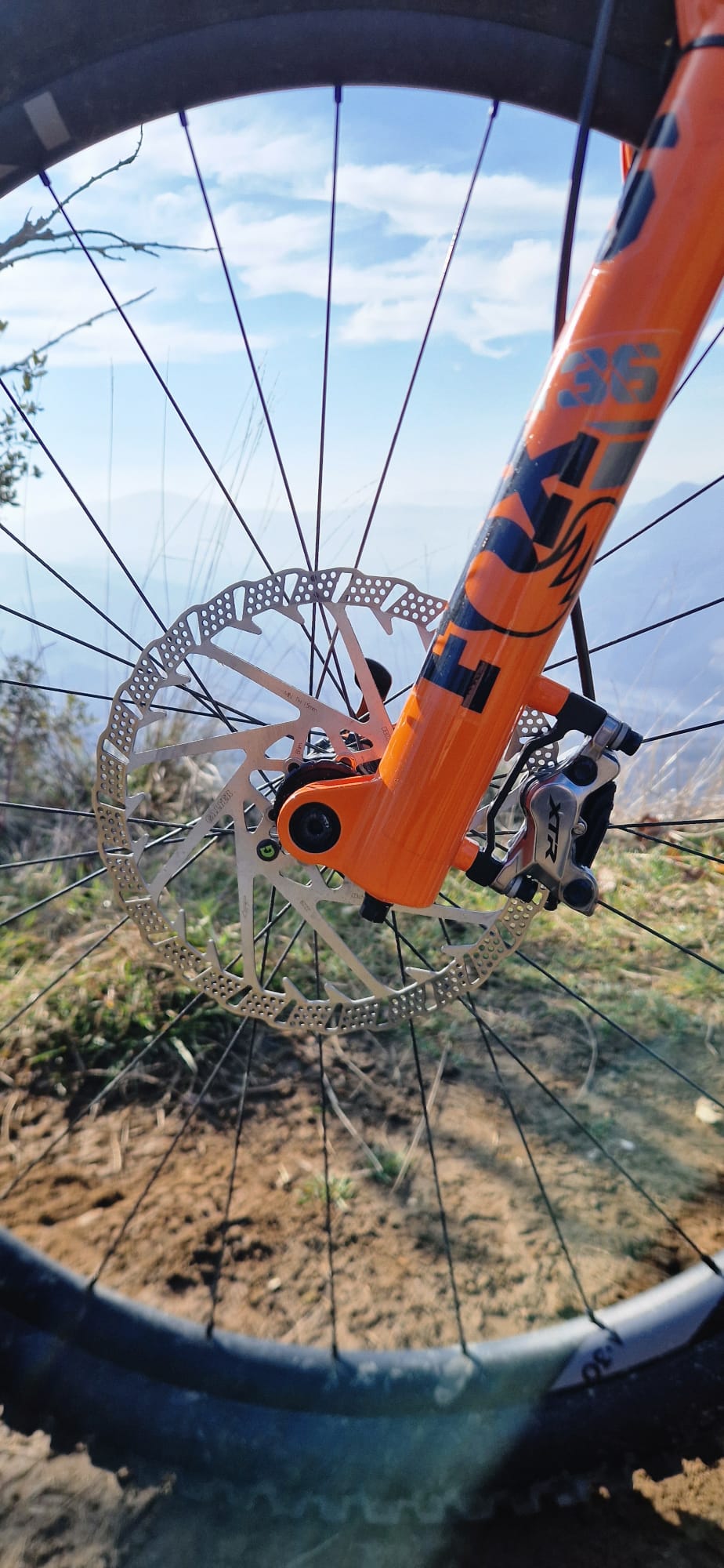

FOX 36 factory@160 fork
SRAM eagle GX AXS transmission
RS seatpost AXS @ 170

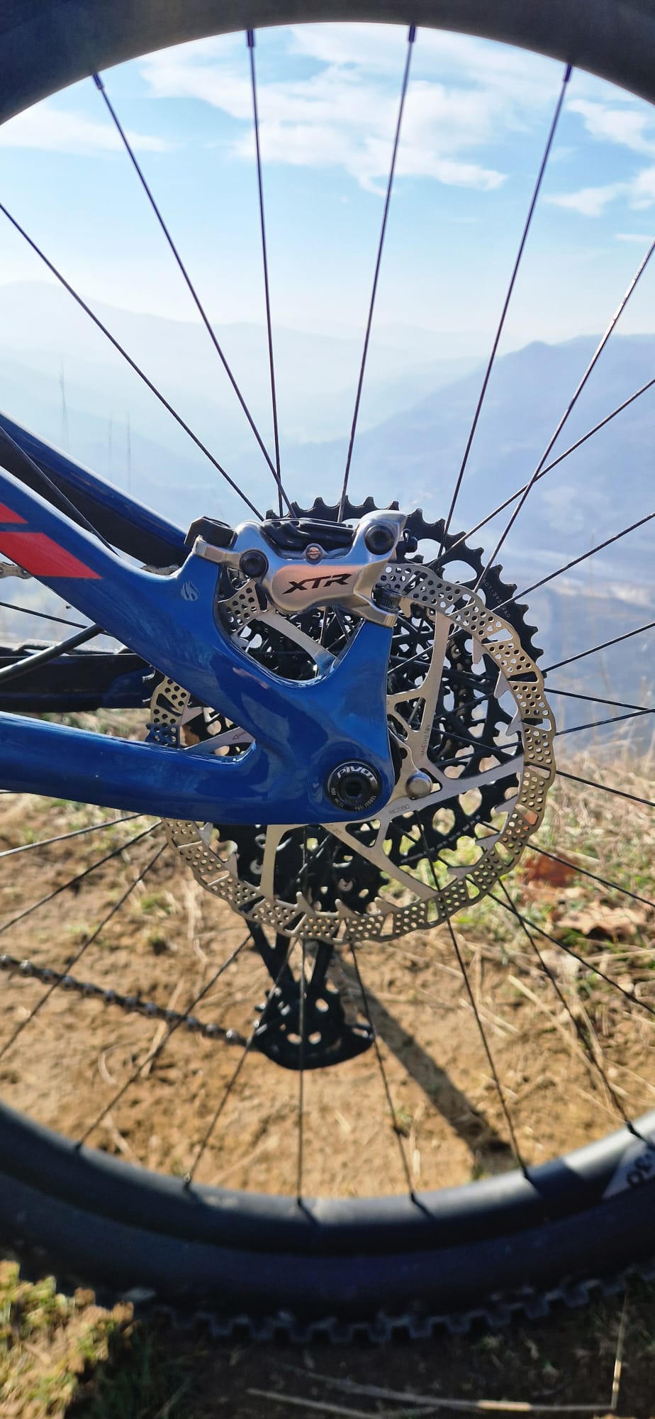

Shimano XTR brakes
Galfer shark 200 - 180 discs
Maxxis assegai 2.5 3C Exo plus
SDG titan saddle
joystick 35 mm short stem
ODI grips
I haven't weighed the bike but I think it's around 19kg
the bike goes wery well. the motor comparated to the old from SL1 it's another planet. the geometry are ok and with 160 fork the bike don't have problem on the steepes clim.
in downhill the bike it's very agile and playfull. not so plush on the rock garden, the rear it's not nervous, it's reactive. the rearend give not an enduro feeling. excellent wheels. I don't know the resistance to hard square but very smooth rocks
my trail was 24 km, 860 dsl and i finsh with 52% of battery.
i used the map at 50% breeze, 45% river and 5% rocket.
the fazua setting in default mode.
very happy from the bike. easy to ride, fast rolling, fast motor.
