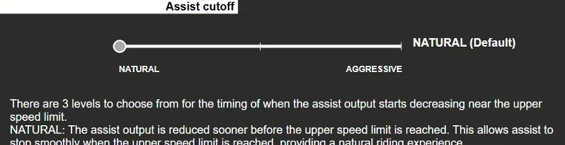

On the successor of the DU-EP800, the DU-EP801 this cutoff characteristic is selectable in 3 different modes (natural to aggressive):
But this is not the case on a DU-EP800.
