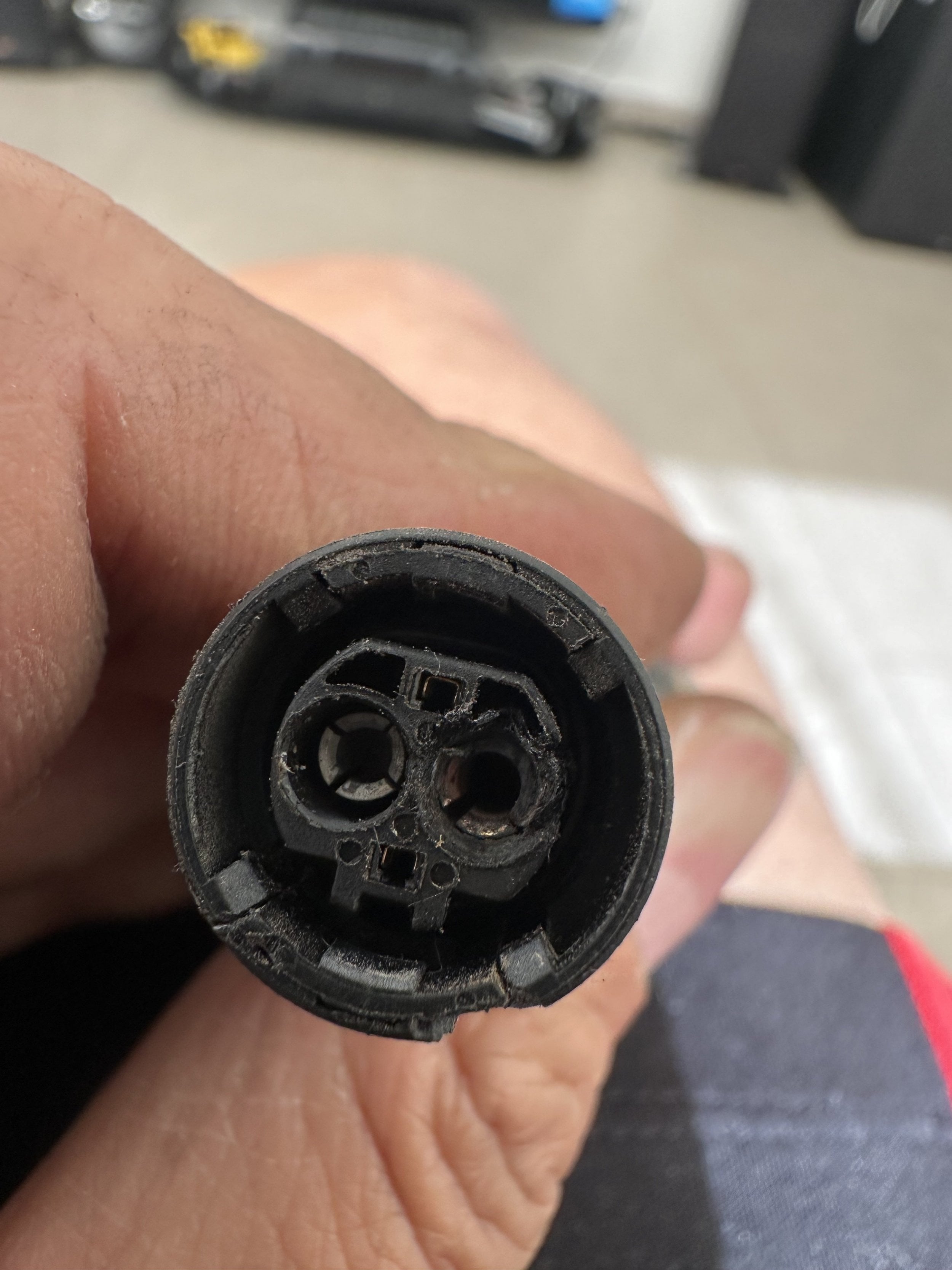

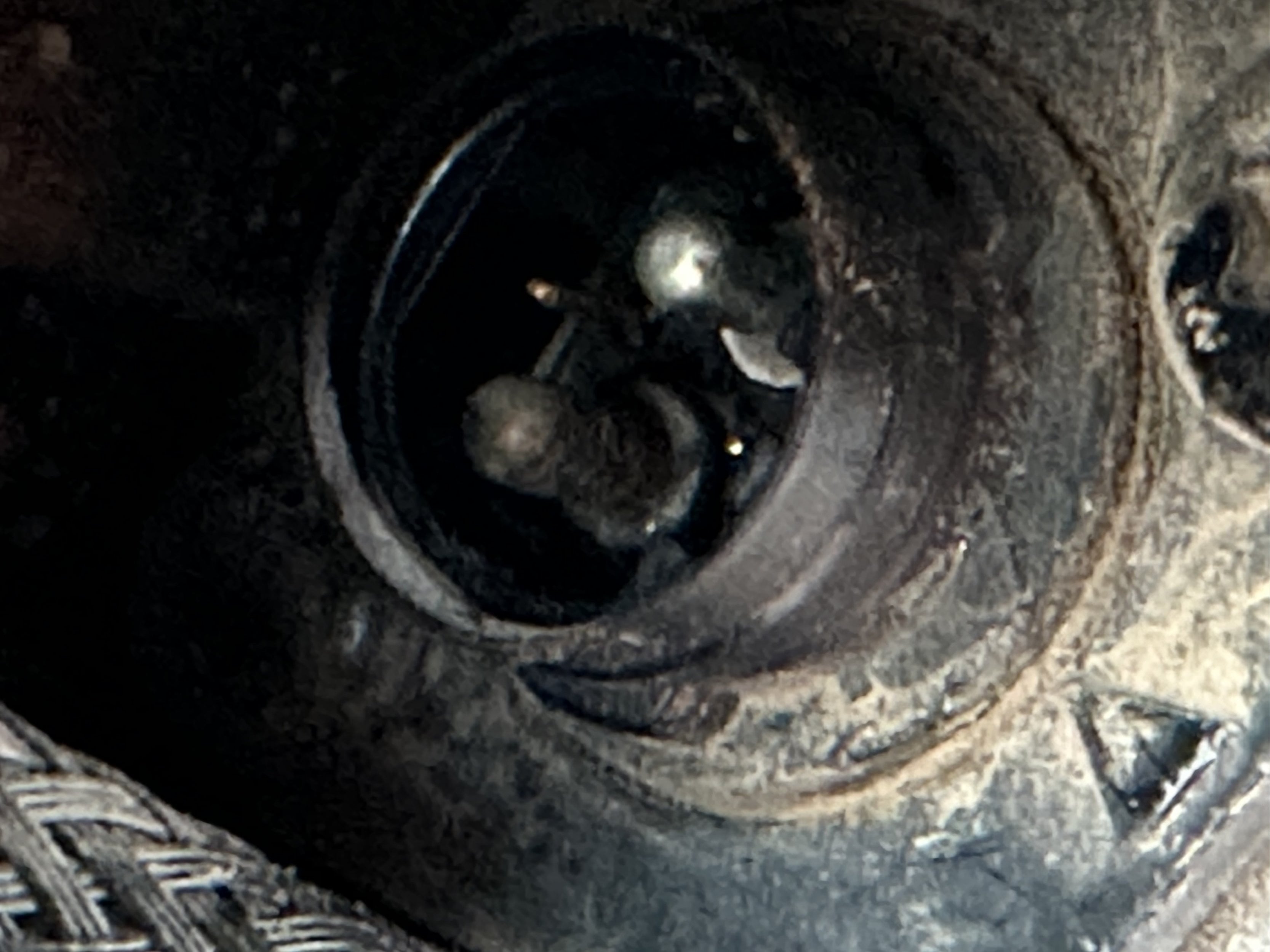

So, my problem has been resolved. Apparently the cable from the battery to the motor didn't connect very well. The connector at the motor became corroded and lost connectivity. Hopefully this helps someone fix an issues down the road.

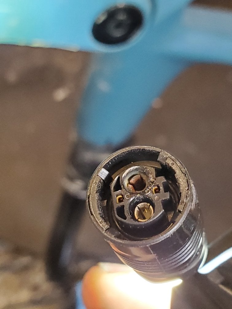

My bike died at 2,500 miles - about 1,000 miles after the first E020 error. In that time I had several E020 errors but the bike always restarted. The LBS with Shimano first analyzed it as the power cable which showed damage similar to FtOrdFanatic. Replacing the cable did not fully resolve the issue - mechanic said it would not work in Boost and next blamed battery. New battery did nothing but it was no longer possible to get any communication to the motor. Motor replacement resolved all issues. I believe that the damaged cable caused damage to the electronics inside the motor.
I have added dialectric grease to the cable to motor connection in an effort to keep out dust and moisture. I plan to clean and re-grease periodically and at the first instance of an E020 error.

Fortunately for me a new battery to motor cable resolved the issue. Shimano even covered the cost of the cable. My LBS mechanic stated that if failure were to occur again that Shimano would warranty the motor and power cable. I hope it doesn’t happen again and I have already done the dielectric grease. Thanks for your reply.

So, I haven't responded to this thread in some time. But with mine there was a connection issue and one of the prongs on the motor was shorter than the other. Which was causing connection issues. But the oxidation. On the cable tells me there was more at play. Seems the cord doesn't "click" in so it comes loose. Luckily I went to a shimano authorized shop and was given a replacement motor. Canyon wouldn't pay for the repair but Shimano stepped up. Good luck!
