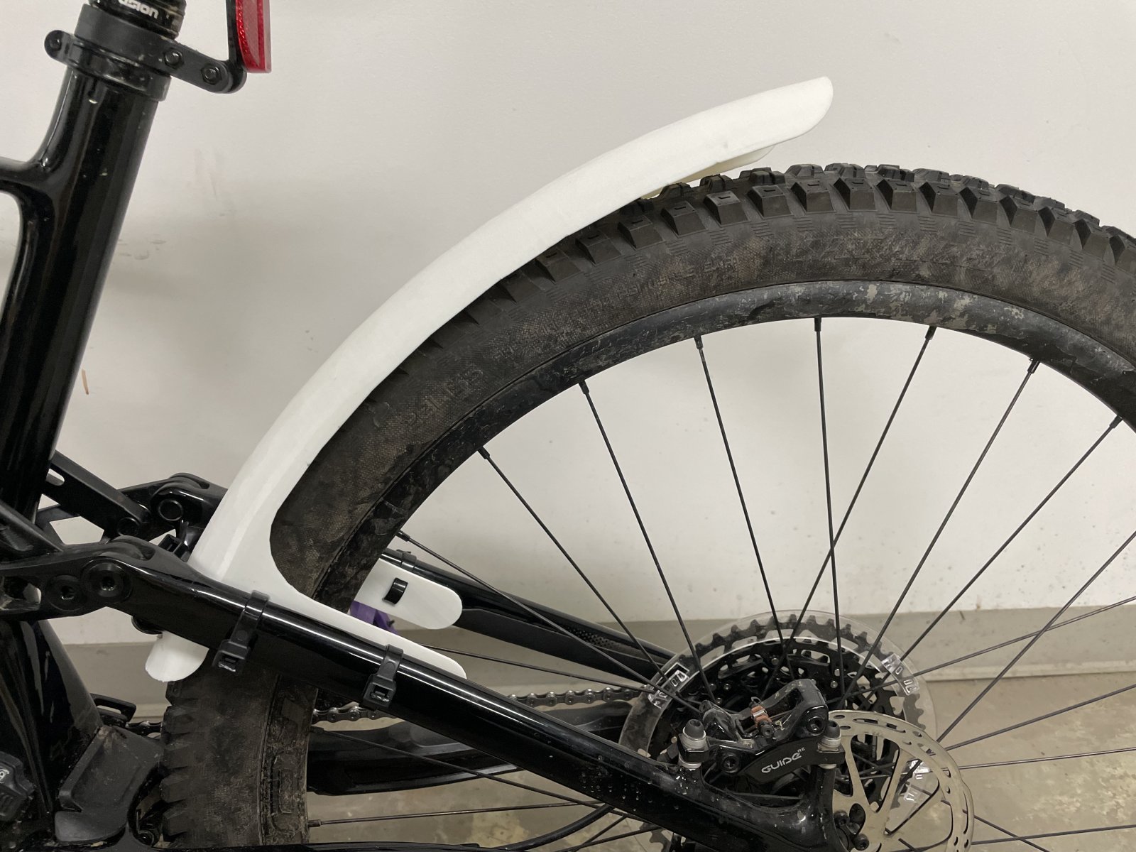

Rear fender for the SL

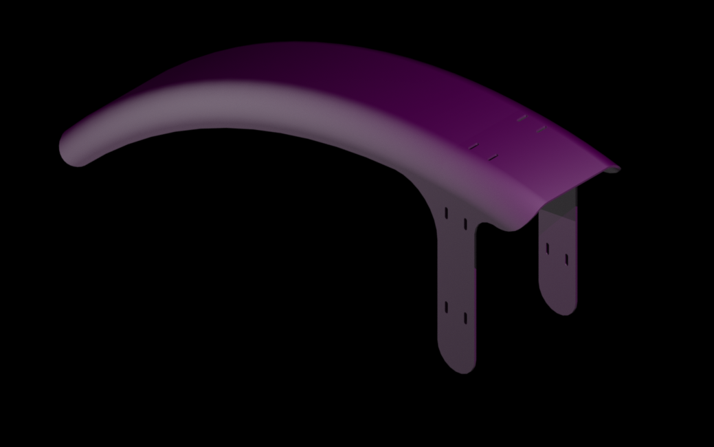

I haven’t found any rear fenders I like for my Levo SL so I decided to make one. Below is prototype 1 and what the rough print looks like on the bike. Final version will be color coordinated, but for now I’m just using scrap printer filament around the shop. Any recommendations?
Interesting. Does it need to be that big? What type of plastic is it made out of?

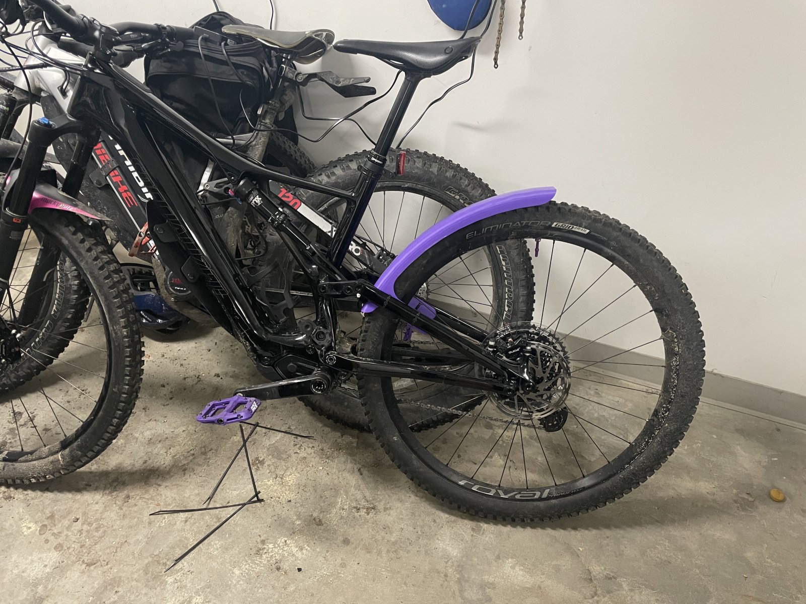

Version 1 was PLA. I eventually re-printed it in purple ABS whIch proved too brittle.
It didn’t actually do a good job of preventing a muddy back so to make it effective I’d probably have to make it longer.
Looks like a nice print! Did you use supports? I would have thought PLA would have been too brittle as well. I personally would prefer not having a fender on the back tho as it looks like it could get jammed up with mud and pine needles where I ride.
