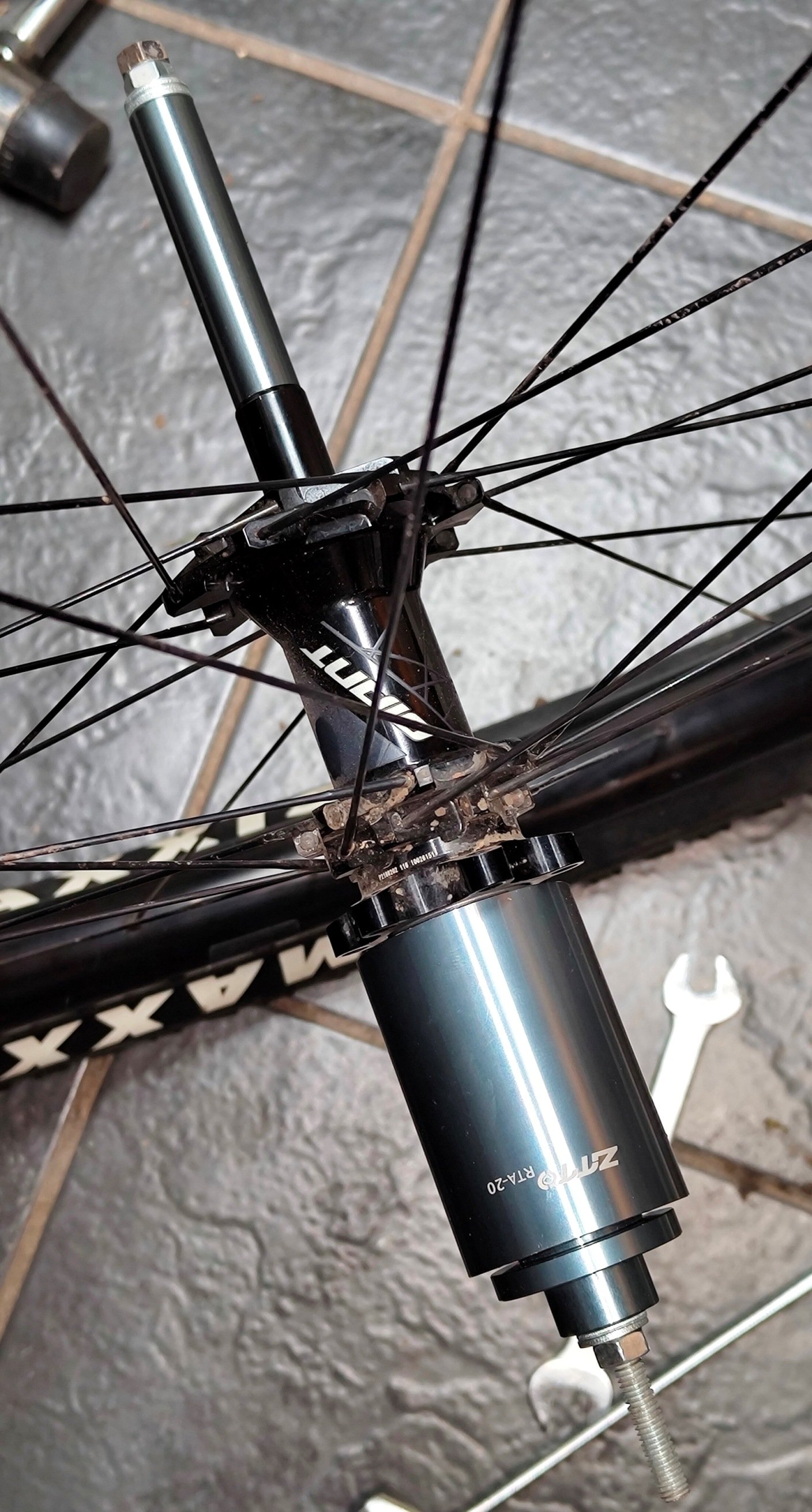

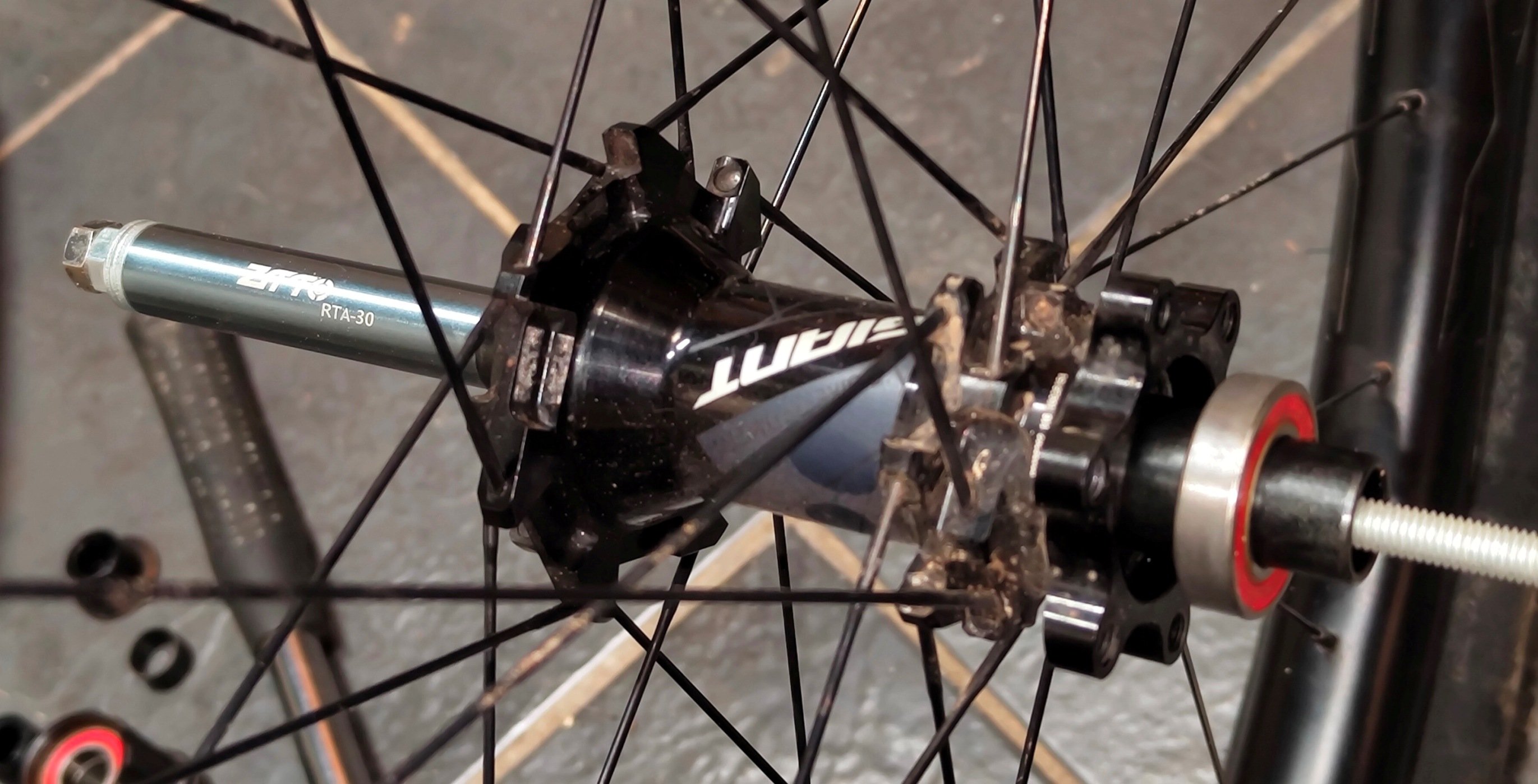

I ordered a bearing extractor & press kit just yesterday so will be sorting it sometime in the near future, I will take some pics and upload here when I do. I think it's a 370 hub, but I'm still not 100% sure. If it is there's this video on YouTube which may help: DT Swiss H1900 Rear Hub Rebuild

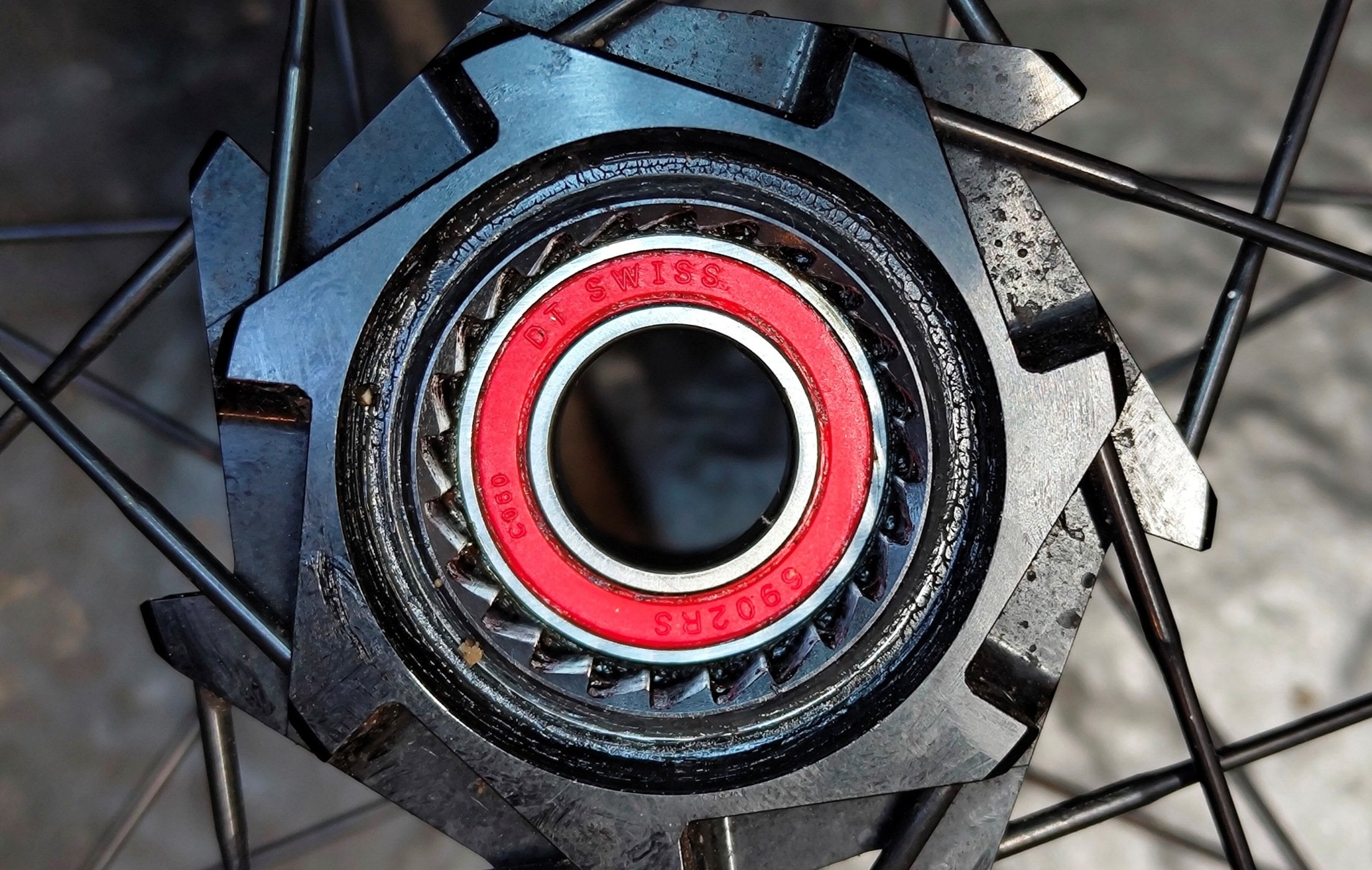

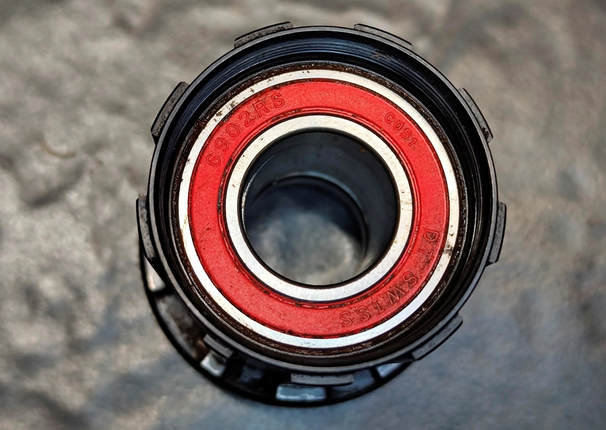

I changed four bearings total, two in the hub & two in the freehub. The main hub & outside freehub bearings are 6902 and the inside freehub bearing is a 6802 with this HG freehub body.
My freehub is a standard pawl (not ratchet) type and the bearing does not fit through, I believe the bearing does fit through a ring for a ratchet drive.
The bearings do come out as per the video I linked to in post #3 & as others have said however the non-driveside bearing in my hub was extremely tight & no way would it knock out without damaging the axle. Had to use a press instead. YMMV. Anyway, hope this helps someone!
