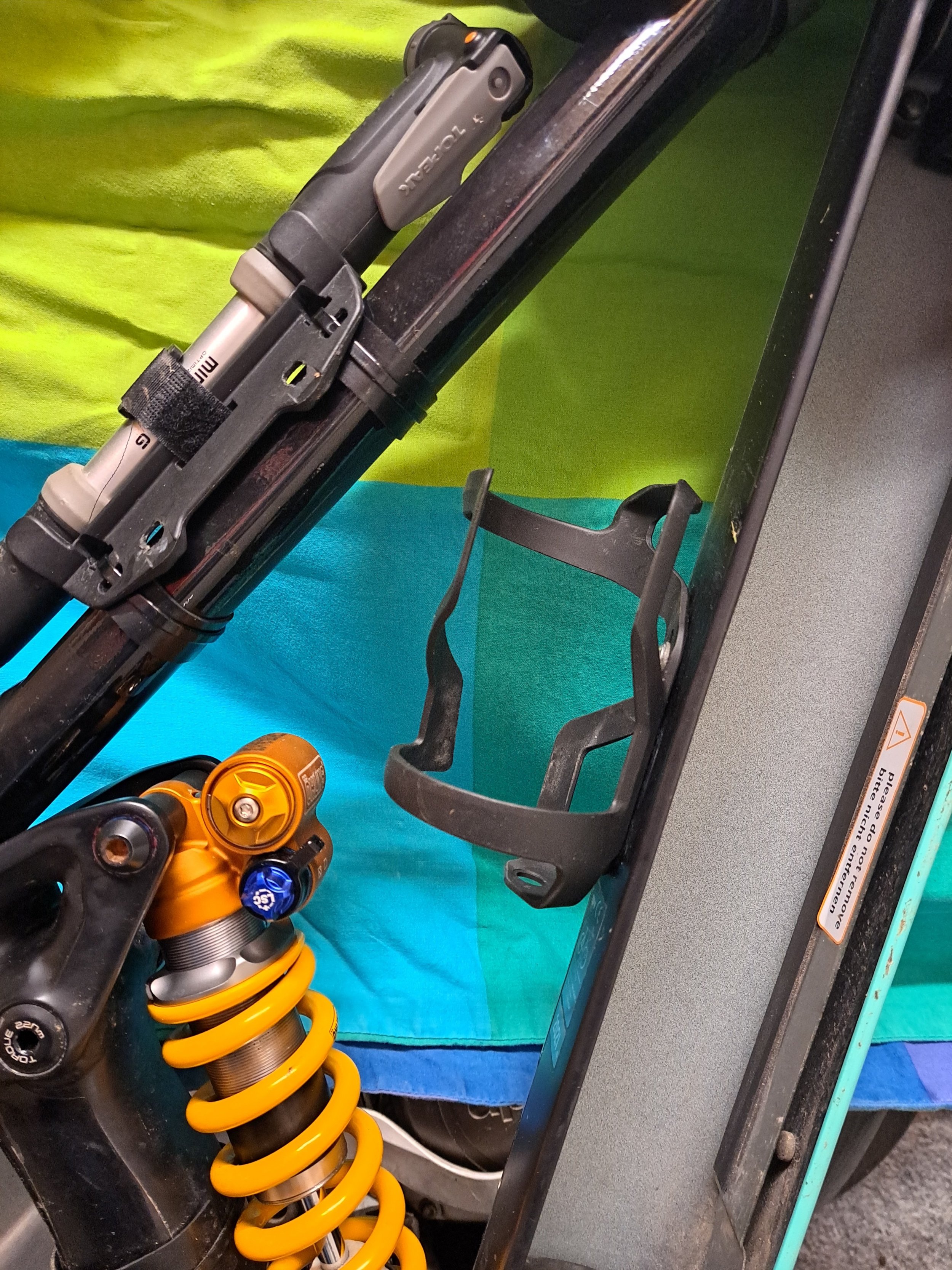

After fitting an Ohlins TTX22m.2 shock I had the same problem but the other way around, the bottle holder needed to be higher in the frame and closer to the down tube to hold even a 600ml bottle.
So I bought a Specialized Zee Cage II then drilled out 11mm holes so that the holder would fit. Then fitted the holes in the cage over the frame fixing points, then used a couple of short low profile bolts with washers. The Ohlins coil shock just clears the bottle when on full compression.
