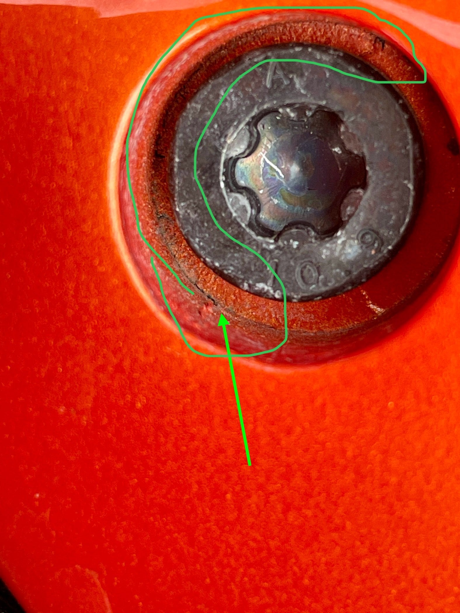

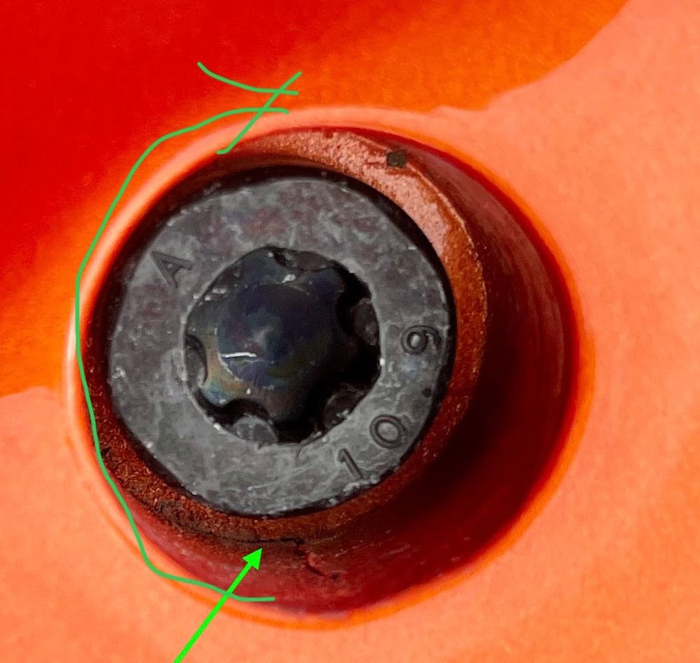

You can see the insert has distorted and the paint around it has cracked, but hopefully this one is still firmly bonded to the carbon.
The rear ones look OK.

Looks fine to me. A little bit of surface cracking around a discontinuity like that in a very thick carbon section is not uncommon or concerning.
I'm curious to see a pic of the insert but I'm guessing it's basically a thick stepped stainless steel washer shaped like this:
If so, it's basically a non-structural spacer glued in there to fit your motor width and provide a hard surface for the bolts to pass vertical loads into the end-grain fibers in the carbon holes. Over-torquing will cause the inserts to spin and break their glue joints, allowing some tiny rattle that will gradually worsen until needing the repair you have done. In the future you should use the motor to position the insert rather than clamping it to the frame so that the bolt doesn't end up stressing anything into position when tightened.
Cheers Gauss.
They are soft aluminium. I think the screw heads sit onto carbon and the thread through the insert. I think I have crushed and lost some of that carbon on 4 mounts. The insert doesn’t spin it distorts. I clamped it into position to ensure a good a bond. Consensus seems to suggest 11Nm with thread lock as the correct torque figure.
I’d really need to see a brand new frame to fully understand the extent of the damage that I’ve now got.
I definitely have some damage but I hope you are right that it will still be fine in use – fingers crossed.
I don't think there was any carbon there. It would be difficult to mold with that complexity, the sharp details would be weak, and it's not good practice to allow bolt heads to contact carbon. Plus, it would require a very large carbon feature to be reasonably structural so the path of destruction would be apparent.
It looks to me like this is solid carbon that was drilled after curing:
Then this metal insert was glued into the hole, not intended to take significant side/side forces - only vertical forces from pedaling/landing. The side/side forces are small and managed simply by the fact that the frame surrounds the motor. The chipped edges are just the glue line, covered in paint.
Your screws came loose at some point and mangled the insert. That's not from overtorquing.

The first image you have referred to, there is a good wee bit of carbon missing – that hole has a smaller diameter to the inside of the frame, and a larger diameter to the outside of the frame. But it does seem that the main bond for the insert is on the inside of the frame. Which is why I’m hoping things will be OK. It is just a worry that the insert became dislodged.
My screws have never come loose. All the damage is from over torquing. Look at the first insert photo. That insert should have a flat face – the force of the over torque has distorted it.
We think the correct figure is 11Nm. The bike shop told me 40Nm. I should have known better. So, I started torquing them up bit by bit. I got to 30Nm on several screws, and well you know when things just don’t feel right. I knew at that point I’d done damage. I backed it off a bit and left it. 180 miles later when the motor failed and took it out – well you can see what I found.
But yeah hopefully you are correct about the moulding and that the screw contacts only with the insert and does not sit on carbon.
Anyway – I’ll just keep riding and see what happens. Fingers crossed.
Ah, I see what you mean about the carbon hole diameter - there is a step change to a smaller diameter in the insert region. I suspect they molded the large outer diameter so that it would look nice when painted, and it might even be hollow or foam-core in that region to save weight. But the smaller diameter should be solid carbon and either drilled or reamed to rough it up for bonding to the insert. Usually drilling is better, counterintuive as it may be.
And I see the mushroom distortion of the inserts, yes definitely from overtorquing. But one insert has an elongated bolt hole which suggests it was stressed by a loose bolt moving around within the insert.
Nope no loose screw. The inserts had crushed into the threads with the force, I had to file them out so the thread clears rather than threads through which would be incorrect. The inserts have been squashed and spread. There will be a clearance tolerance to allow for motor bracket/frame hole position I would assume, plus naturally thread high and low, so that’s just a little bit directional spread from the over torque on the soft aluminium.

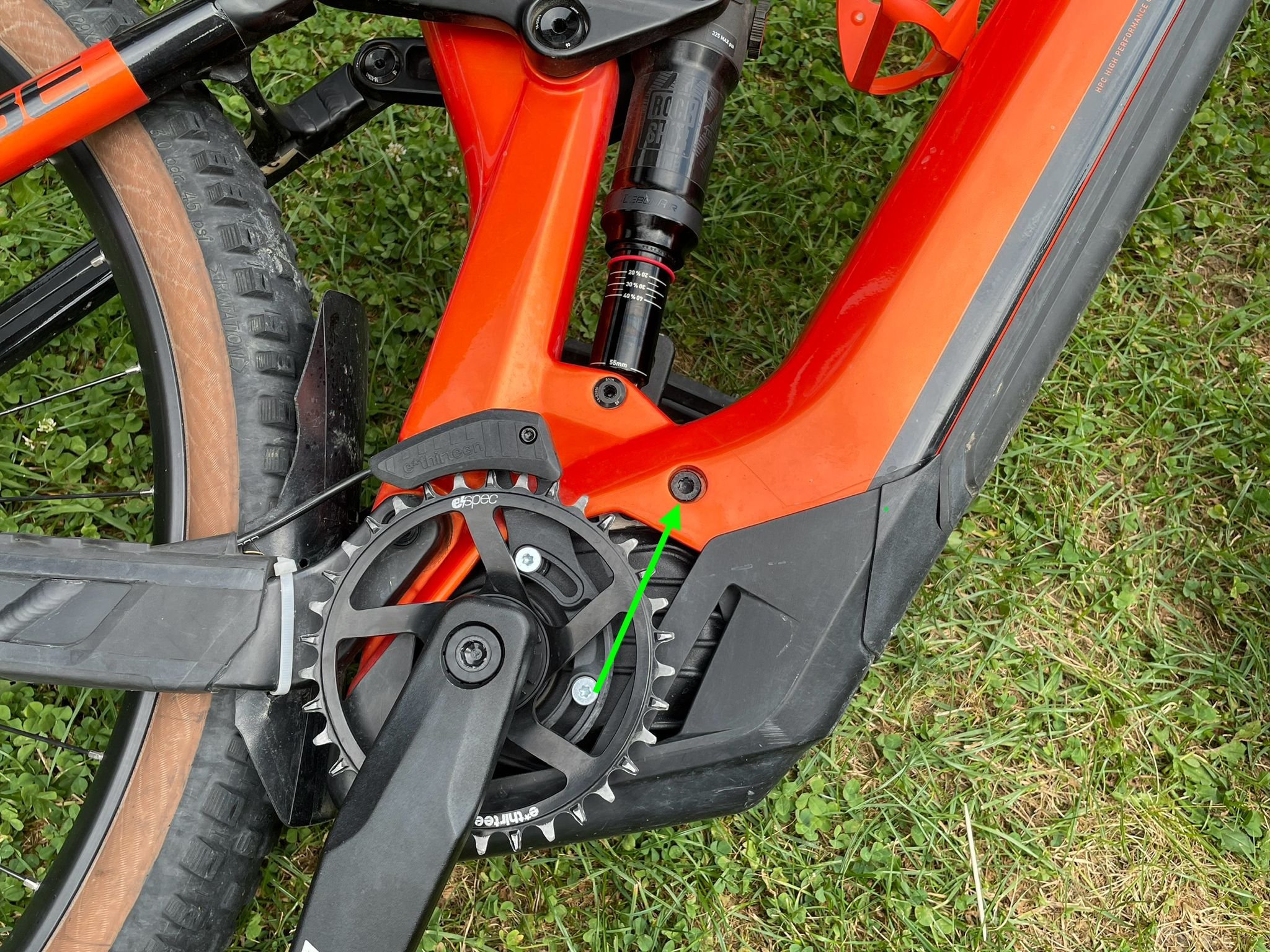

My concern is for the bolts here highlighted in green, as there is very little material around the bolt hole.
(I've borrowed @Gareth picture from above)
Next time I pull my motor out, I may torque that pair to the 11Nm I've previously used but the others tighten to the 20Nm as now confirmed by Cube.

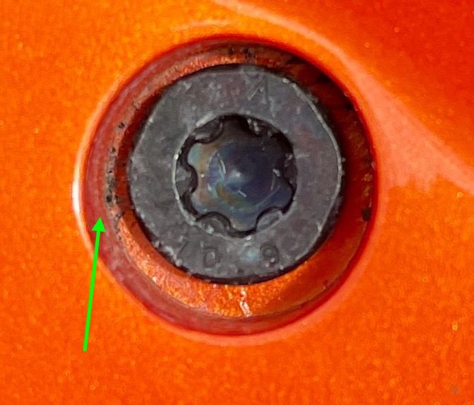

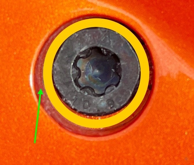

Hello guys, hello @Gareth
I found your post looking after cracks in carbon Cube frames.
I observing this small crack, near the motor bolt at my Cube Stereo Hybrid 140 HPC ebike.
After reading your posts and viewing your pictures, I now think this is just space between the metal insert and the carbon frame.
I thried to scrath the paint... and the crack is not only in the paint... I can get a needle tip a little in there, like 1/4 of a mm.
Please help me with your opinion? Do I have anything to worry about?
A picture of the insert asambly whould help me better understand how this insert is mounted in the frame hole... and if this is afterall space between the insert and the carbon frame..
Thank you very much! :)
WhatsApp Image 2024-08-18 at 21.05.42_ce9002ec.jpg WhatsApp Image 2024-08-18 at 21.05.43_0fbd4c93.jpg WhatsApp Image 2024-08-18 at 21.05.43_f35926af.jpg WhatsApp Image 2024-08-18 at 21.33.50_8c55cde6.jpg
I can't tell much from your photos.
The inserts are aluminium and are glued into position.

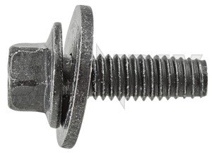

What I was trying to figure out is, if there is a washer on the outsite ?
Does the assembly consits in a bolt+washer(outside) + insert(inside) ?
If yes, I have just a a paint crack between the washer and the frame.
Mine has screws not bolts. The screws go through the insert and screw into the Bosch motor bracket which is in turn screwed to the motor itself. There are no washers.
