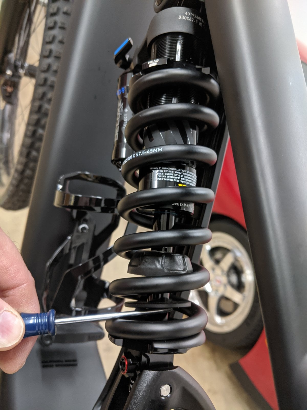

I recently purchased a 2020 Kenevo Comp in a size S4. Unfortunately, I guess the bike is designed for someone much heavier than 160 lbs., so I’m only able to get around 10% sag. I ordered a 450 lb. spring, but it looks like it’ll take around a week or more to arrive.
My trail bike is a 2018 Santa Cruz and it has a rockshox coil shock 230mm x 60mm. It looks like it may fit, but the hardware is obviously different.
I tried to look up the shock mounting hardware, but it looks like it’s all secret squirrel spoof information.
Do any of the current existing Kenevo Expert owners have the Rockshox Coil Shock mounting hardware sizes?
Thank you.

Top is:
Rock Shox Metric Rear Shock Mount Kits
M8 x 20mm
No hardware required for the bottom (standard mount), but I had to knock out the bushing in the shock.
You will lose travel with the 230x60. I would guess travel reduced to 172mm

You sir, are a godsend! Thank you!
Just out of curiosity, if I were to remove the space on the 230x60 shock to make it a 230x65, what would the extra 2.5mm do to the bike?

The expert comes with a 230x62.5 Rockshox.super deluxe coil with a spacer washer under the bottom out bumper on the shock shaft. I removed the spacer with no Ill effect and now have around 188 mm of travel. Your experience May differ

Thanks again for the info.
Just realized that the coil shock won’t fit because of the eyelet bearing on the rebound knob side
