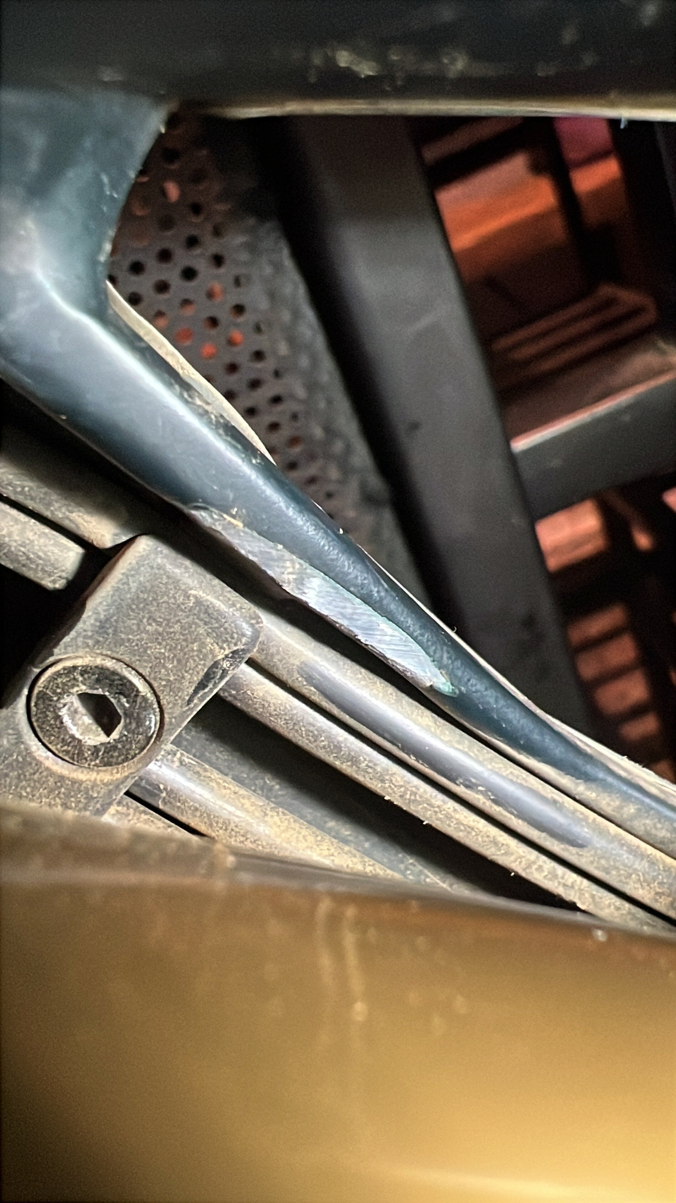

i've mounted a Fox X2 on my Kenevo 2020 and it touches slightly the frame. I don't know why this is happening, it seems the frame are not all equal because i've two friends who have the same setup: Kenevo S3 size + X2 2020 and they don't have any issues.
The shock is 230x65, and i've bought a reducer to transform it to 230x62.5, hope this will solve this issue.
As you can see in both images, there're two point where it interferes. My concern where the frame touch the shock cage, it is less than a milimeter. (The other point is the bolt that supports all cables but it wasn't so tighten so it is solved).
Hi, some people do experience this. In some cases it’s so marginal a slight file on the frame will sort it out
Is it possible to insert 1 mm spacer to the top mount? So that the shock move a little bit away from the frame

Only the X2. A few Kenevos touches slightly the frame so be aware in case you have the same issue i had. I solved it with a 1mm or less spacer.
If you use the 230x65 it will transform the rear suspension to aprox. 187 mm instead of 180mm that is why i put a 2.5mm reducer. I recommed using the flipchip in low position and use the reducer to maintain the original bike geometry.
I have 2 friend who uses 230x65 and they love that setup.

There is no point in add a spacer. Just setup the shock to only use 62.5 mm of travel and in an extreme case you now have a buffer instead of bottoming out and shock loading the frame and linkages.

Where did you fit the 1mm spacer? I cant see how it would fit between the frame and shock bushing.
Hello everyone! Doubt this thread recently! My kenevo is completely scratched with the shock!
What should I do?
