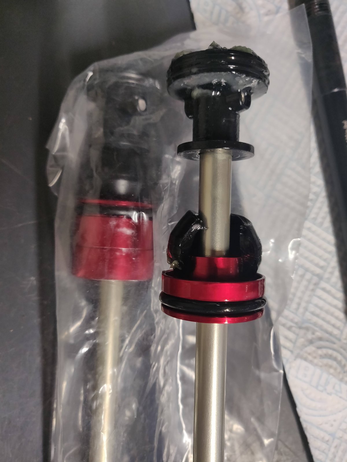

Just stripped my fork to fit the upgraded air shaft, I also chose 160mm but I've not gone for new seals as only covered 500km's, regretting not ordering them now as foam rings were dry, very little grease on the seals and the top out bumper is split, good job its not going back in -

The standard Charger RC in these Lyriks is a cartridge style damper same as the RC2 and RCT3. I took it out to have a look when I replaced the air shaft.
