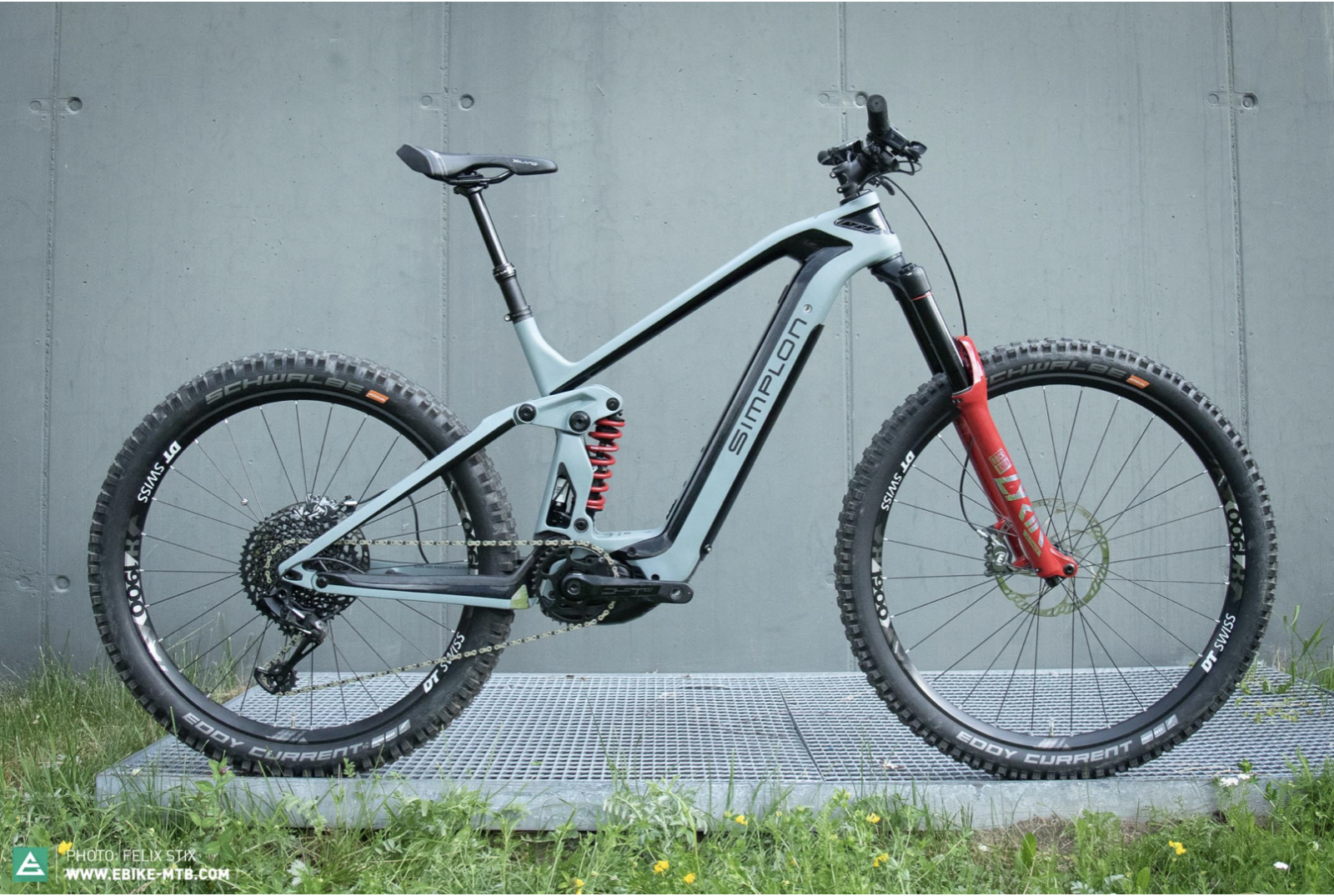

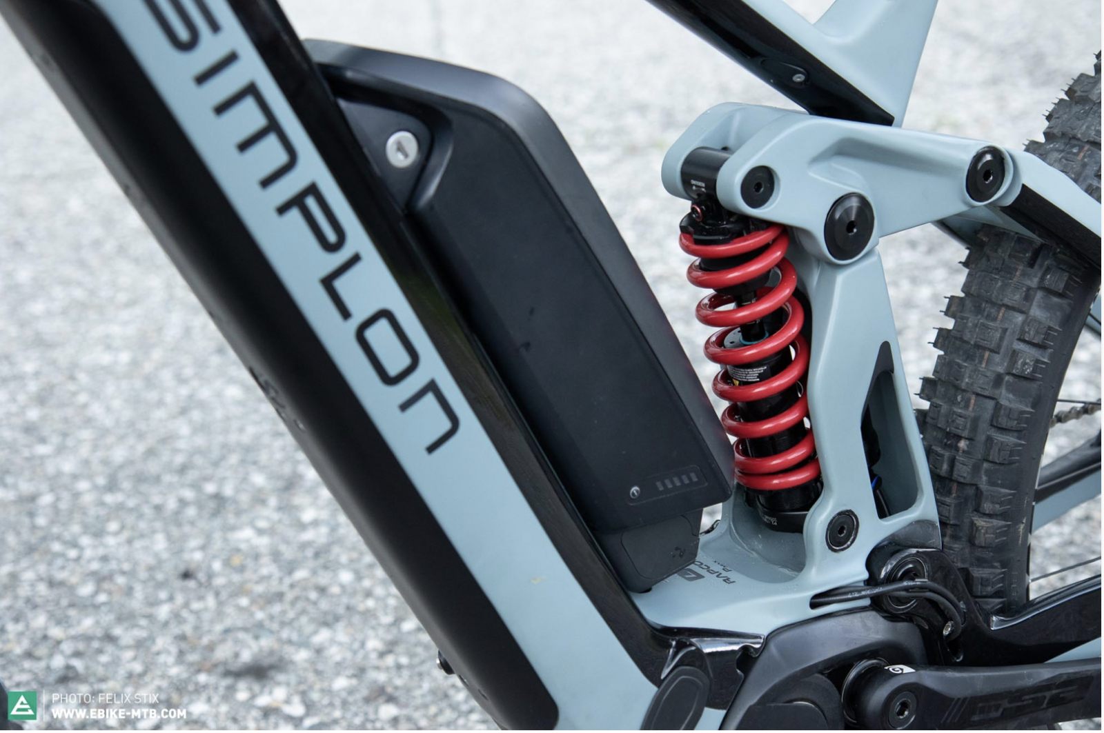

Now this really is interesting - new Simplon has the ability to use the existing external battery as a booster pack - wondering if this is a feature available on all new Bosch bikes?
Simplon Rapcon Pmax: Versatile performance eMTB announced | E-MOUNTAINBIKE Magazine
