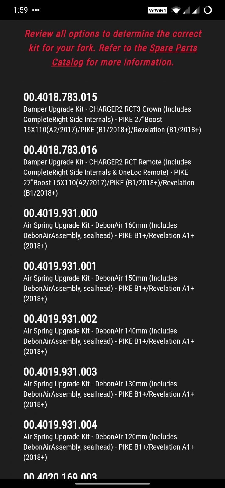

Or if you install the RS TrailHead app on your phone and put the serial number of your fork in, it will tell you what upgrades are available...

Well, that looks quicker! But it still refers you to the spare parts catalogue.
When I was trying to buy a Charger 2.1 for my Revelation, the sellers I looked at appeared to have the wrong descriptions, which was very off-putting. None of the options looked correct. I only knew this because I had consulted the spare parts catalogue. I rang the TF Tuned website (the only English supplier of the ones I saw) and had a long conversation. Eventually they agreed that the description was wrong and confusing and changed it. But by then they had sold the last one!! So I had to buy from a German website, but by this time I could see past the confusion. Ignore the description, buy the code number.
