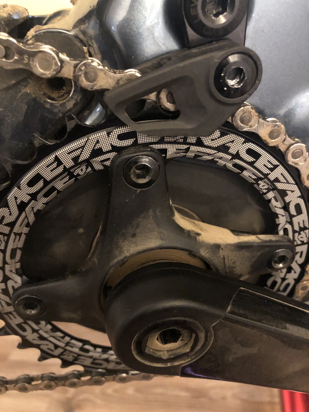

Just switched the 32t ring with a 36t and
Had to dremel and file chainguide to get it
To work. Anyone else with similar problem? Thanks
Thought I would add a few pictures.
With a NW 36t (lots of wrap) and a clutch mech then I'd just lose the guide.
I'd also buy a better quality/fitting allen key! ;)
No problems running the same chainring in 34t on my Haibike SDURO without the guide; the SRAM NX derailleur on that bike provides a lot of chain tension, though.
