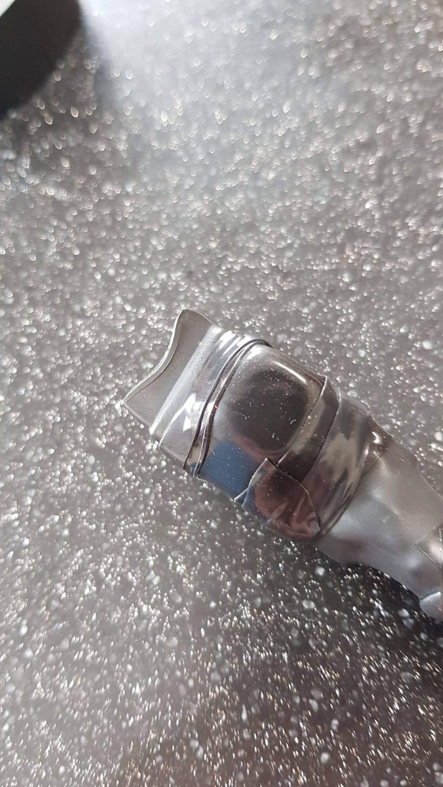

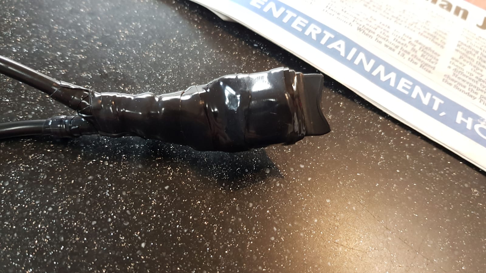

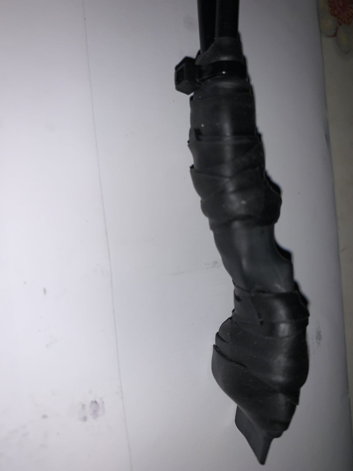

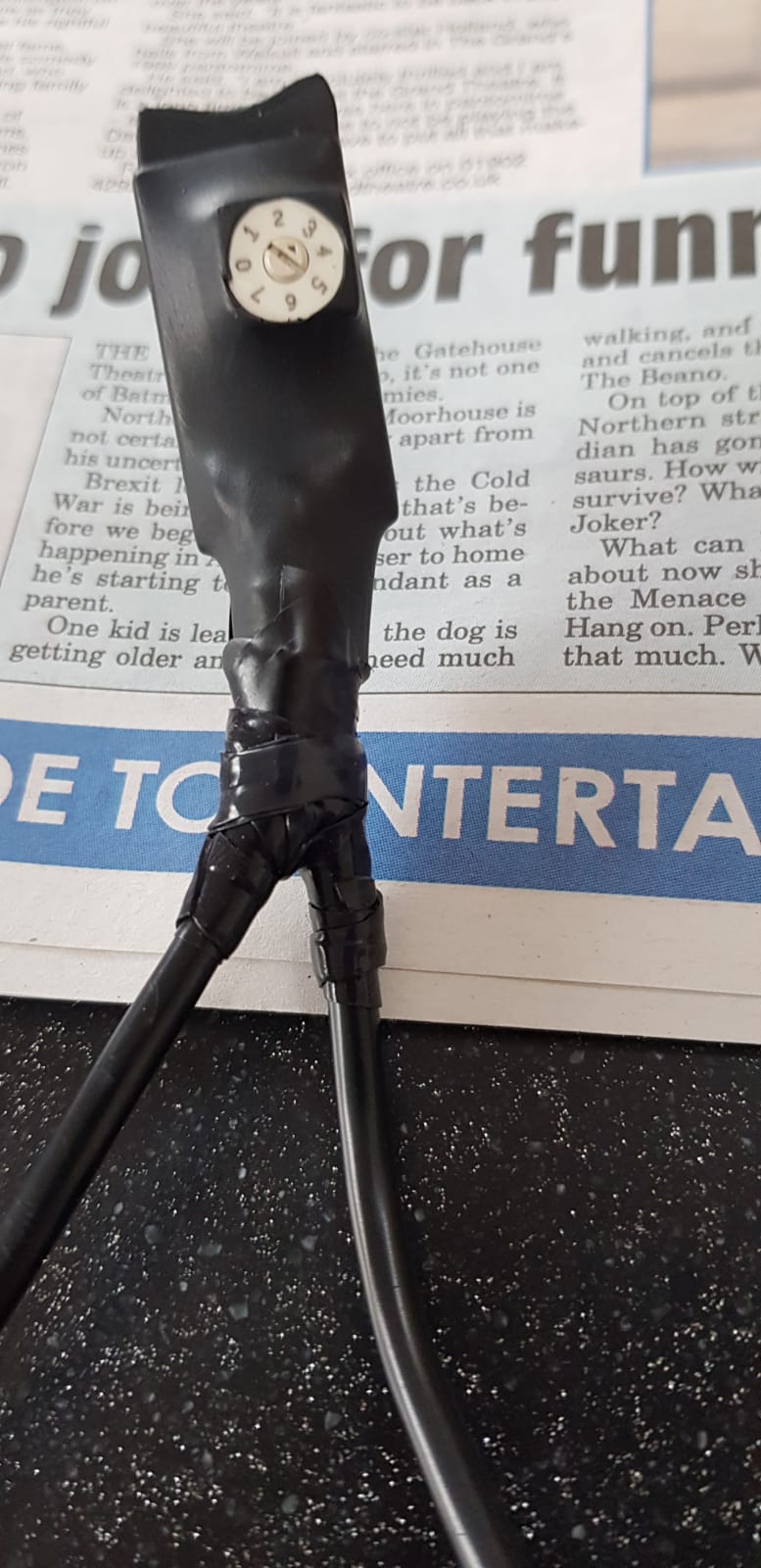

I had an issue with my Velociprator with the same faults as discussed here due to water ingress. Trail watts sorted a new unit out quickly. I have wrapped the new one in self amalgamating tape as has my friend who also has one and waterproofed the connectors with silicone grease along with the TCU and have had no further problems.
More images of my friends raptor wrapped in self amalgamating tape.
I’ve removed the TCU and raptor since taping it up and there has been moisture on the unit after riding. It’s been incredibly wet in the UK so the bike has required washing virtually every ride too. Even being very careful some water will inevitably enter the top tube through riding and washing but the tape and grease on the connectors seems to be doing a good job of protecting things.
What does the pot do?
