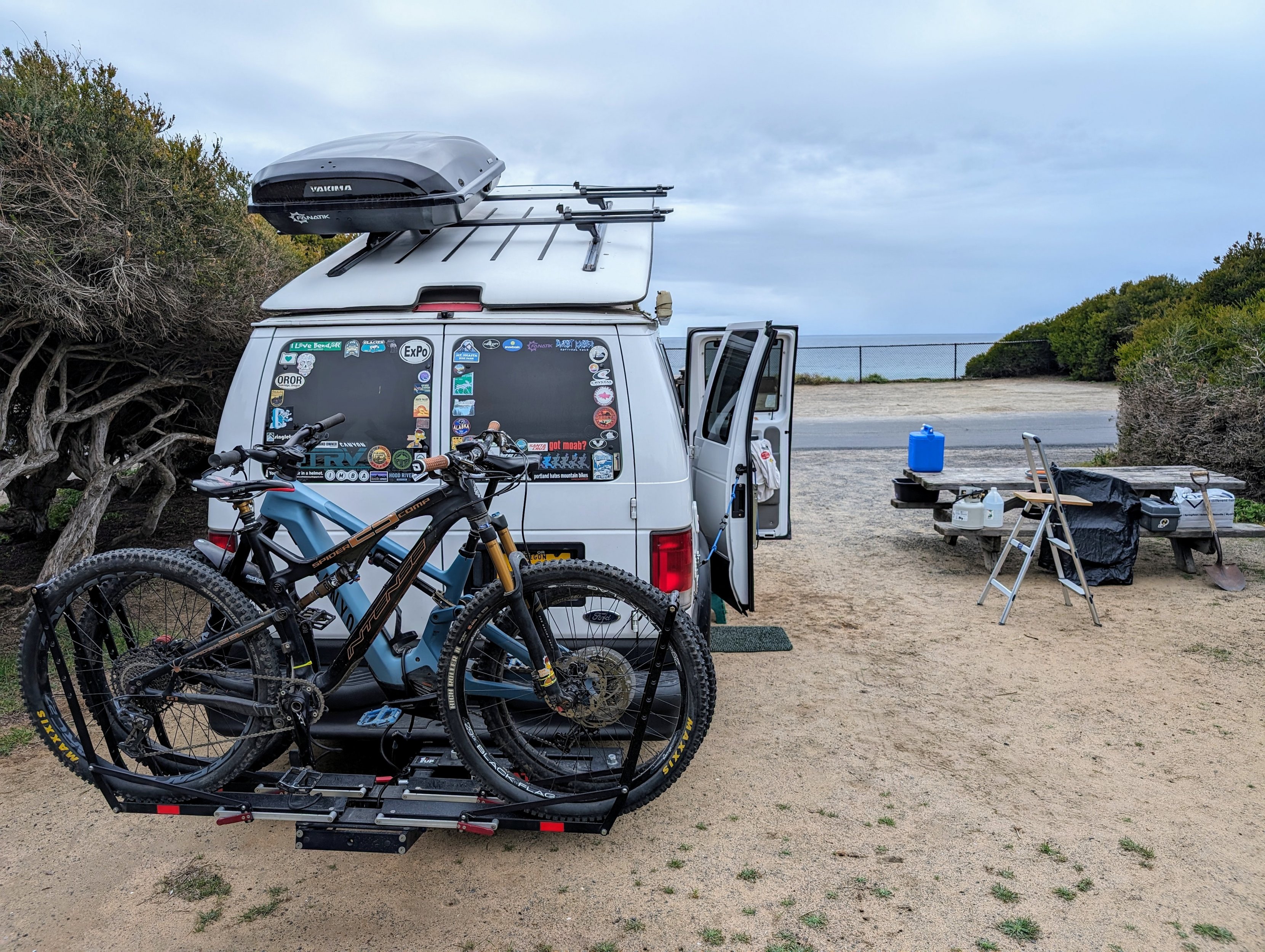

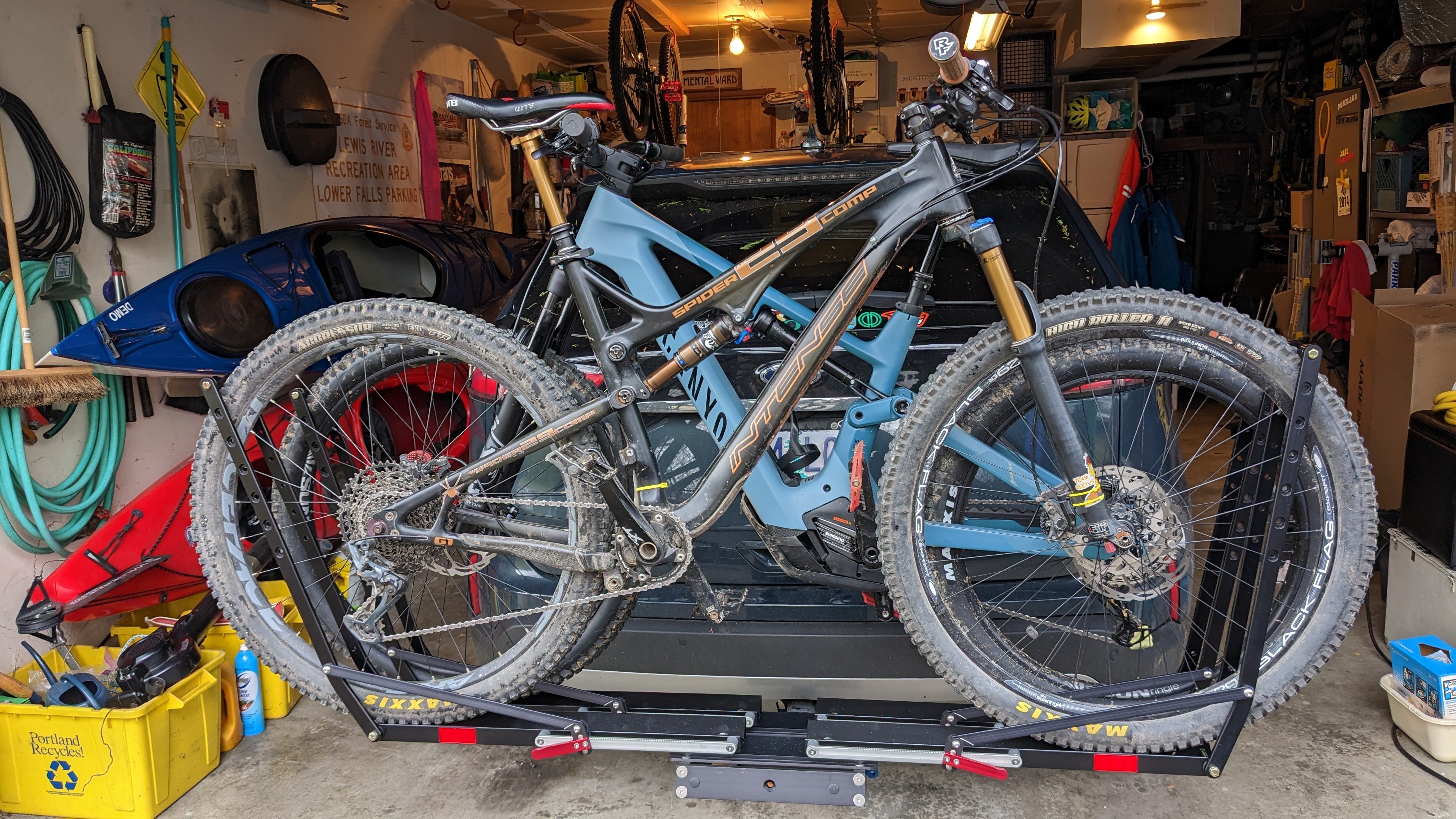

I now have the 1UP 2" Super Duty Double rack often used with the 1Up RakAttach 2.0. I purchased both in December 2022 after buying my first EMTB, a Canyon Spectral:On CF8. I've been very happy with the rack overall and have hauled my Canyon and my buddy's Marin on multiple occasions. The rack is beefy and more than capable of handling two EMTBs. I typically haul the Canyon and my Intense analog bike with the "RakAttach 2.0" on my camper van when traveling. The RakAttach swing away feature is of primary importance so that I can easily access the rear doors of my van as needed. If I'm heading out riding for a day trip, I use the 1Up Super Duty rack without the RakAttach on my Ford Edge.
My observations are that the rack alone is very secure with zero wobble, but when using the RakAttach, the connection between the RakAttach and the van's hitch receiver *always* loosens up! I'm now in the habit of checking it frequently and I plan to buy a hitch tightener (see post above) very soon.
Hauling two bikes is easy, but I always need to lower the saddle of one or both bikes to make them fit. As the original poster observed, it can be slightly tricky to balance a bike while loading, especially a heavy e-bike, but it is easy to ratchet up one of the retaining brackets slightly in order to balance the bike until both brackets are engaged and tightly holding the bikes.
Other minor issues. These products are HEAVY! The RakAttach in particular is difficult to load because of the weight. Next, after using for a few months, I noticed at some point that the anodized (?) coating of both my black trays had become scuffed and scratched showing the silver metal underneath. I realized that this must have been from a rock lodged in the tired tread vibrating and rubbing in transit. Finally, another minor issue was that one of the retaining arms became overly tight and was binding. This was easily remedied, once I realized which of the bolts needed to be loosened.
