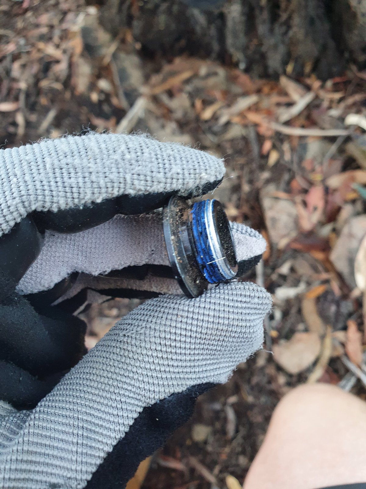

So my left hand ethirteen crank fell off today while riding. I’m glad I was going uphill and not down as that could be potentially really bad news!!?…The preload bolt is somewhere in a field in Hertfordshire. I’m going to north Wales next week for a riding break so this is shit news. I’ve ordered a new pair of crank arm preload bolts but my concern is that the splines on the crank appear to be damaged as the crank wobbled and came off. What’s really annoying is that I actually saw the link for this issue here on the forum after buying my Orbea Rise and I checked both cranks to check all was tight. I noticed on another post that two riders had their Carbon ethirteen cranks replaced with shimano cranks. I’m looking at a warranty claim through ethirteen direct as the Moore and Large website doesn’t appear to have any useful information on warranty claims. @e*thirteen Components
@DarrenCC - Sorry to hear about the trouble. Our team will get you sorted thru the warranty claim process. Please send a DM if you have any trouble and I can assist with facilitating.
