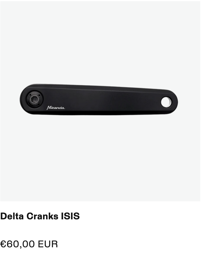

Thanks for all the replies. My only issue at this point is finding a reasonable priced set of 155 cranks. 5dev and Miranda seem like the only companies that make 155 cranks for the EP8. 5dev are super expensive and Miranda are super cheap... Anyone know any other companies making these. Cheers to all who responded.

Miranda makes good cranks and their carbon cranks are not cheap.
