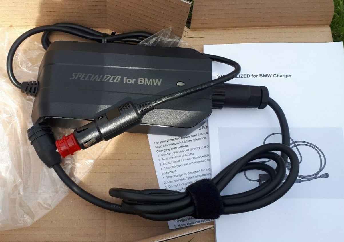

Dumb question but are you supposed to remove the red end from the charger before plugging it into the vehicle?
cozzy
Aug 11, 2019
792
855
Hampshire UK
Oh that's odd. If I really push and hold the charger in the socket it's ok but stops charging as soon as I let go. If I take the red bit off it works fine.
cozzy
Aug 11, 2019
792
855
Hampshire UK
I would have thought that depends on the socket you have. It shouldn't cause a issue to try it either way though.
True yes I didn't know there were different size sockets in vehicles, din socket is smaller apparently and that's why there is the removable red bit.
It should work with the red bit in my socket but doesn't engage properly. As long as nothing is shorting out then I will leave the red bit off.
routrax
Jun 15, 2019
382
529
Uxbridge
I had a similar issue with the fridge plug in my van, it just kept coming loose and breaking the connection.
I just wrapped it in a few layers of insulation tape and it stays put now.
Those accessory/cigarette lighter sockets are often a pretty rubbish fit.
