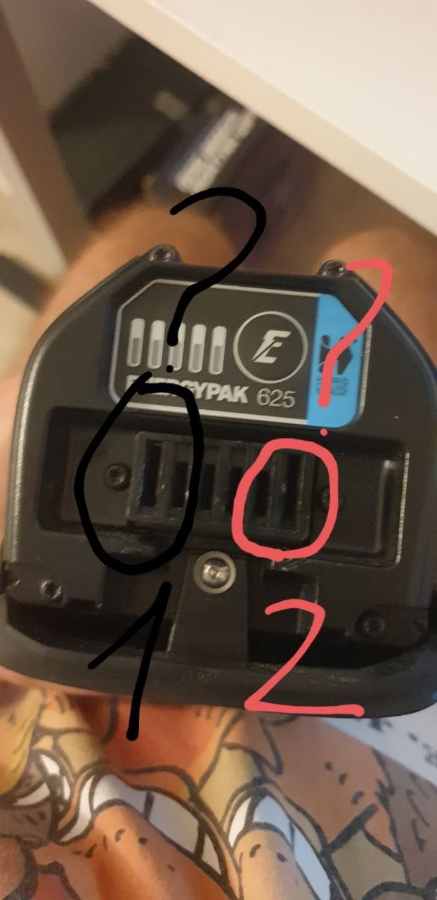

Why do you write pins 5-6 on the left? Are you shorting +charge and +discharge (they are on the right), or am I wrong and you are shorting -main bus and -can bus?
I'm start counting from left :) Now I know that all pins are signed (- 1 2 3 4 +) but I want to name them consequently in this thread.
Backing to Your question, yes I'm shorting "red 2" from the picture.
@Nobrks this walkaround works also for charging. Probably some mosfet is damaged and not switching correctly between modes. Additional BMS, only for charging could be a good idea but there is no space for anything additional. EnergyPak 625 is 10s5p, so I think the only way is to decrease number off cells.
