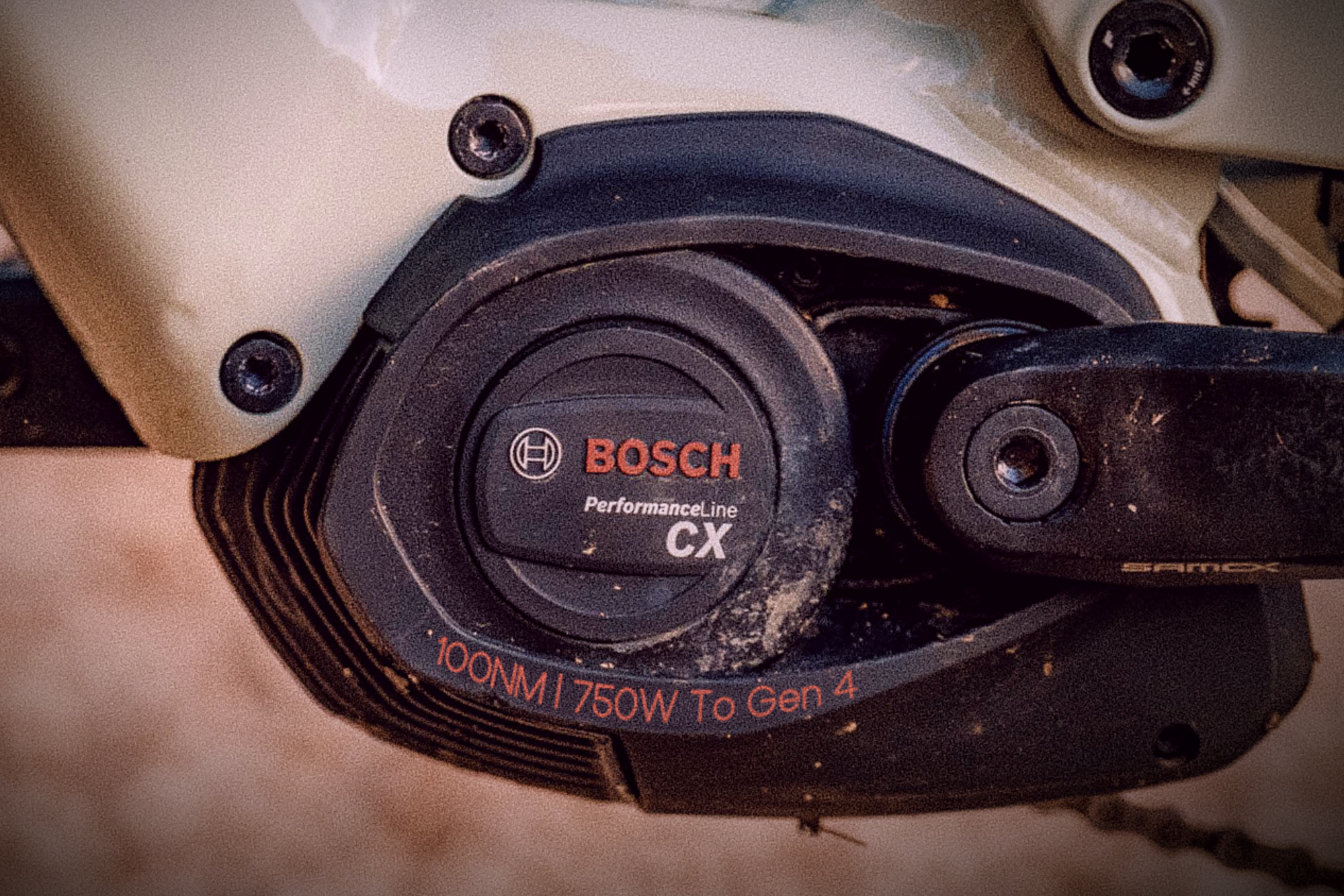

Me and many other people want 100NM and 750WATT upgrade to GEN 4 (BDU374Y) CX SMART systems.
We've made a change.org petition (see link https://www.change.org/p/100nm-750w-to-gen-4-systems)
We think Bosch GEN 4 CX SMART models which got introduced in 2022* are capable of the Upgrade (or at least some performance upgrade in terms of Newton Meters and Peak Watts)
I've spoken to Bosch Dnyo testers and developers and they (including me) think the Drive Unit can have the increased power, and that it is rather a choice of Bosch to update it or not. You can check on Reddit of our discussion about the Upgrade.

Gen4 motors barely get warm after long climbs at full power so thermally, they are clearly quite capable of being run harder. And the max power of a Gen4 motor doesn't significantly decrease with battery depletion so electromagnetically, the motors are clearly capable of producing much more power, at least when the battery is moderately charged. Mechanically, higher torque will absolutely increase geartrain wear, but has anyone ever worn out Gen4 gears?
So, yes, both Gen4 and Gen4 Smart can be software unlocked to safely produce much more power. For the Smart system it would merely require an intern to press the button unlocking the gen5 tune profile for us. Older Gen4's might require an hour or two of someone's time to compile the new firmware, but still trivial nonetheless.

One possible reason the gen 4 is not getting the upgrade is that while the motor can handle it, the battery might not. I had to warranty a 750W for overheating, and the second battery is starting to overheat too. Only happens on steep climbs in summer after riding hard for over 45minutes. Higher torque and watts will put more stress on the battery.

Total BS, the Orbea Wild has the 750wh battery and got the update on the Gen 5 like everyone else
I doubt there is any additional heat dissapating ability of gen 5 compared to Gen4. It will simply be a marketing decision.
