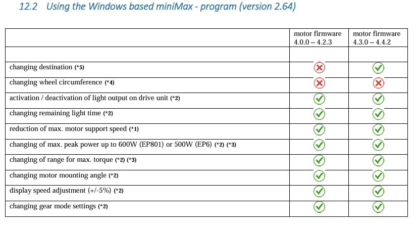

From Chapter 12 im not seeing that the option to change the chainring size and cassette settings exists. Not sure if this ends my quest to change the gearing or not. I wish there was a way to the current chainring and cassette settings to see if really need to go thru all this just to upgrade the drivetrain. I found someone who will lend me their PCE02 but im just waiting fomr them to contact me about when i can go get it. Do you know if theres an allowable percentage of range change in gearing before it will trigger the 295/299 codes?
Im changing the chainring & cassette to gain a larger range of gears. And yes for hills b/c this place is hilly. Most of the kemens sold in the US are class Is fitted with 36T chainrings and 10 and 11 spd wide range ie: 11 to 46 cassettes. But mine is sold as a class III but sports only a 8 spd drivetrain with a 44T chainring and a 11-40 cassette. Id like to find middle ground between the two which i think i can achieve w/o taking away to much of the top speed. If i change everything and can still ride around 20 to 25 mph and 20 to 30GI low gear ill be good.

Changing chainring size and cassette settings can be found in the latest item "changing gear mode settings" in the last row of the shown chart in chapter 12.2. :)
