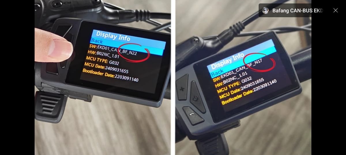

Latest display firmware required SW: EKD01_CAN_BF_N22
The display can be flashed with any third-party firmware, the main thing is HW: B02NC_1.01
Tested on bafang m510 and m420 works great.

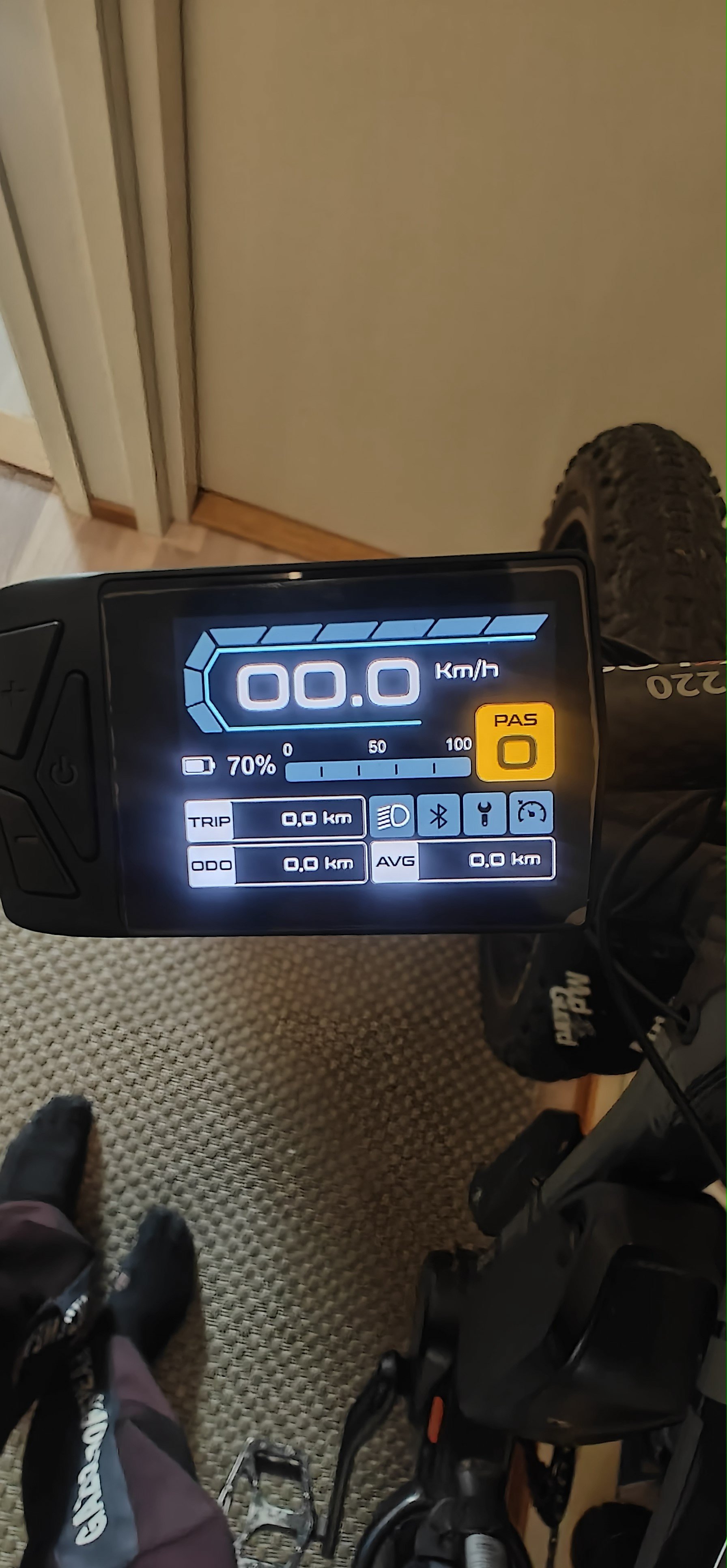

Setting the speed limit up to 99 km/h and quickly resetting to 25 km/h by pressing the + and - keys simultaneously.
Setting any wheel diameter.
Changing the voltage for correct display of the battery charge.
Possibility to set the display of voltage or % of battery charge.

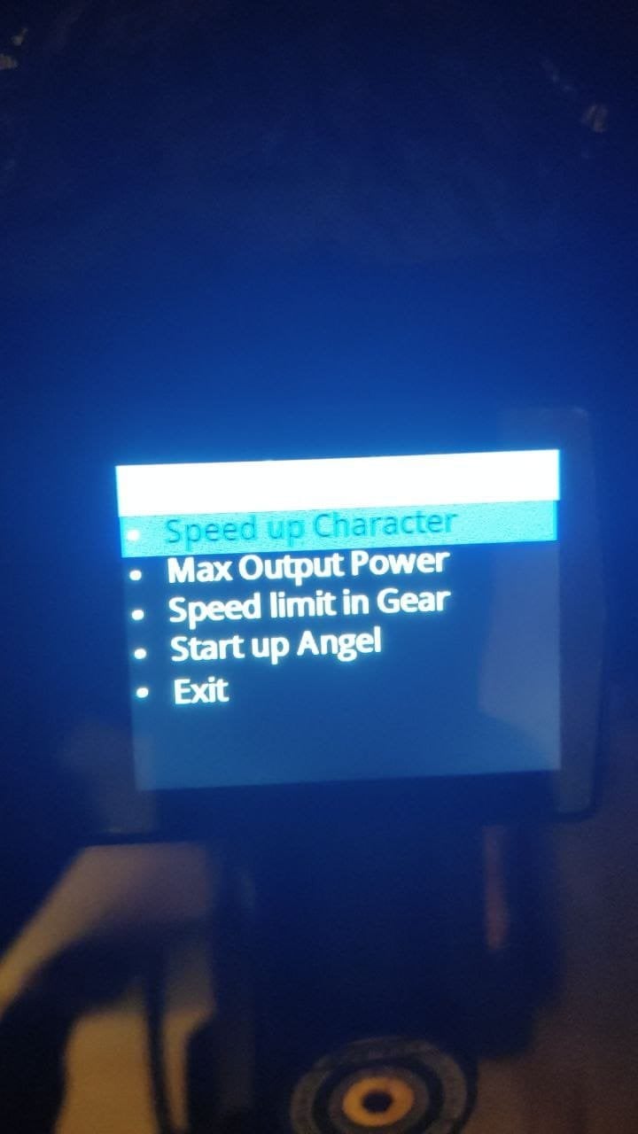

Manual Advanced Settings Update firmware N22 CAN

Don't worry, feel free to try to change and apply the advanced settings, it won't break the firmware or the controller. My m420 also reads 0 and unfortunately the settings are not applied, it does not break anything. They are not used on all engines, you need to try. But other settings work fine, changing the speed limit to 99kmh, quickly changing up to 25kmh by pressing the +- buttons, setting the desired voltage, displaying the voltage instead of % charge, setting the wheel diameter.

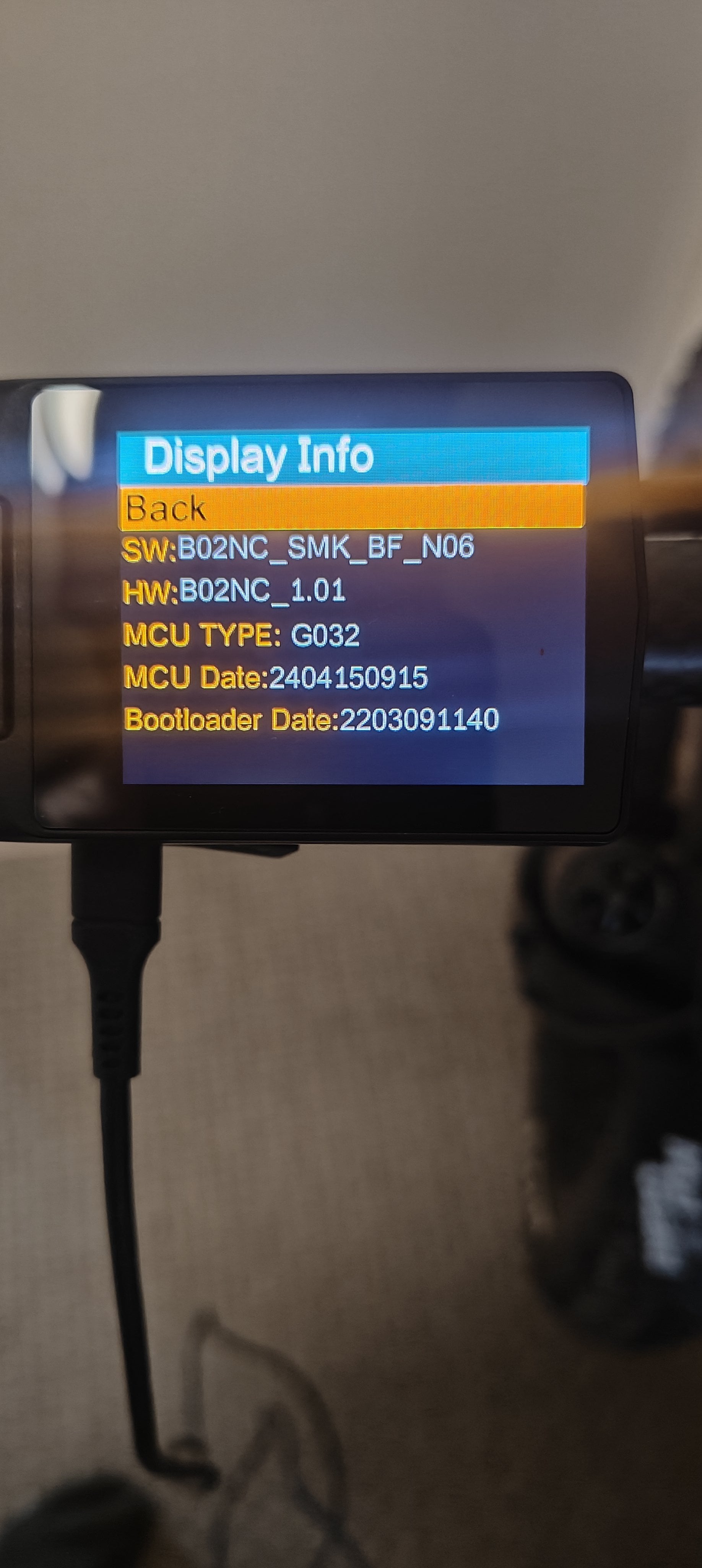

i just updated mine and the speed, battery level and down button dont work now 😭
sorted it... i needed uart update not can😮‍💨 oops
