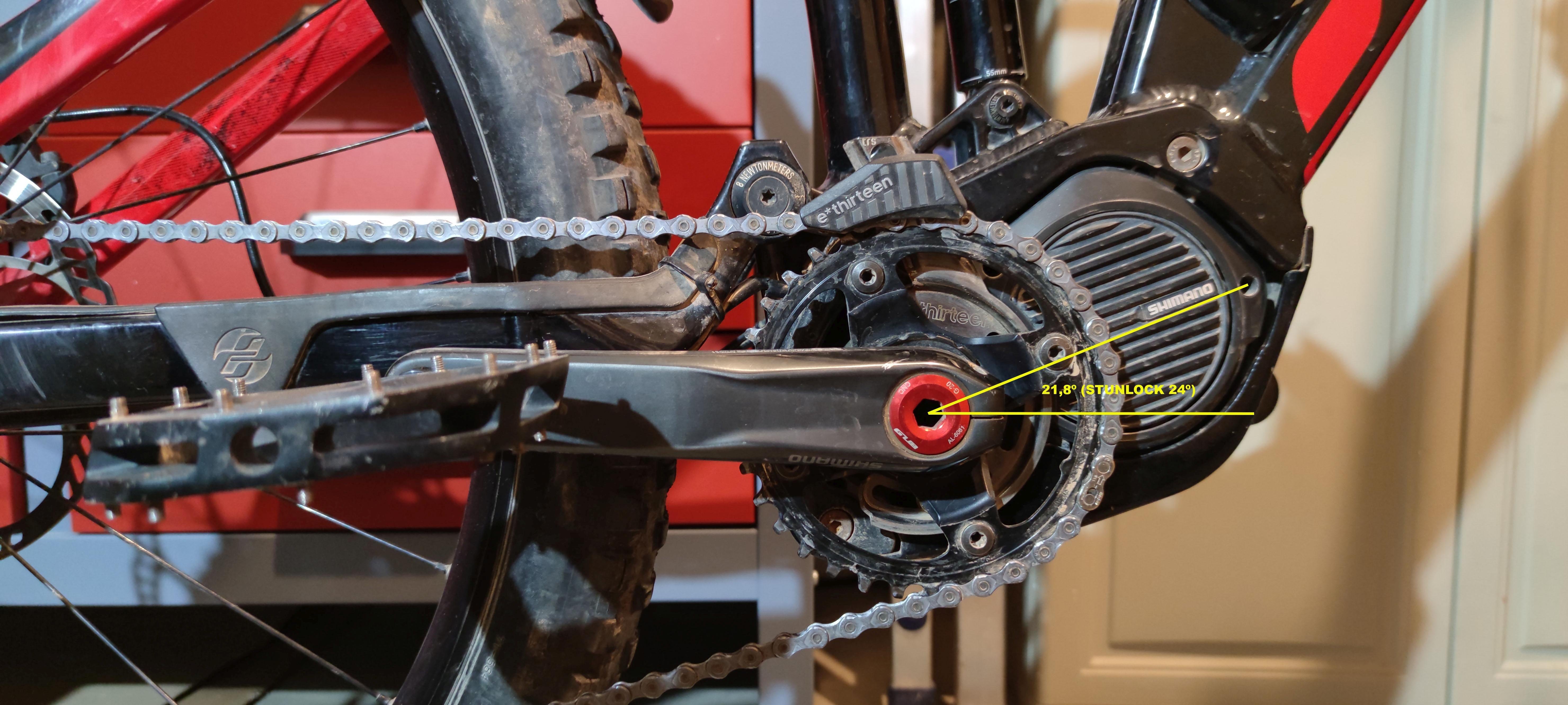

What does the motor mount angle do?
the shop has it at 0 deg, but my old set up had it at 30 deg.
I believe that motor angle is used by motor software to determine the rider pedal stroke upper and lower position, and with this and the motor torque sensor, the motor makes calculations for the assistance.
Motor configuration should have the correct angle, if not, something could go wrong.
In my old bike with Shimano E8000 Motor, I tried to verify the real motor angle value versus the configured one, I used Photoshop to measure the angle in a picture, and the measured angle (22º) was very close to the value in configuration (24º).
