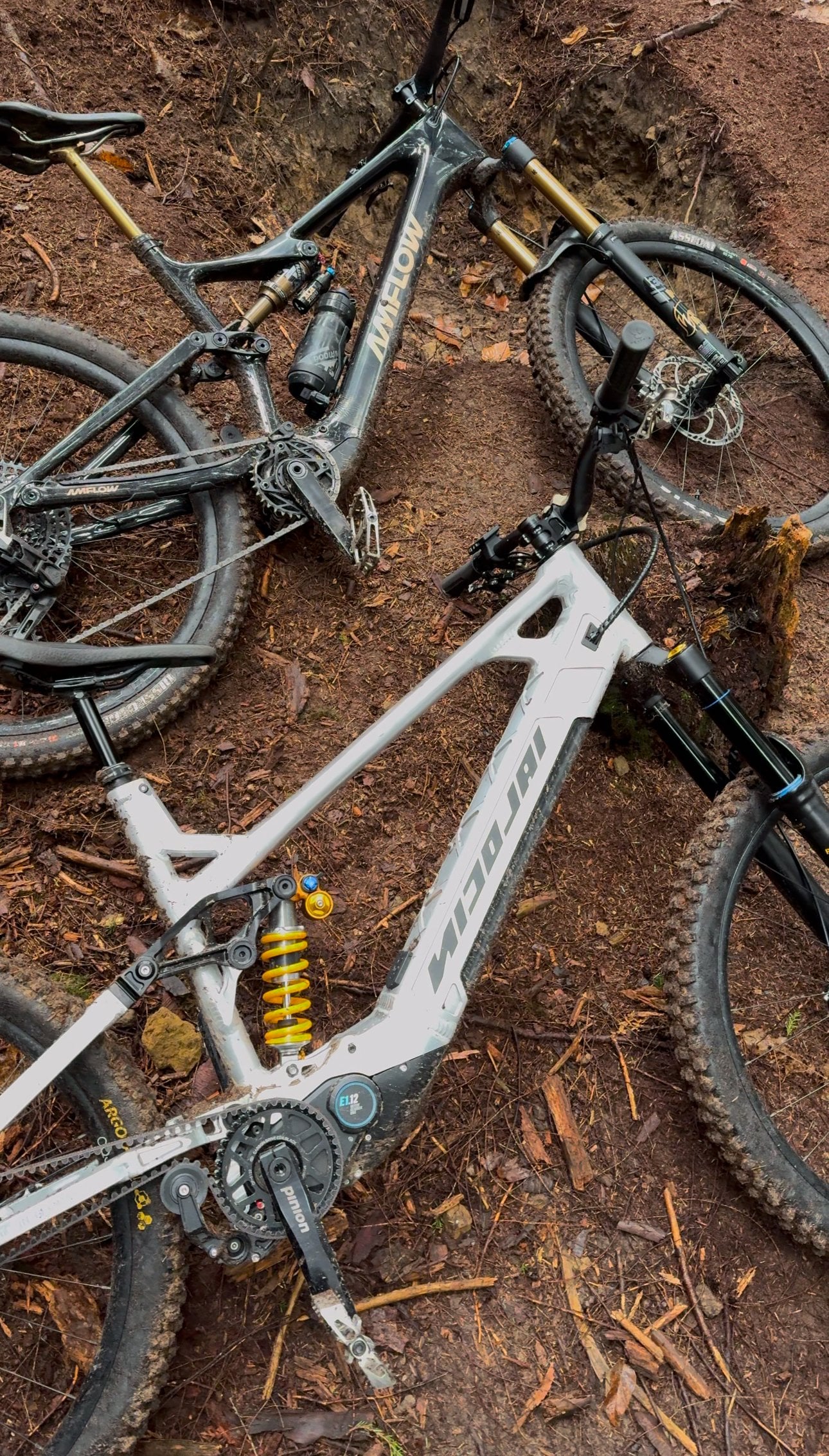

By the way, loving this bikes handling. The suspension performance is incredible. As is the handling. It handles so much lighter than the weight suggests.
The rear suspension is so supple, ultra reactive and actually feels pretty playful, which surprised me a bit.
I’m running it as a mullet bike, I reckon the weight reduction out the back with the smaller rear wheel and tyre, no mech / cassette massively influence how the rear end performs.
Hitting enduro trails on the bike is so good. Ultra quiet, very good chassis and incredible suspension.
The motor noise still bothers me on gears 1-4. And it’s a bit clunky elsewhere. I’m getting used to it, but have a wish list for a V2 Pinion already!
