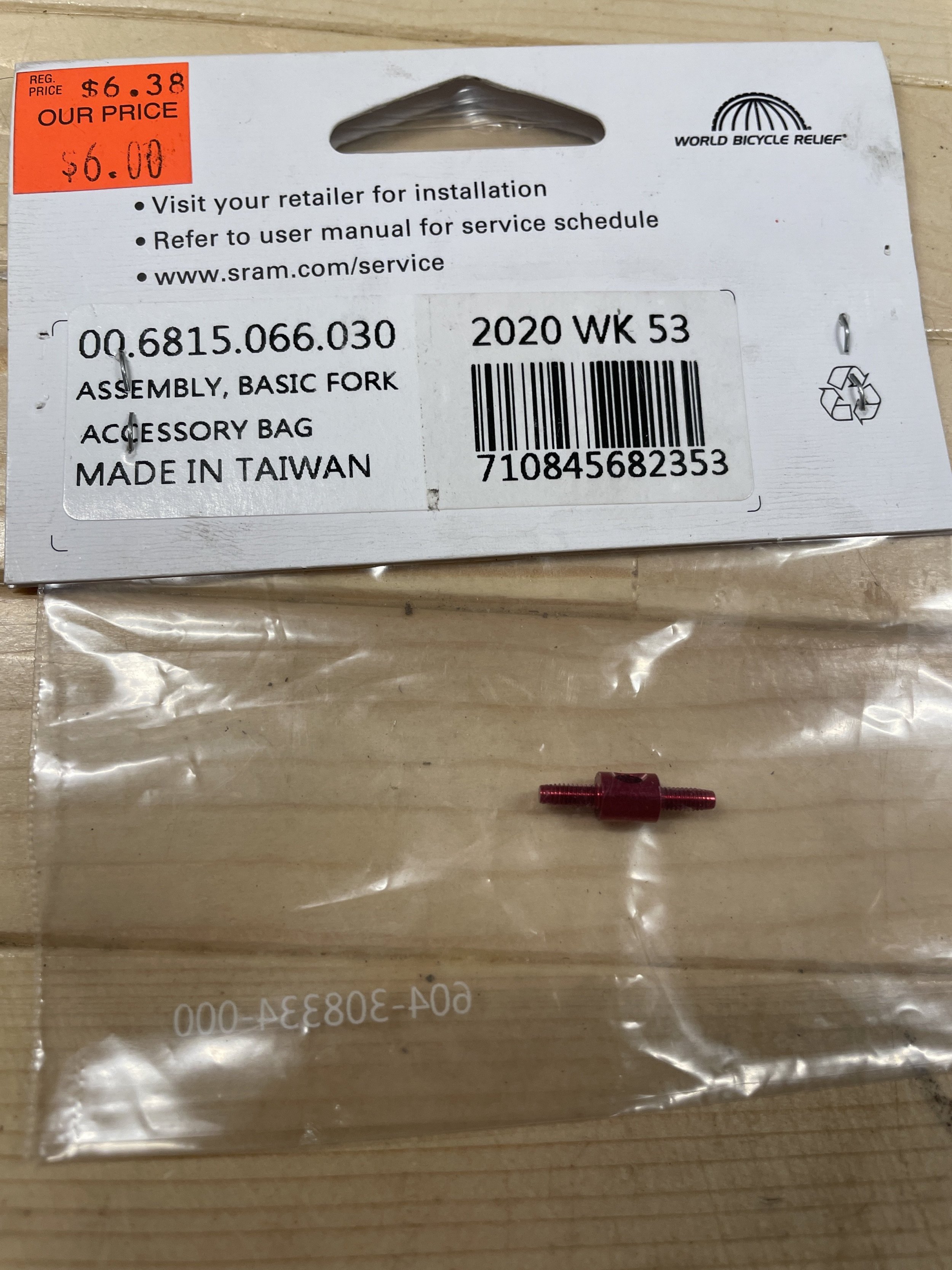

Torque wrench, Torx 40 Plus socket, and some basic shop tools. No need to remove the cranks or chainring, just slip the chain over and out of the way. Gently remove the electrical connectors from the motor (the main power connector has a snap feature, be careful). A small cable sheath connector helps thread the new cable through the tricky parts (stem area, battery compartment etc).
Don’t use a bike stand, flip the bike on the bars after the wheels are removed.
The entire process is not too bad if you have the tools and the time at first. Having a LBS drop the motor can be costly but if you diy those funds can go towards upgrades. (And you’ll look like a hero to the neighbours). image.jpg
