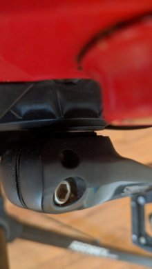

I checked my bike and I noticed some play in the "bottom bracket" bearing on the drive side. I contacted Commencal they said I am the first one with this problem and asked me to make a video and send it to them. The bike has 1420km and I find it early to have this problem but I saw a post on a German forum with the same issue after 1500km.
Anybody here had this problem?

is it definitely the bottom bracket and not the chainring lock ring or crank arms?
Unfortunately, it is 100% bottom bracket. Everything is torqued down properly and the play is in the bearing. I see it, feel it, hear it... Tomorrow I will make the video and I will link it here.

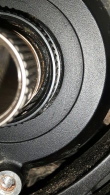

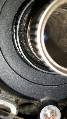

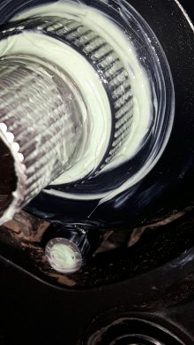

After watching Tamas's video I decided too Strip mine down to see what the seal between the motor and the BB was like and I have to say it looked pretty good, a little bit of crud but nothing horrendous, but I decided to clean it out and pack with the area with waterproof grease before refitting everything, can't do any harm. Did the same to my Bosch CX and it never gave any problems.
A bit disappointing from Shimano, will be interesting to see who else has 20180517_194408.jpg20180517_191522.jpg20180517_191443.jpgplay in their BB bearings, I'm sure after Tamas's experience everyone will be checking.
A bit disappointing from Shimano, will be interesting to see who else has play in their BB bearings, I'm sure after Tamas's experience everyone will be checking.
Greasing is always a good idea. :) Shimano BBs have good seals in my experience - at least in the weather conditions I'm riding. The XTs in my enduro are in their third season and they are still running smoothly.
