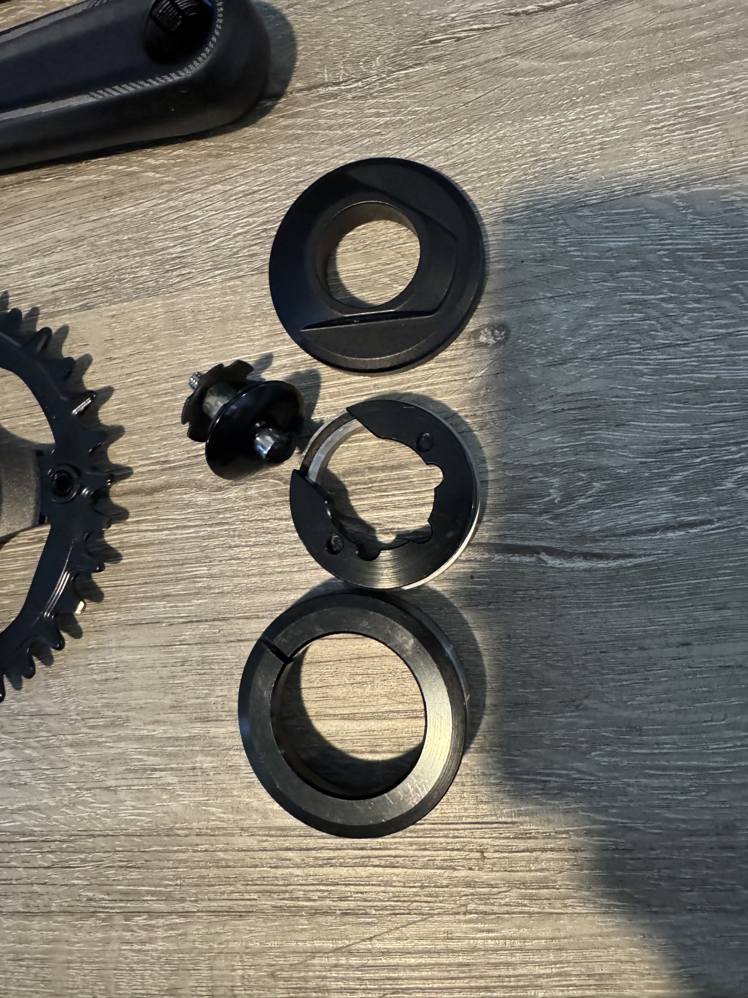

Got my frame today and started building. The headset race on the fork is a loose fit. And attached is a pic of how the upper headset fit and a pic before installation.
I’ll let Jean know, but I think an entire new headset is in order. Can someone confirm the correct size? The website says 52mm upper and 66mm lower, but that seems inconsistent with what some have used (56mm upper). Any help would be much appreciated!

Hello lucky you mine is always traveling for the headset the size should be zs56 above zs66 below if you don't have a caliper measure it with a ruler 👍💪

notice that you have lateral cable routing, in your place I would change immediately 🙈that headset is unwatchable and you will have problems

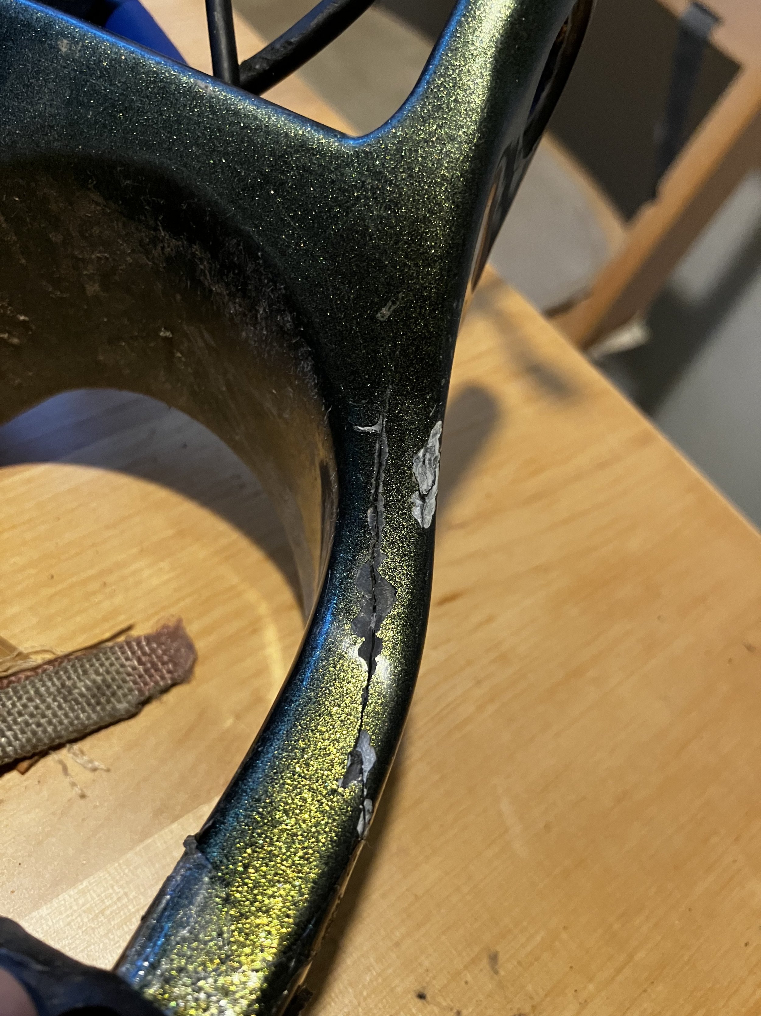

Today I was planning to do annual full service including suspension bearings replacement. Upon disassembly and closer inspection I’ve found the crack in the chainstay, which was hidden under the rubber chainstay protector. This must have happened few months ago as the crack resulted in paint chipping which I noticed long ago but didn’t suspect of being anything serious. Anyway, I’ve contacted Jean and she’ll forward this to technicians on Monday, but I wonder if they are going to replace the chainstay under warranty, what’s your experience with such cases? I don’t remember how long is the warranty period. It’s now slightly over the year since I placed my order (2023-11-25), but less then year since it was dispatched (2024-01-10) or delivered (2024-03-06), so I guess it should be still covered by the warranty even if it’s only one year…
Has anyone had similar issue, did they send you replacement chainstay, was the speed sensor included and its cable pre-routed? I don’t want to go through all the pain of cable routing again…

Our frame has a 3-year warranty..I thought I had a cracked seatstay at the drop out last year on the drive side....it.was replaced out of caution no problem.
Note when I painted the whole frame myself a few months later I had to reroute the cable too. But in anticipation, I also had kept the plastic white feeder line that will likely be fed in with the warranty replacement chainstay.

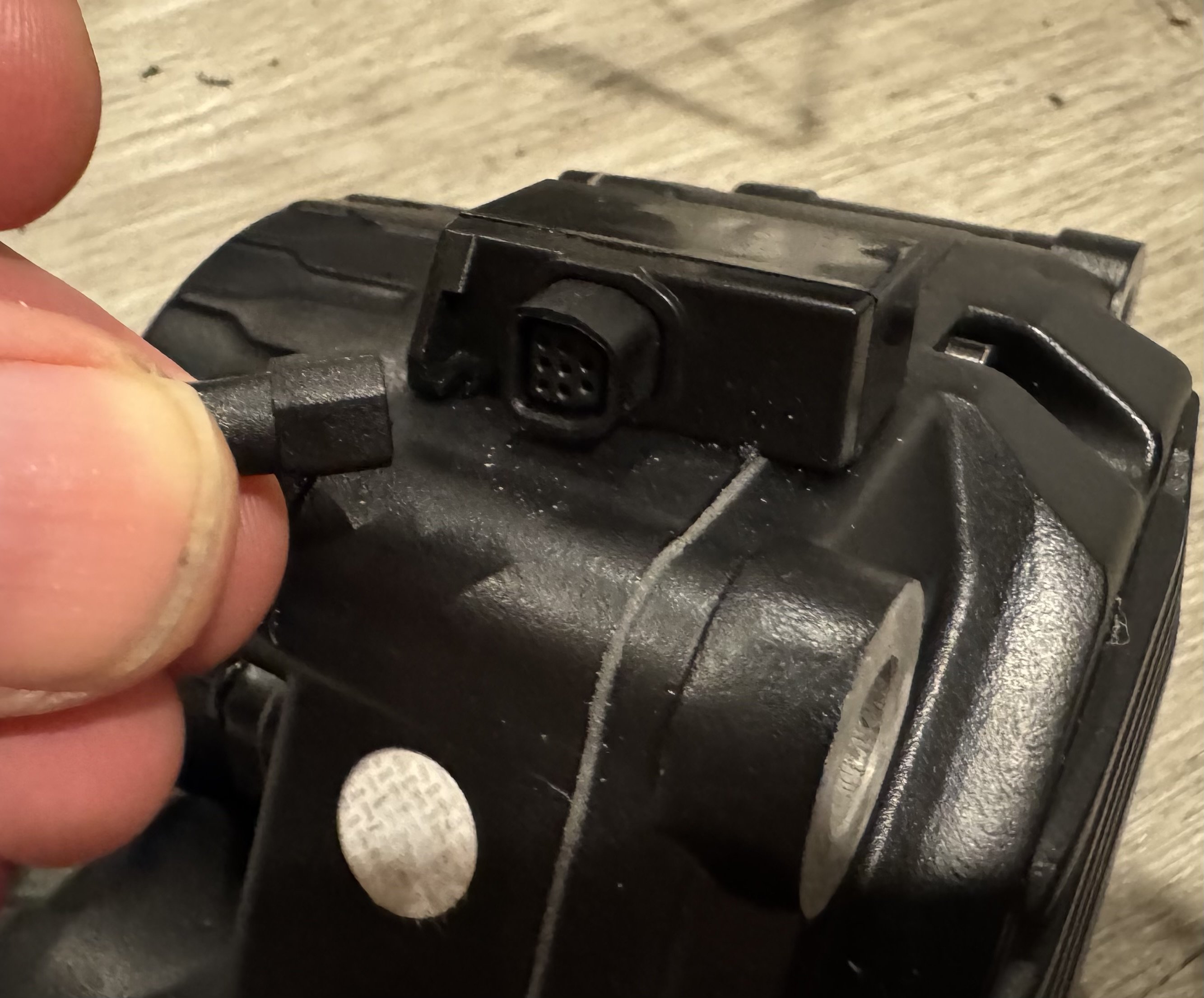

Hey y’all,
I’d like to verify my connections.
First off, I unplugged the charge port cable to secure the port. It uses the same connector as the cable going to the motor. I believe I have it plugged in correctly (see pic), but is there any way to confirm?
I also have some connectors on the cable from the handlebar-mounted controller. I think the yellow triangular cable plug is for a throttle and the loose ends for a light so I’m planning to ignore them. Does the black connector plug into the front port on the motor? An identical port is on the rear, but I think that’s for the speed sensor? There’s really no color coding like I expected.
Any help on this would be much appreciated!!

I got info from Jean they will send me a new chainstay. I used this opportunity to order a spare motor guard and 2 complete sets of spare suspension bearings in the same package (one set is 8xF6901-VRS + 4xF6801-VRS at 1.65$ each bearing). They will pre-route the speed sensor in the chainstay but I need to buy a new sensor (12.5$) which I was going to do anyway to have a spare just in case the wire got broken.

i think your can be claim under warrenty but its does not come with any bearing or cable, just the rear carbon triangle only and the paint might not be the same as yours original, might be slightly out, since your paint look like a custom paint.

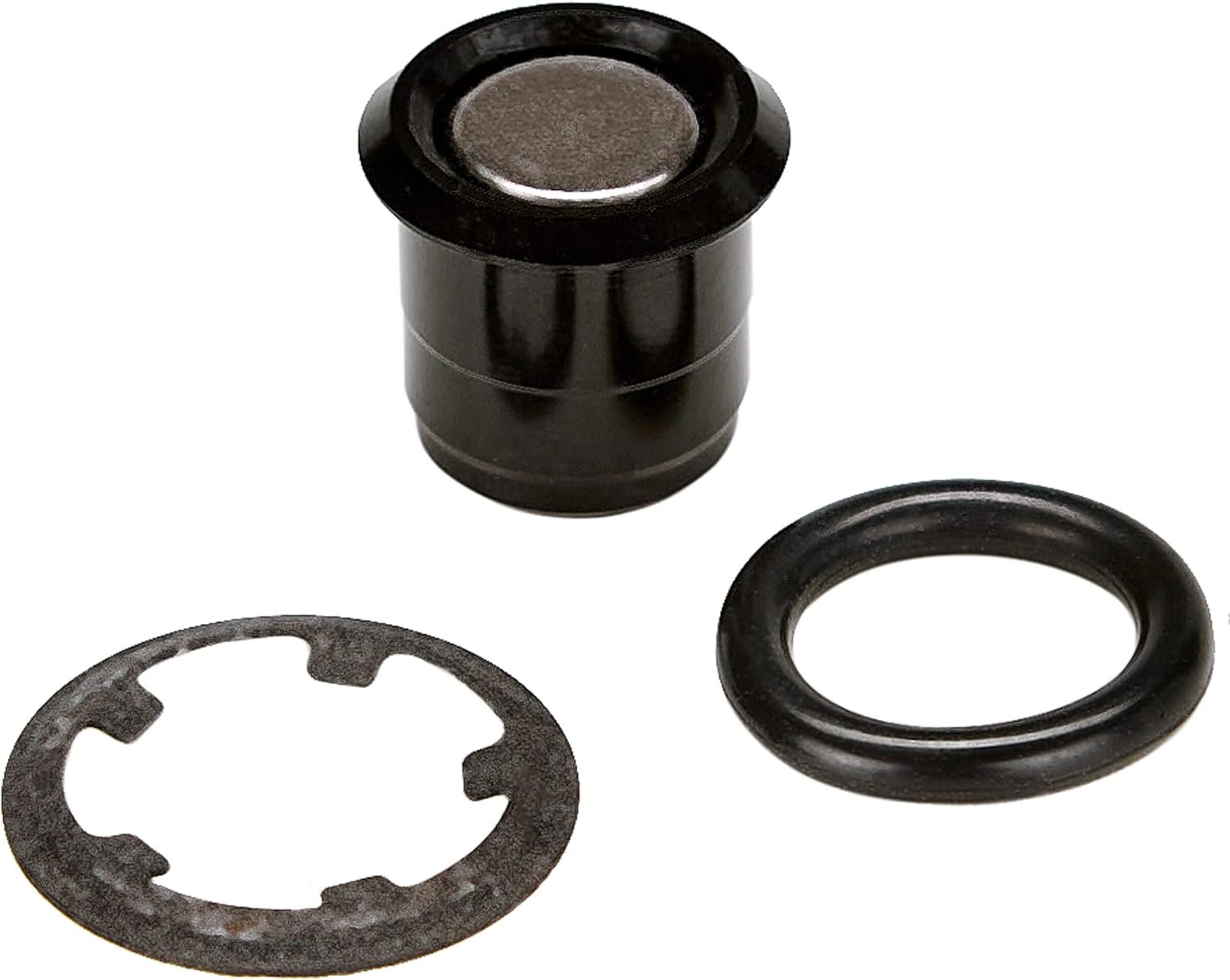

Thank you all for the suggestions on the speed senor. I didn't realize it could be rotated! I also installed the Magura magnet to the rotors and it's such a nice and clean install! Pic of the magnet attached.
