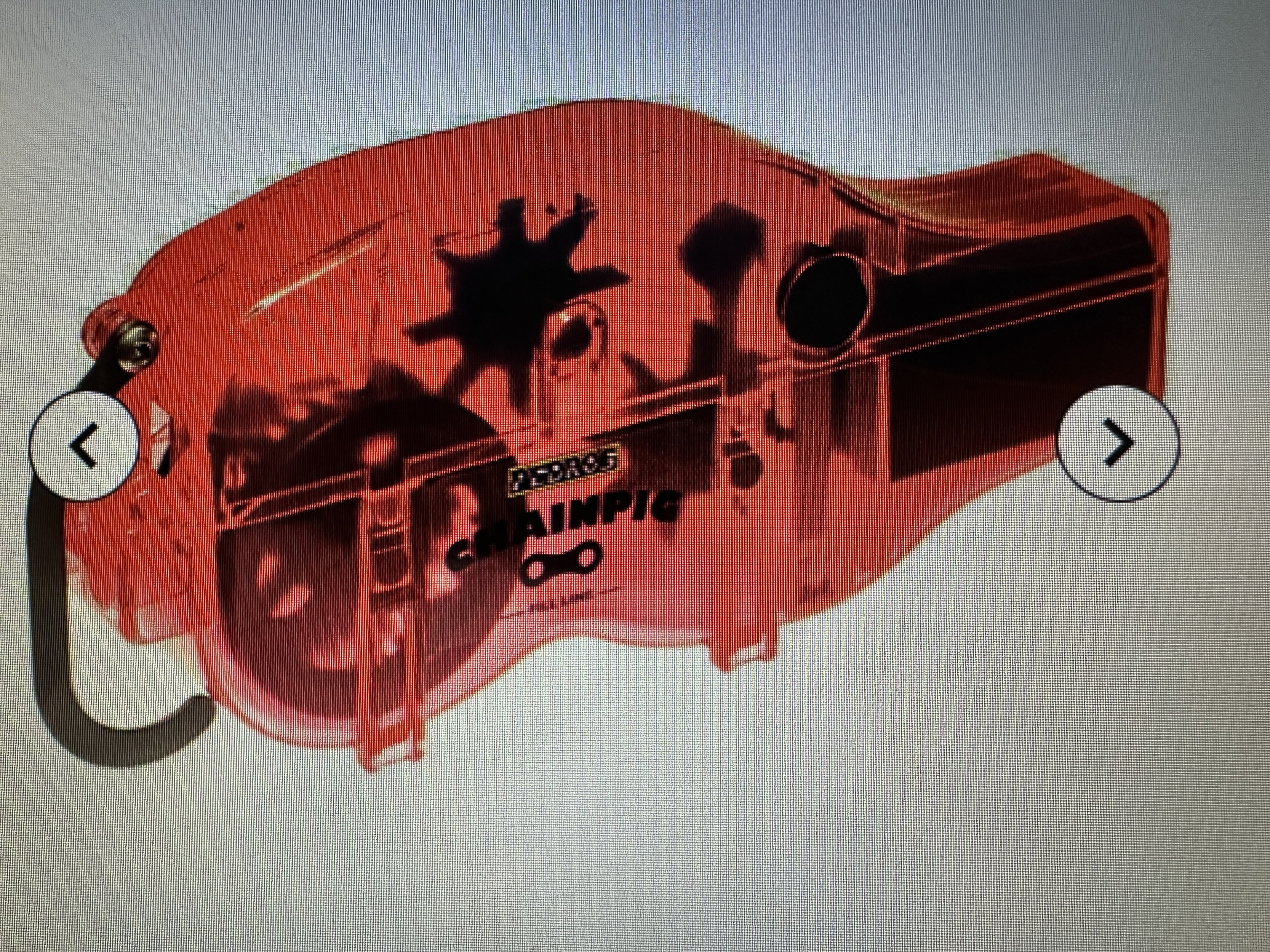

I use Pedros chain pig. works great, cleans out a lot of dirt. I use just water or hot water or soapy water or degreaser in it. It get a lot of dirt out of chain . easy to use. rinse dry and lube chain
