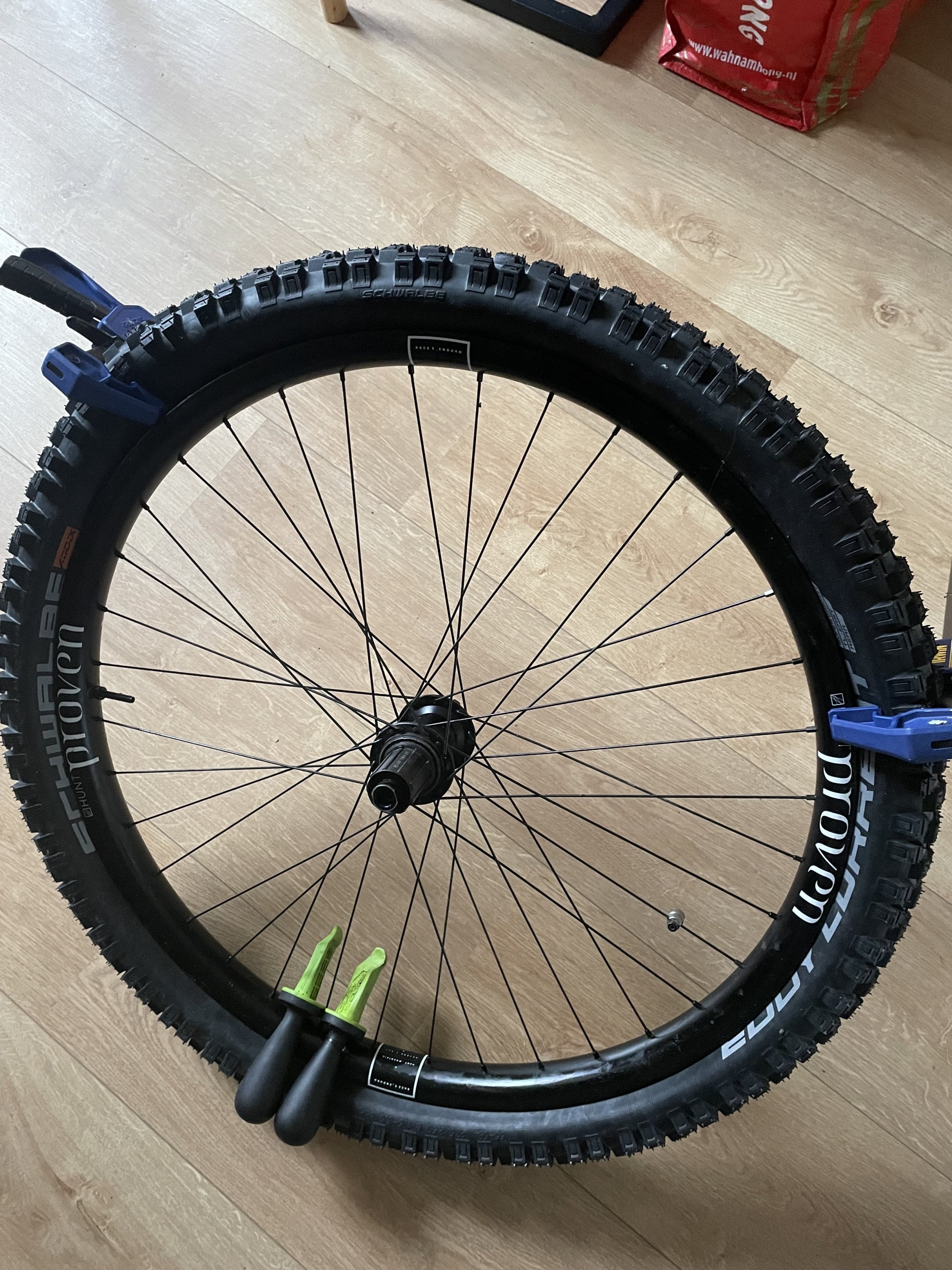

Building up my slightly used wheels,
Hunt Proven Carbon Emtb mullet wheelset. 31mm internal 36spokes and steel HG driver.
These are build like a tank and for me (104kg) these rock! very stiff and allow me ride super fast without worrying.
they came with lifetime warranty as wel.
removing and cleaning the used cushcore turned out to be a hell 😅
installing them on a new super gravity casing tire turned to be almost impossible. lets have hand pain for the coming week 😬
nice burly eddy current tires in the Soft
compound. These rock both hardpack bikepark trails and softer loamy conditions and doesn't have a lot of drag either.
this is not my first rodeo 🤟🏻
2 oversized wood gluing clamps and 2 oversized cushcore tirelevers
finished set
2.6 eddy current 29" front soft supertrail
2.6 27.5" rear soft super gravity
both with cushcore inserts (just love the way they ride)
