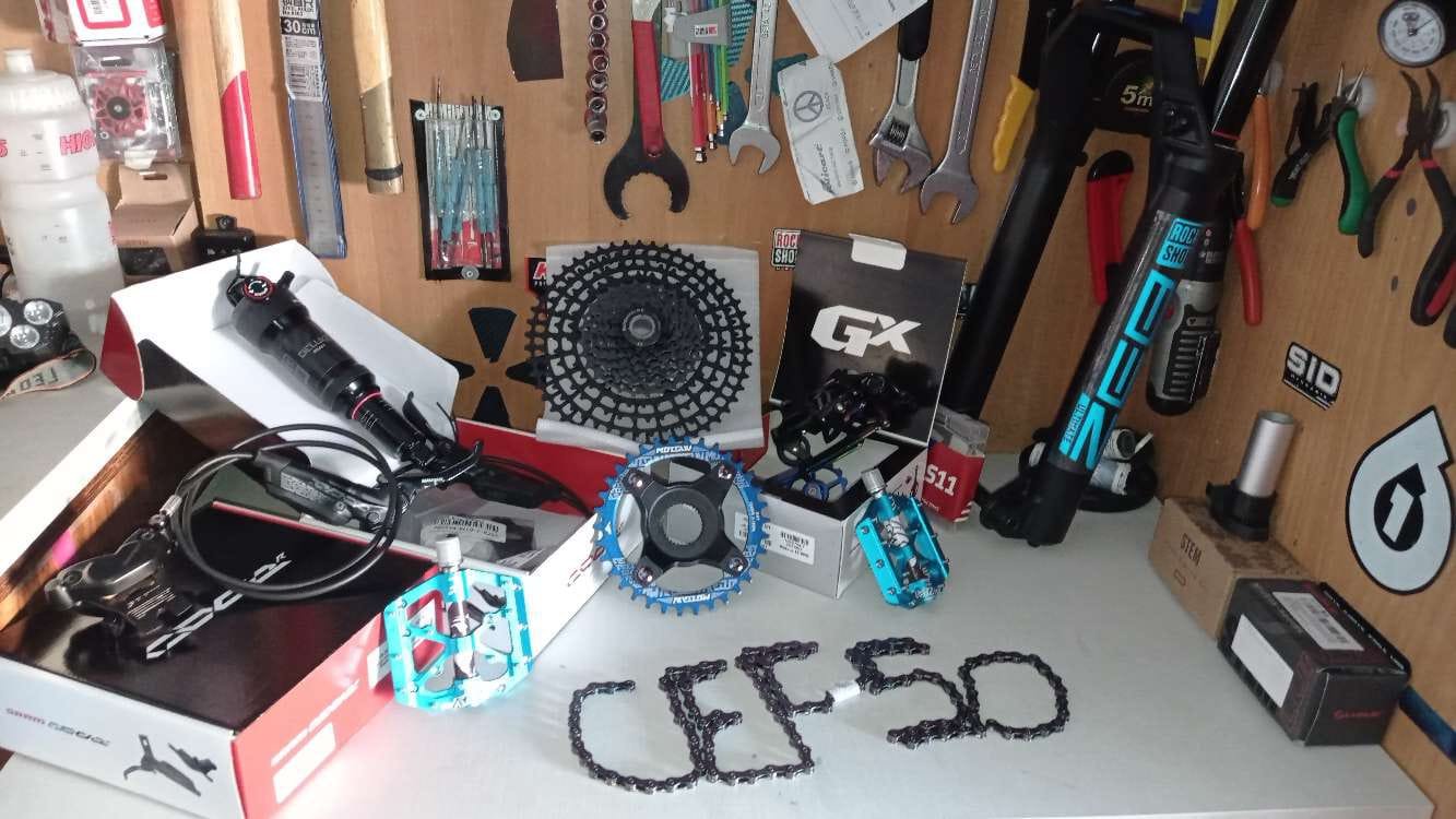

While I wait for my frame, I’m trying to comfort myself by assessing the growing parts pile. Still have a lot to acquire, but it’s getting there!

Hi, like you, I'm also waiting for my frame, I can't wait for it to arrive and from time to time I take a look at the various components I have at home. I hope it arrives soon. I'm expected to arrive between 15/30 November. Here are some photos of the components. I posted the wheelset.

Like you, every now and then I look at the components that will distinguish it because there will not be a Cef 50 the same, they will all be Limited Editions.
Here is part of my build.
