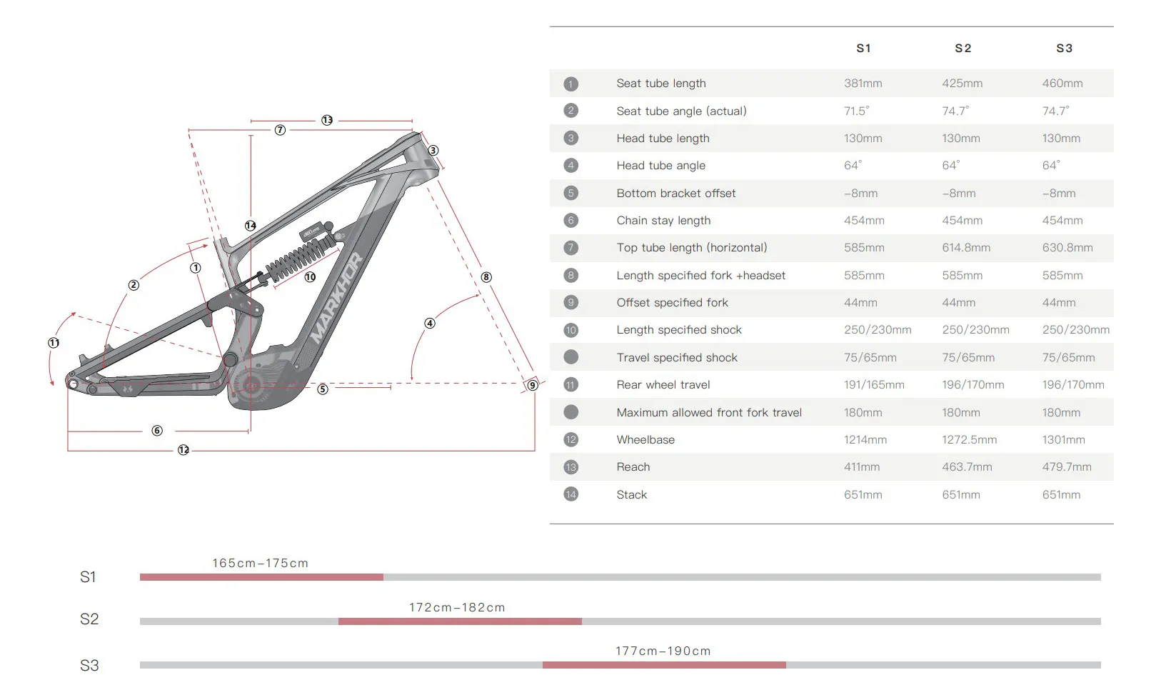

Any more info. to share about this frame? It looks very interesting, but some of the geometry confuses me. The effective seat angle shows to be a slack 71.5 degrees, but in the pictures it looks to be closer to 77 and that appears to be with a mullet setup. The reach for a Large looks very short at 460mm. Can anyone vouch for the accuracy of the numbers in the geometry chart?

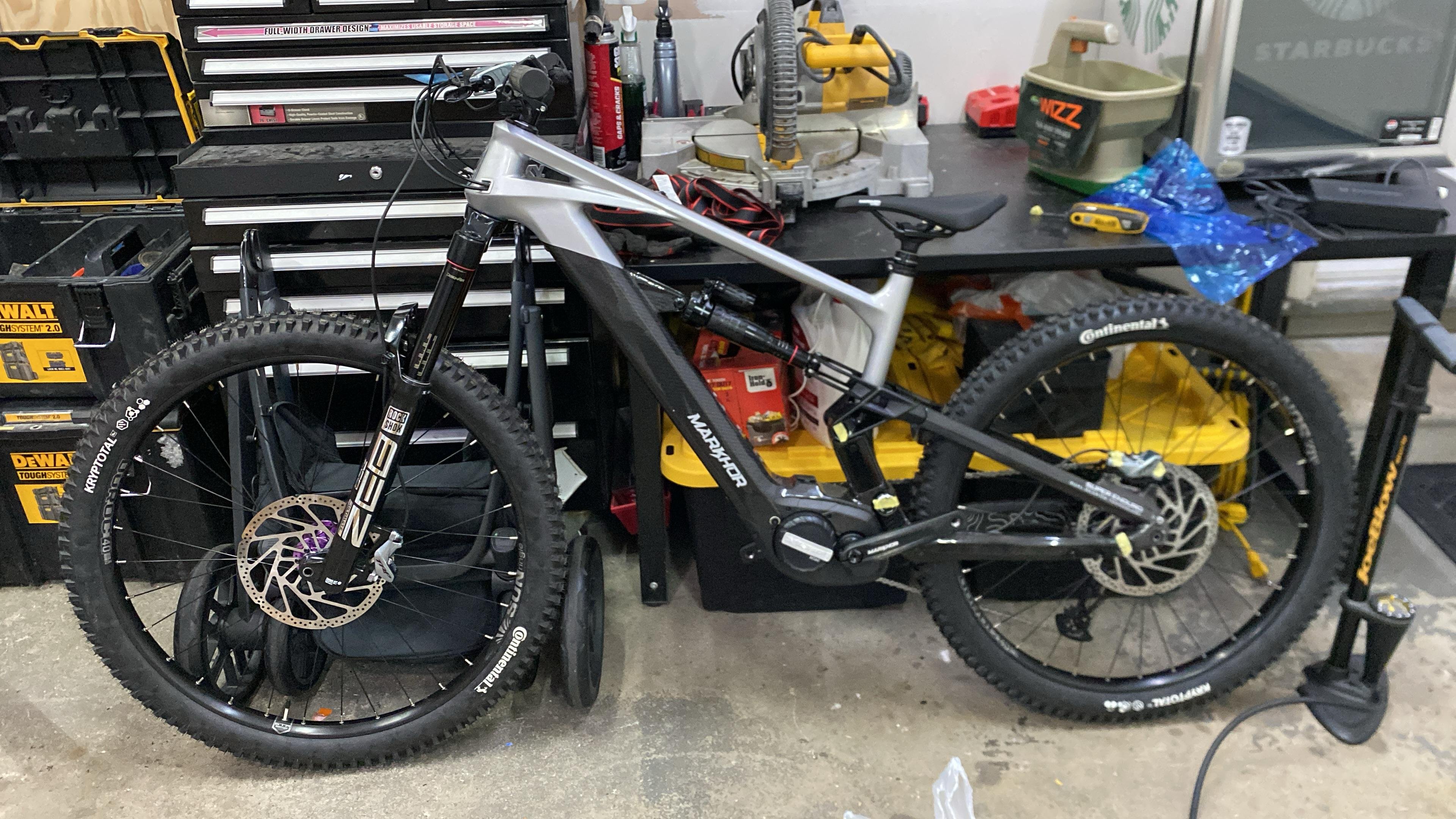

I got a complete Bike from Alibaba. I can say that yes it comes as a mullet setup. 29 in the front 27.5 in the rear. I think it’s a great EMTB I got the size medium (S2) pro spec build because I prefer Rockshox because that’s what I’m used to. If you want to see any pics of my bike let me know. I’ll attach one below. I only upgraded I’ve made is adding Deity pedals and a Deity 80mm rise handlebar. I think it’s a great lightweight EMTB I think it’s like 21KG or something like that. I had a commencal meta power SX race and that thing was heavy af.
This frames geo in pictures looked quite modern... but the geo chart looked way off the s3 was 480 reach with a top tube of 655 wtf ? so it get the better of me and i contacted them about it and sure enough they made a boo boo with there geo numbers here's the updated chart (y)
Which leads to the question how they designed the frame. Normally You design it around a given horizontal top tube length or reach value. Both values are not a straight figure, so it looks like everything just happened by chance 😂
