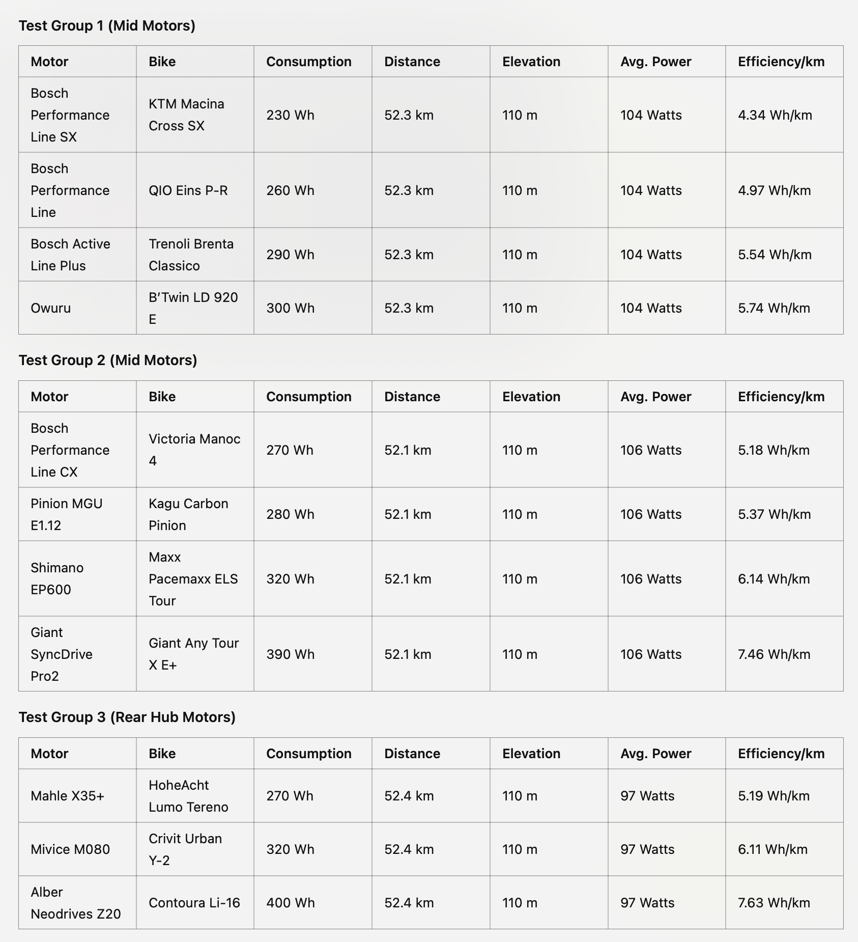

There is a test in a German e-bike magazine, but it was carried out with the Simplon Kago Carbon Pinion on a flat bike tour with 52 km 110 m. It was a comparison of different motor systems with relatively the same wattage output by the rider. I am attaching a picture of the table, but I don't know if you can make any sense of it if you don't speak German.
Nice find! Hype back up to 100% for the pinion!!
I ride a giant with an 800Wh battery and was blown away on group rides when my mates on 720Wh Bosch systems were climbing faster and had more range than me.
A Bosch with 800Wh can do 2000m of climbing in race mode with a light fit rider, so if the pinion is pretty much the same efficiency and comes with a 1060Wh battery you could easily do 2600m of climbing in the highest mode. Bonkers

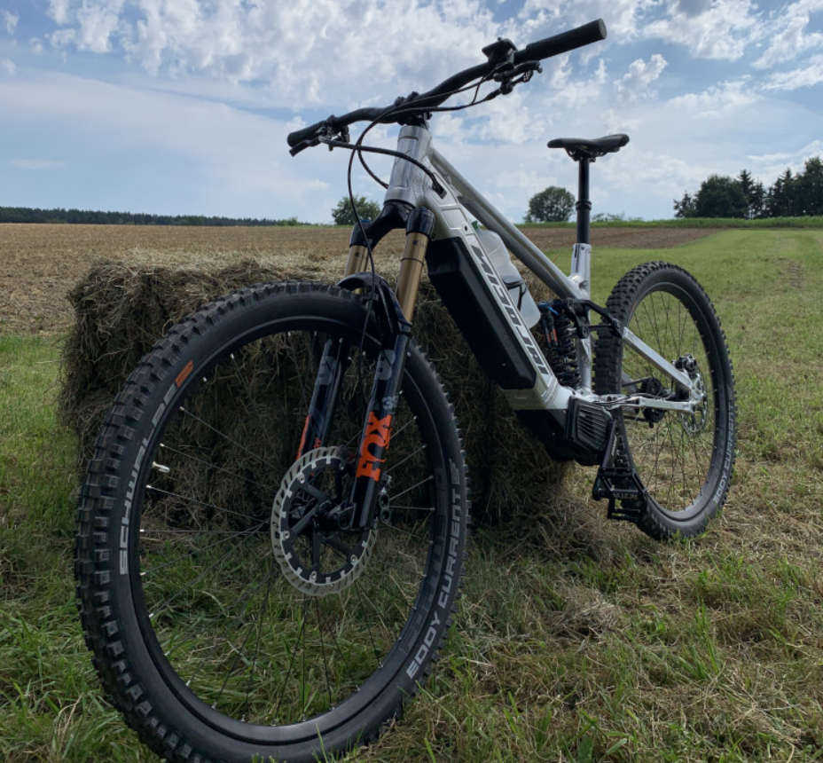

Update: my bike arrived on Monday :)
I had a 50km/600hm ride on the same day.
In one word: unbelievable!
I love it so much! It loves gravel, it is so stable in downhill, and powerful in uphill. It is really a new world of biking, for me.
One photo attached.

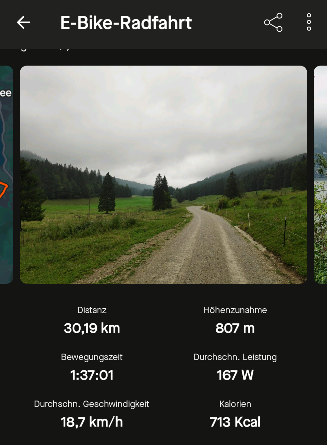

Today I had a morning ride in the bavarian alps.
My first experience with the range of the bike, equipped with 960Ah battery:
Ride Start: 84%
30km / 800hm / 1Std 34min
Ride Stop: 31%
I did most of the way in FLEX mode and only the steepest parts in FLY mode.
I guess I did 90% in FLEX and 10% in FLY.
One photo attached.
See more photos here:
(german ebike forum)
Nicolai Saturn 16 MGU

Extremely rude question so my apologies in advance, what weight are you and how fit do you consider yourself?
Obviously very hard to estimate accurately, but I would have expected a bit more range than the stats you reported.
Eddy current would be one of the most battery draining tires as well, good or bad. Looks like a 2.6 as well?
Im also curios on the riders weight?
That's fine for me :) no worries.
I am 46, approximately 90kg. My fitness is medium, what I would like to call it. I run once a week, slowly. And I have at least one bike ride per week. Normally not in very high intense or extreme sportive. But I love to run and bike in every weather conditions and on all surfaces and areas and I am a all-season runner and biker.
The S16MGU is my first EBike.
I own a 28" Cross Bike with a powermeter for regular training purpose, and a 26" Trail Bike, plus additionally a 2002 Nicolai Helius CC for fun rides on my hometrails.
So far about myself :)
What I felt during the mentioned ride:
On normal street surface the (2.6 Eddy Current) tires roll quite good. But on gravel forest roads it rolls very bad. This leads to a lot of traction, for sure. What was perfect for the steepest parts. But biking with lower E-modes on gravel road was quite exhausting.
Based on my current condition and the unknown terrain (will the battery last?), and due to the fact that I am a EBike rookie, maybe the ride was more inefficient. But I liked it in the way I did it.
A more sportive Person, well known EBiker and equipped with other tires might save more battery.
