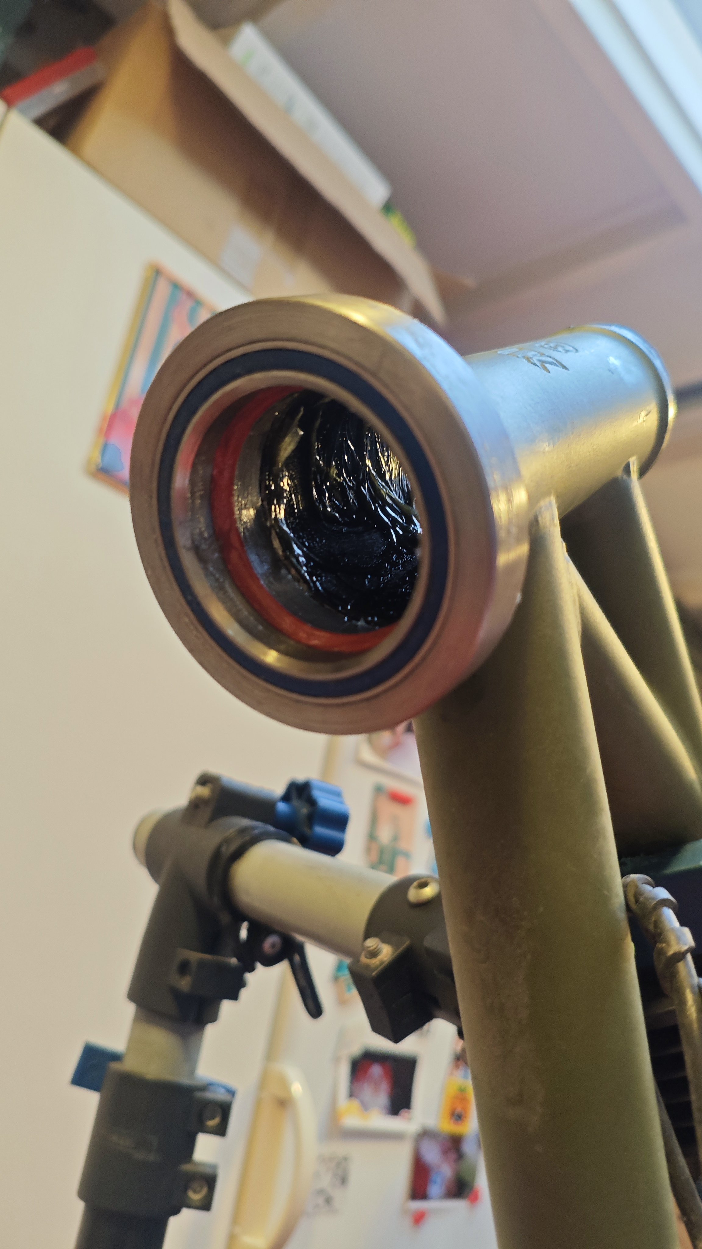

Did a mistake and bought a fork with 1.8" steerer tube. Trek Rail takes 1.5" steerer tube inside. I couldn´t find conversion cups in market so I designed and builded conversion cup myself. This lifts front 13mm but hey, it works! Here are the results:

I used blue locktight when I assembled the conversion cup. It sticked well to the original cup. Mainly I go for rocky, technical downhill enduro tracks, so I think I've had tested this conversion cup pretty well. So far everything is perfect, no problems with the frame. And this 1.8" steerer tube gives extra stability!

Aloha you all out there, after 4 years of riding my PUNK with 59 HT ( with 160 mm fork ) and 180 Yari /160 mm suspension I have decided to upgrade my fork to a Zeb Ultimate 180 mm but 😂😂😂 I didn't pay attention to the fork diameter steer tube 😞.
Zo, bought it on high discount, and tried to put it on bike...and.....the steerer diameter is 1.8 inch tapered, new one for E-MTB , and my bike of course that accepts only 1.5 tapered. Zo, who's got a friend that his dad has and knows to operate a lathe ? I , MYSELF ,😂😂😂.
So, bought an Acros IS60 for bearing and crown race, measured frame internal dimension and for external adpater bearing and crown race are the reference.
Fit it today perfect , will test it thus weeeknd at The Mother - Bikepark Winterberg
Details:
Fork 180 mm Zeb Ultimate 44 offset
Adapter material Steel Is Real MTB height 15 mm
= 195 mm "suspension" zo HT 57 degrees if the frame was built for 160 mm ?
Thank you dearly Marino Bike Marino Bike , Dragos Coarfa Dragos Coarfa , Tudor Coarfa Tudor Coarfa , Rcz Bike Shop Rcz Bike Shop and not the last Jaman from emtbforums for reference CAD files.

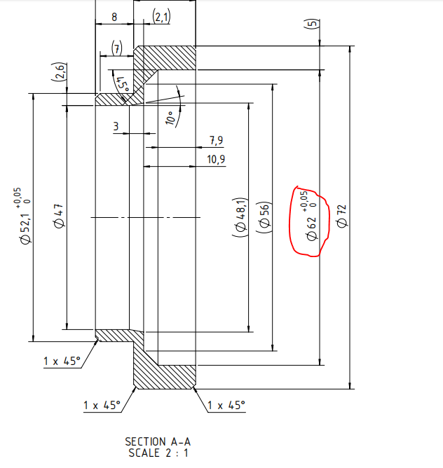

Oh, this is just a plan for Jamal's bike...for reference only.
Every bike is different and should be custom made.
With your frame and this sketch you could find in you own town somebody that has a lathe. For him it will be simple but you need also Acros headset for bearing and lower crown.
First make your calculations because it will be not cheap. In my case a friend made it in 15 min for free zo just yhe Acros headset price only.....

If you used IS60 bottom cup, shouldn't this measurement be 60mm?
