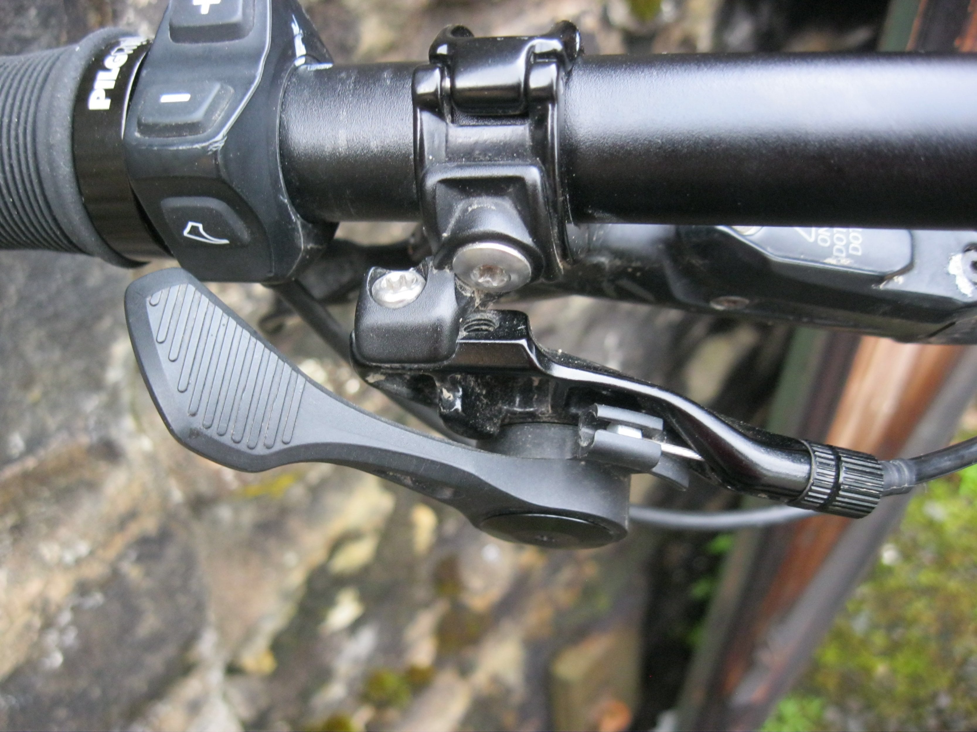

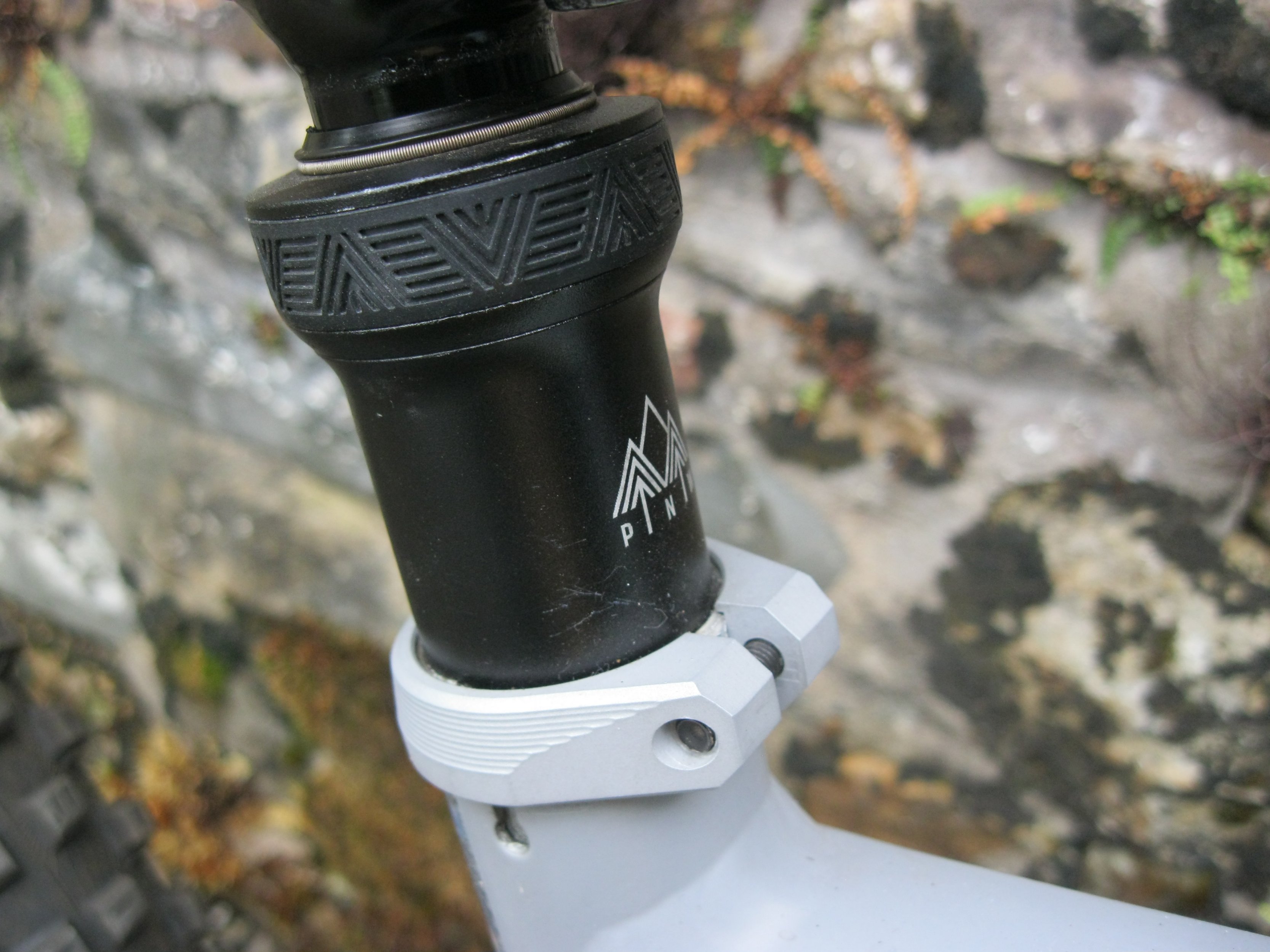

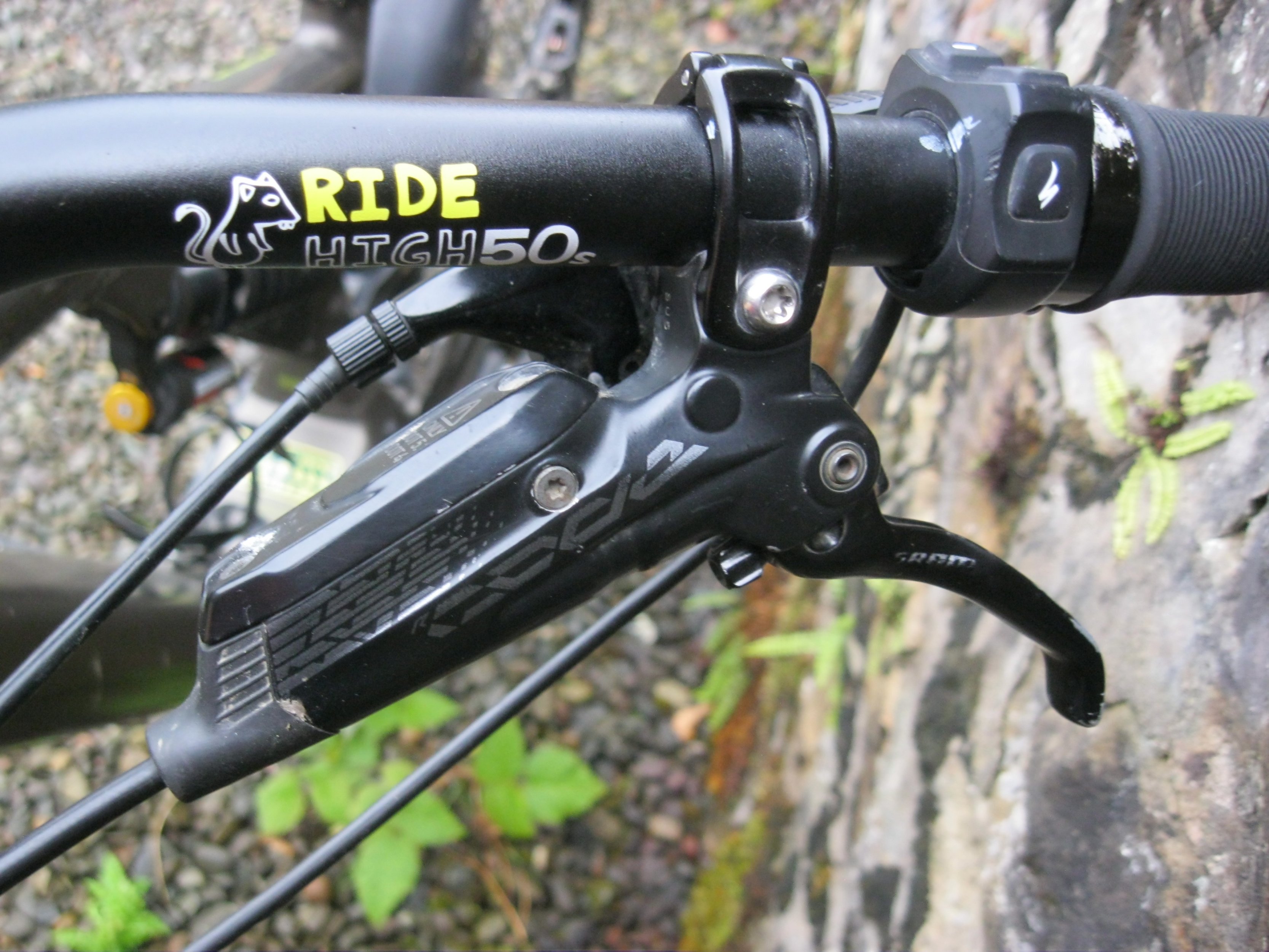

here is the Kenevo set up, a manic fusion dropper with that janky dropper lever fitted to a Sram code r brake lever

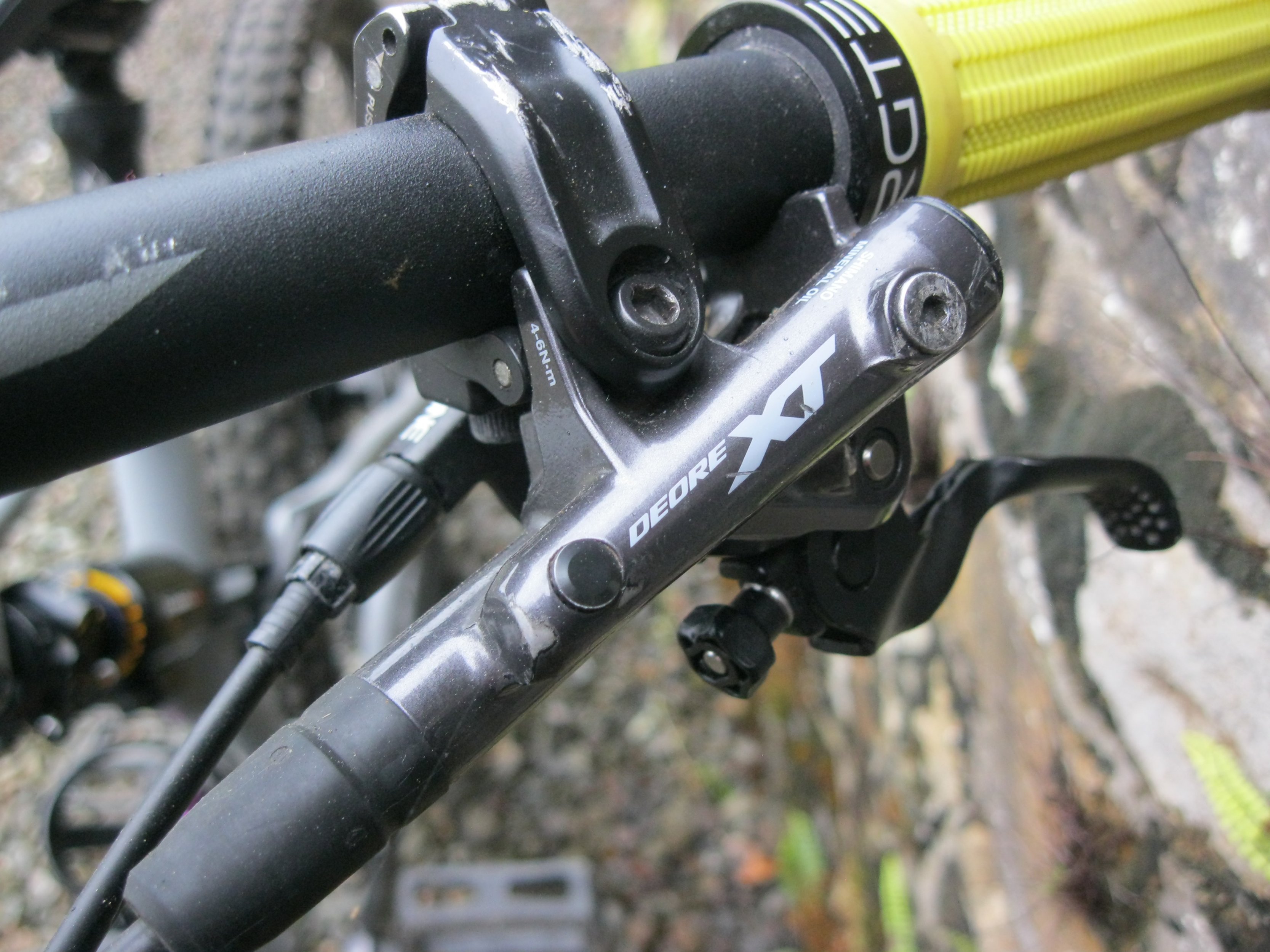

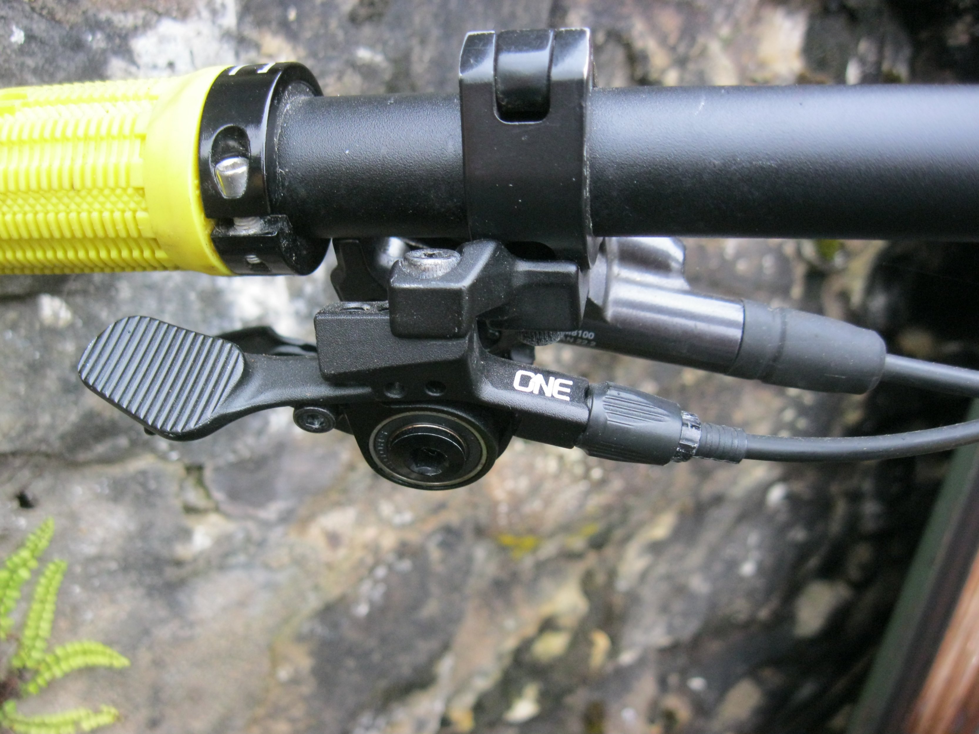

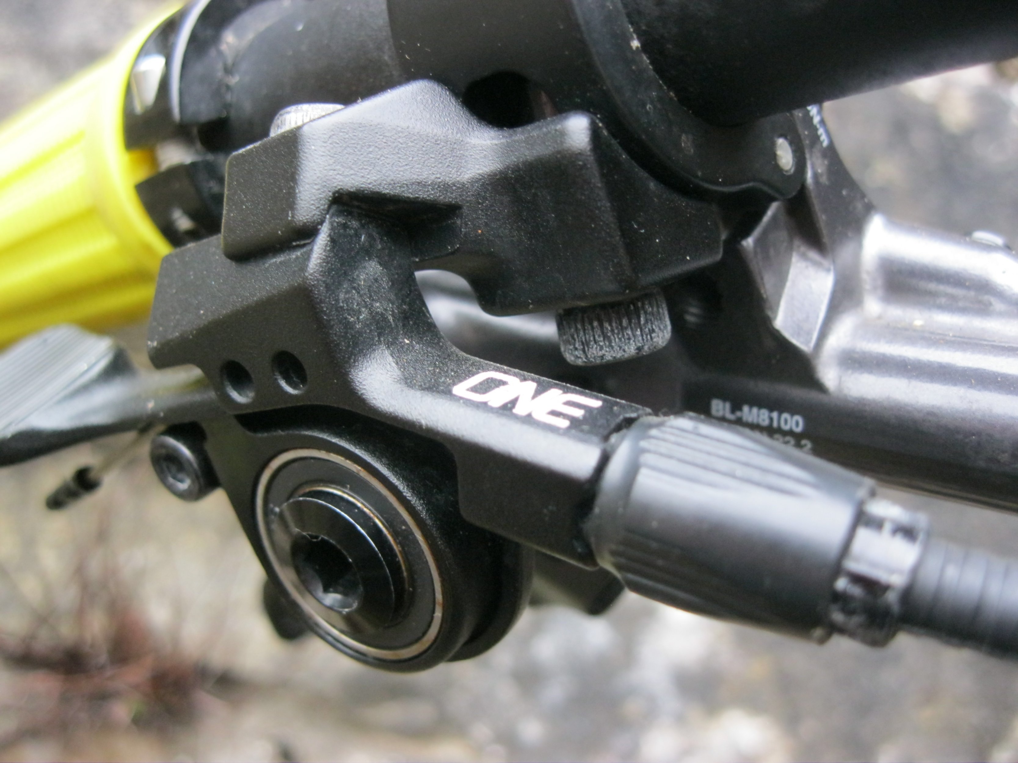

and thats the set up on the stumpjumper, a pnw dropper with a one up dropper lever attached to a shimano xt brake lever
i wanna swap this whole system (pnw loam dropper with the one up dropper lever) and put it on the Kenevo's Sram code R brake lever and vice versa i wanna put the crap manic dropper lever on this xt brake lever, but will the crap manic dropper lever fit this xt brake lever? do i need matchmaker fittings to make the levers fit together? They do already have some sort of fittings on them but im not sure if they are going to be correct???
i dont think its gonna be a straight swap, but id be happy if i knew what parts would make it possible, maybe im wrong and its just a straight swap over, this is my question!
