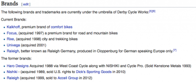

Actually it very well could have something to do with BMZ. The fact that it uses LG cells, which BMZ is heavily aligned with LG, and the fact that it is made in China where BMZ has one of the largest battery manufacturing facilities at this time. Derby GMBH is just another branch of PON Holdings, the parent company for Focus, as well as other brands
and perhaps PON just has all their battery/charger designs done under the Derby banner with BMZ input/components? It is a tangled web in the bike industry with Accell and PON etc. having so many pieces of the game in play on the same board, a bit like Monopoly.....There is little doubt though that BMZ has aligned itself to be a major supplier of battery tech/components to the eBike industry.
Of interest aside is that Accell made a play for Derby back in 2011 but ultimately it went to PON. Derby filed bankruptcy proceedings in the US about 6 months after this. Recently PON decided to pull Kahlkoff and Focus from US distribution and will no longer supply the US so apparently the market here is not worth the hassle for them.
