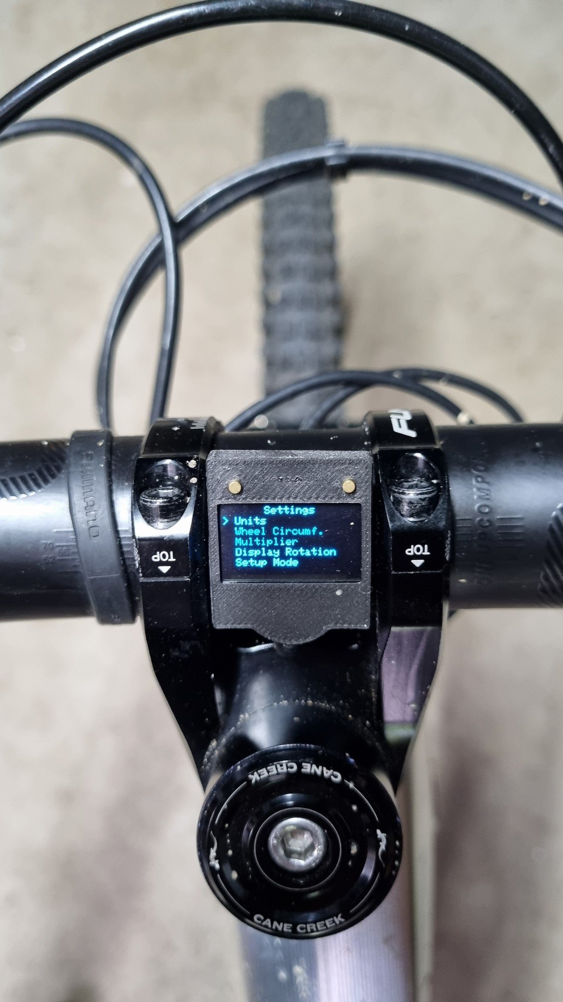

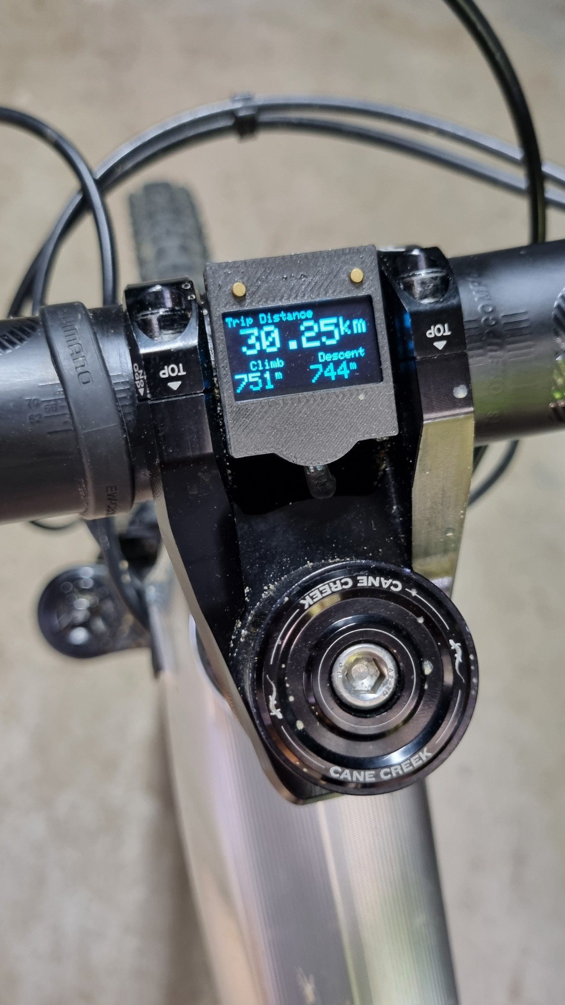

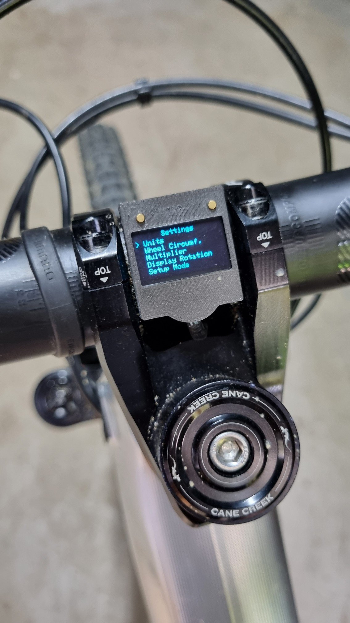

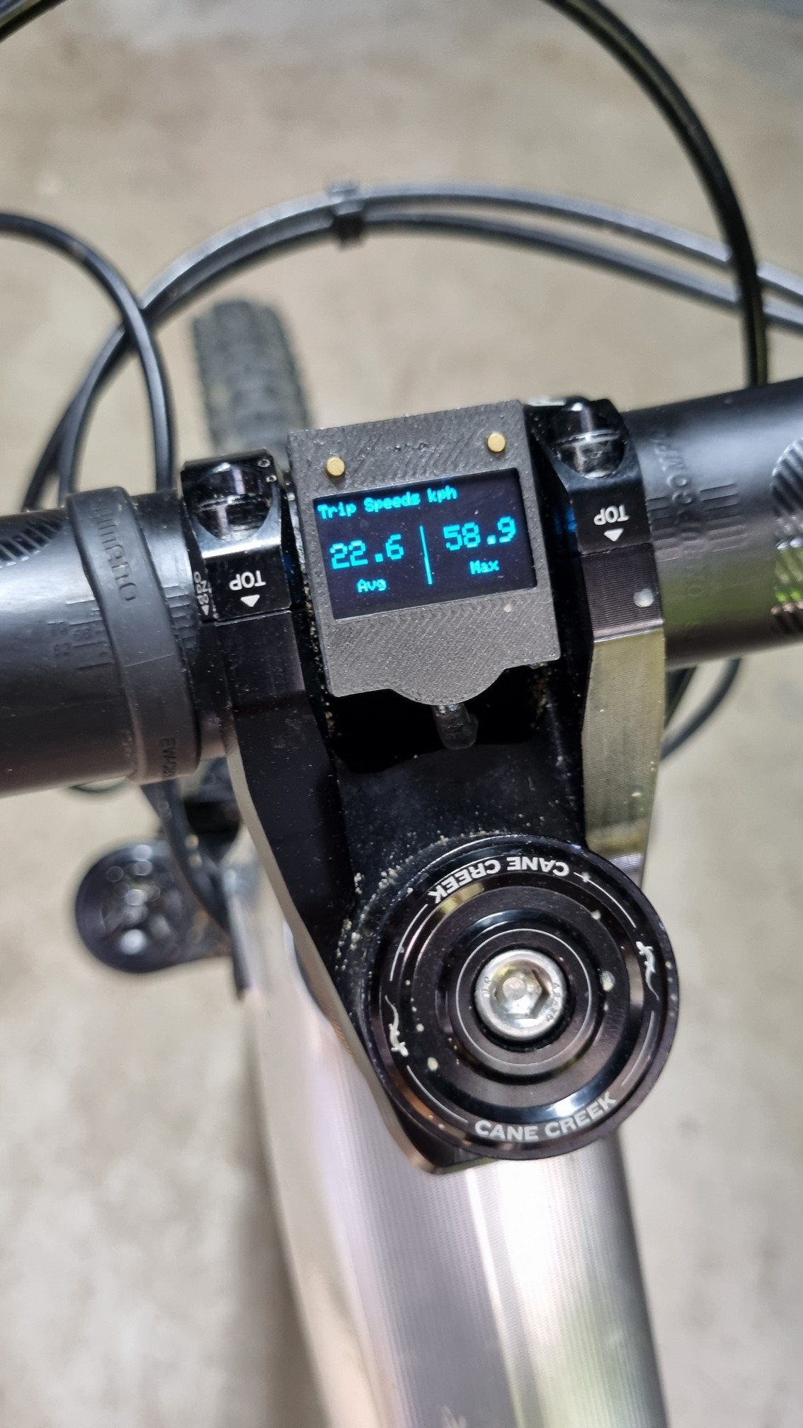

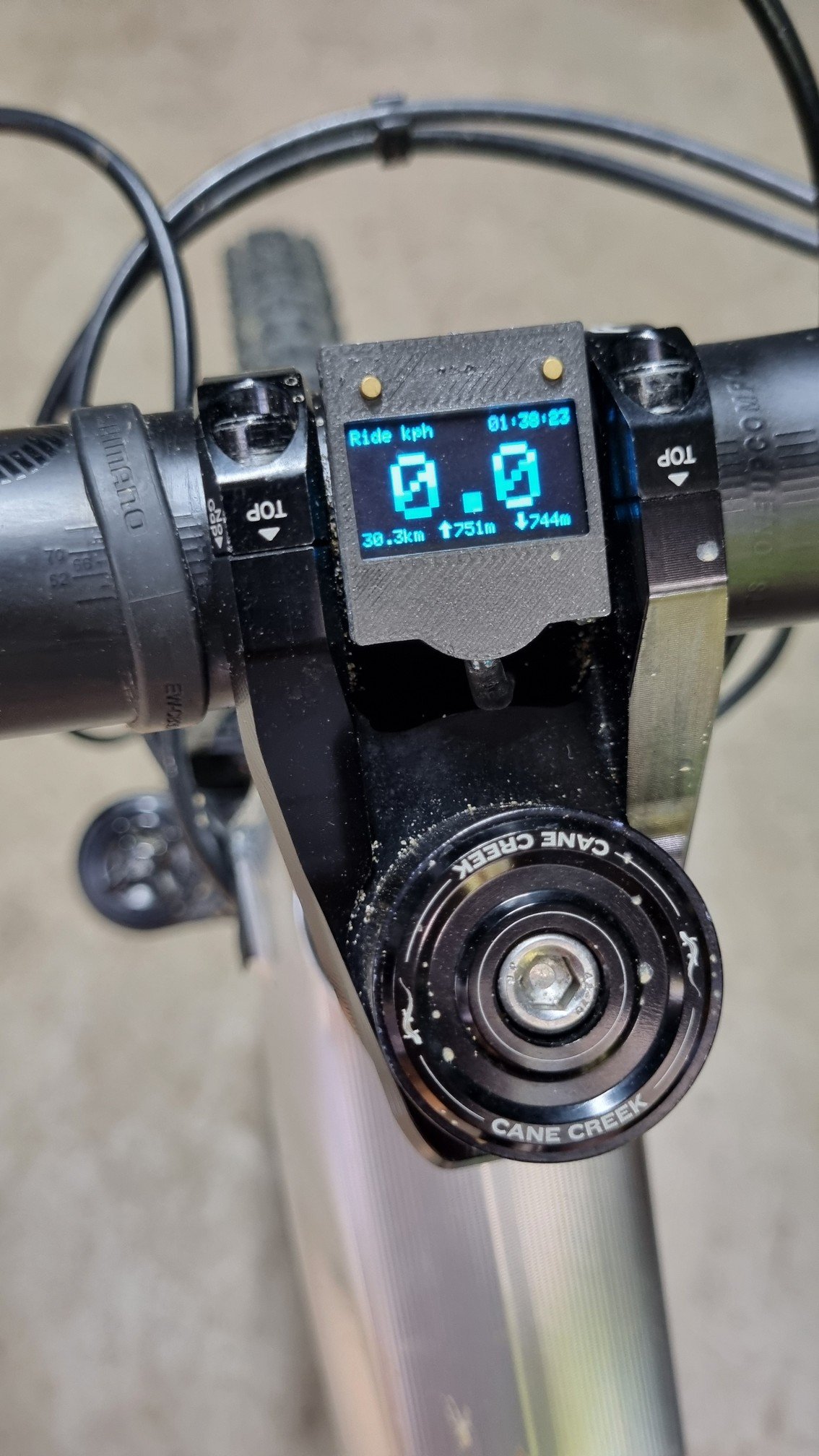

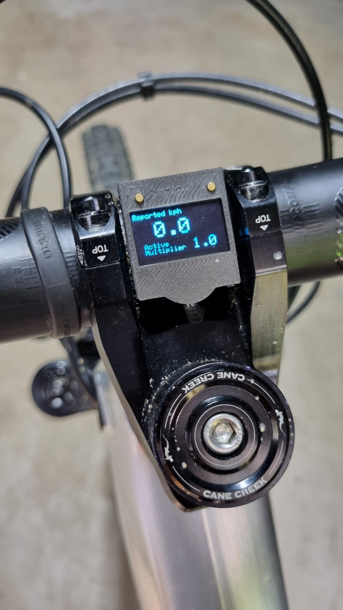

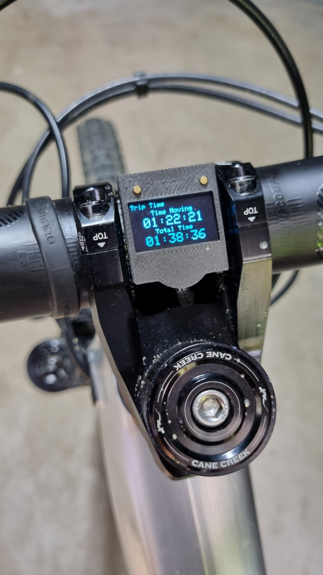

Hi guys,
I've been running my updated setup with hall sensor and new coil since early December and it's working well. Changes from the original design in the tutorial are as follows:
  • Addition of small OLED display with two buttons to show simple ride stats and allow for user configuration of the device
  • Addition of barometer to capture elevation/climb without the risk of introducing GPS to the Bosch controller
  • Switched to Hall sensor, replacing reed switch, at the wheel - solves issues around vibration and is less sensitive to placement
  • New miniature electromagnet coil
  • Several code tweaks
    • Updated multiplier behaviour. When multiplier is being introduced (or removed), it's done so relative to speed rather than wheel rotations. This allows the multiplier to be run at a partial level (say, 1.2 when your programmed figure is 1.5) when traveling slowly. Multiplier now is stepped back down when slowing, rather than simply switching off immediately. This corrects the speed fluctuations some were seeing when slowing down before coming to a stop.
    • Enhanced Setup Mode, which can now be activated via the display controls, which gives live feedback on hall sensor strength to assist wtih optimum sensor placement at the wheel.
I experimented with a magnetometer to capture the passing of the rim magnet from within the motor area. This actually works fine, with my current code allowing the user to switch between use of Hall sensor or magnetometer for magnet pickup. However, the challenge is running a strong enough magnet on the rim to overcome environmental noise (the magnetometer is just a digital compass after all, sensitive enough to be affected by Earth's magnetic field), but not so strong that the motor itself picks it up. Bosch have it easy because they just use a super strong magnet on the rim to easily overcome the noise. But the window between the noise and the Bosch pickup is just too small to be reliable. Apart from the loss of a wire to the wheel, I don't really see an advantage of this method over the Hall sensor, so that's what I've been using.
As for the new electromagnet coil, it measures ~8mm high with a footprint of 10mm. It's in a 3D printed case with flat bottom so attaches easily to the motor and is lower than the motor 'seam' (that joins the two halves) so will never have interference with the bike frame. Given its smaller size and uniform shape, placement is easier BUT it's not foolproof. For the coil itself, I've moved from 4.2v to 5v, reduced wire diameter to 0.1mm and now machine-wind around a small steel cylinder. This gives the magnetic field more focus rather than acting on the coil alone. After intial placement, I still had to move the coil once (even after a clear result in Setup Mode) but it's been solid since.
I had been planning on withholding the code/details from this update as it didn't sit well with me that the commercial players are selling the original setup for big dollars. But a post this morning from a buyer of the Speedbox 1.2b Rim Magnet showing a maniuplation error made me laugh. Even with the code handed to them they still managed to get a detection error that no one using the megabobra code ever saw!!
Anyway, I'm going to update the original tutorial to include the small change for the Hall sensor, as well as instructions for the optional stuff around the display and barometer, and of course with the new code to accompany it. The extra components add complexity and can be a bit fiddly to put together, but if anyone's up for the challenge, please do give it a go. There's certainly room for improvement: there's no waterproofing around the screen!
Finally, some photos attached of the display. It's mounted in between the arms of my stem so it's fairly tucked away. Visibility is fine in all but direct sunlight.
Image00002.jpg Image00003.jpg Image00001.jpg Image00006.jpg Image00005.jpg Image00004.jpg Image00007.jpg
