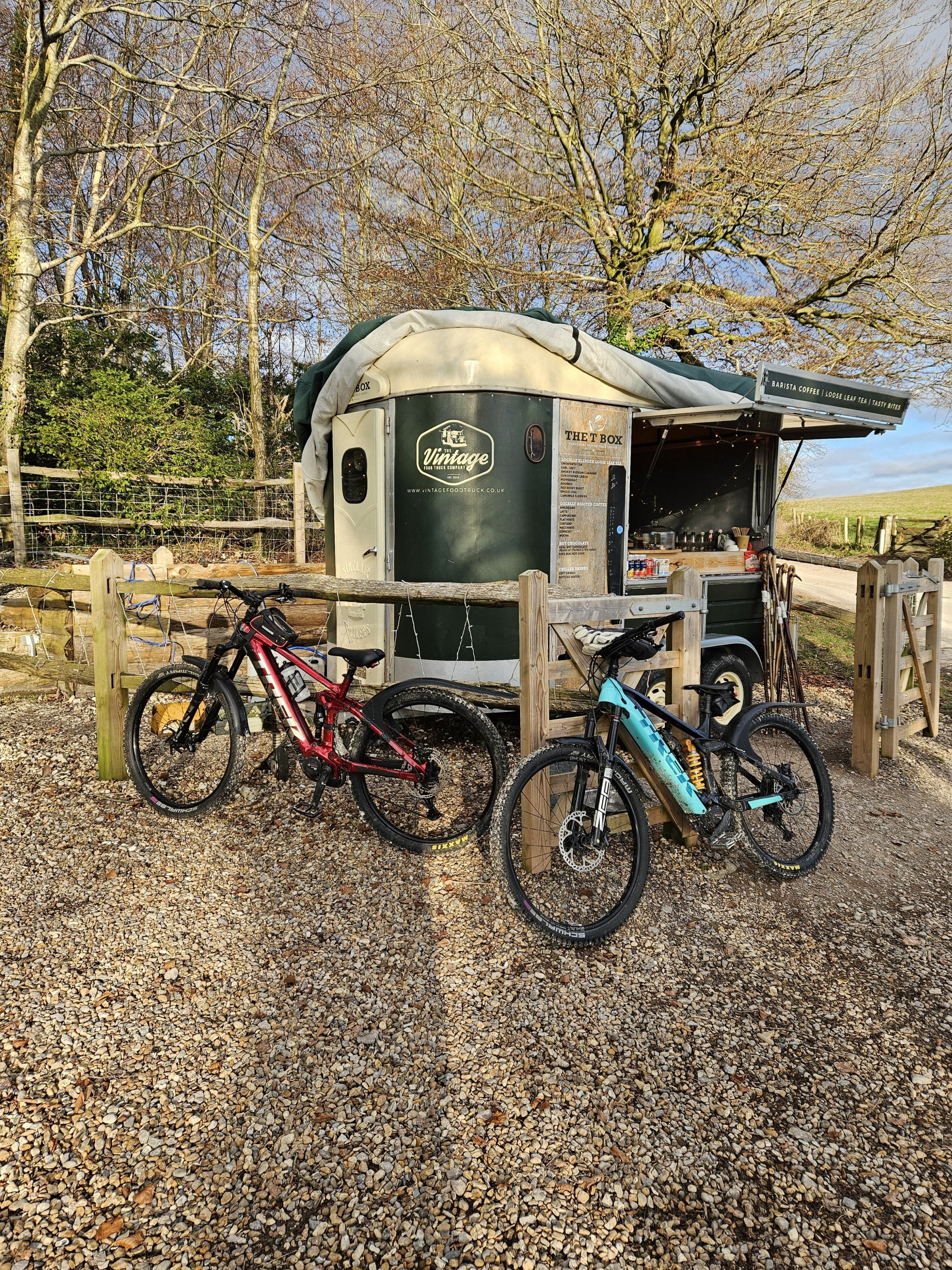

When I got my Large Rail my wife wanted a go, came back after 5 minutes and said "I want the same bike but a bit smaller and a nicer colour".
She has a Medium Rail in crimson below, mine is the Miami green bike.
I wasn’t going to mention anything but …when I saw your bikes.
