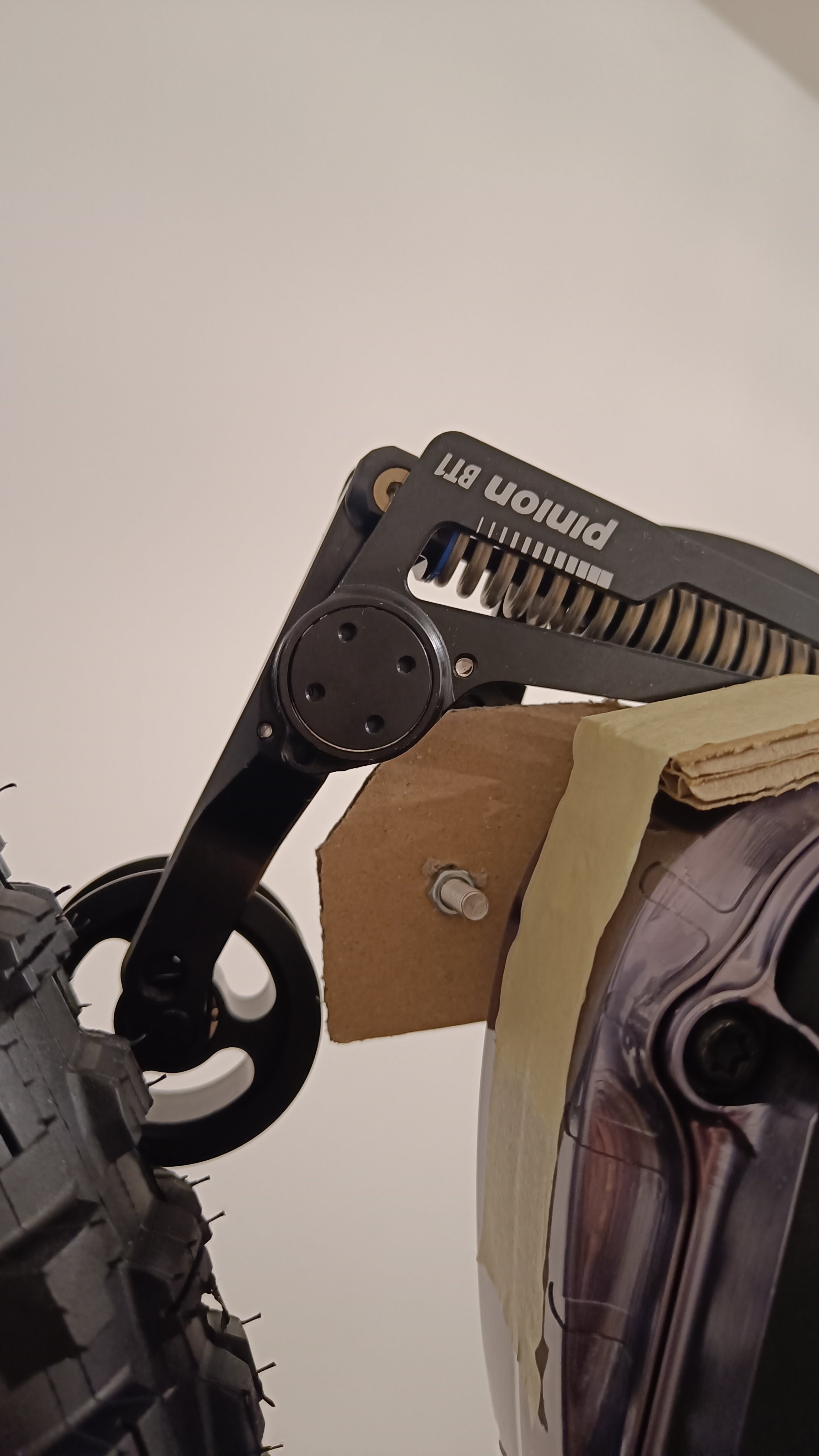

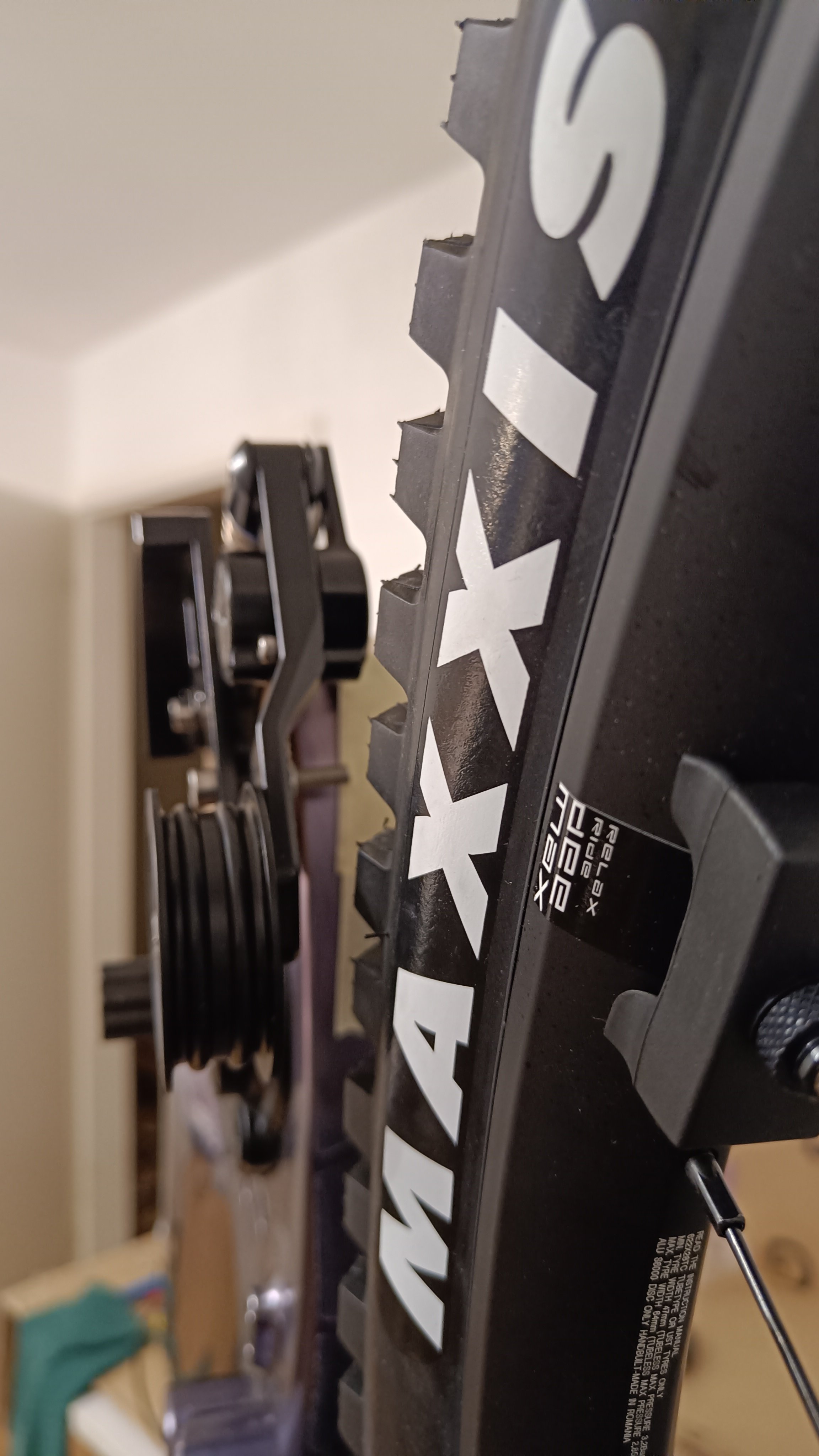

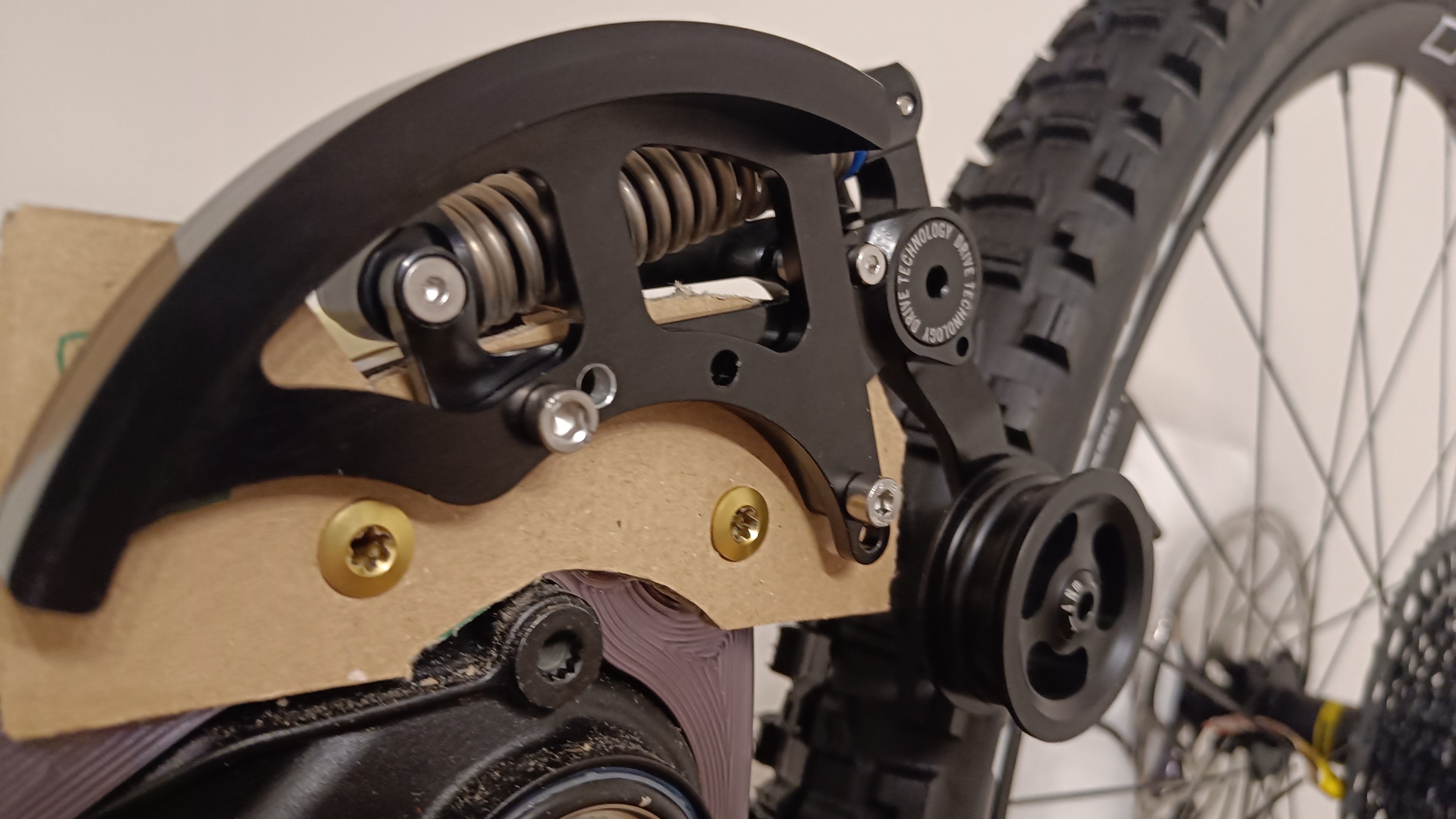

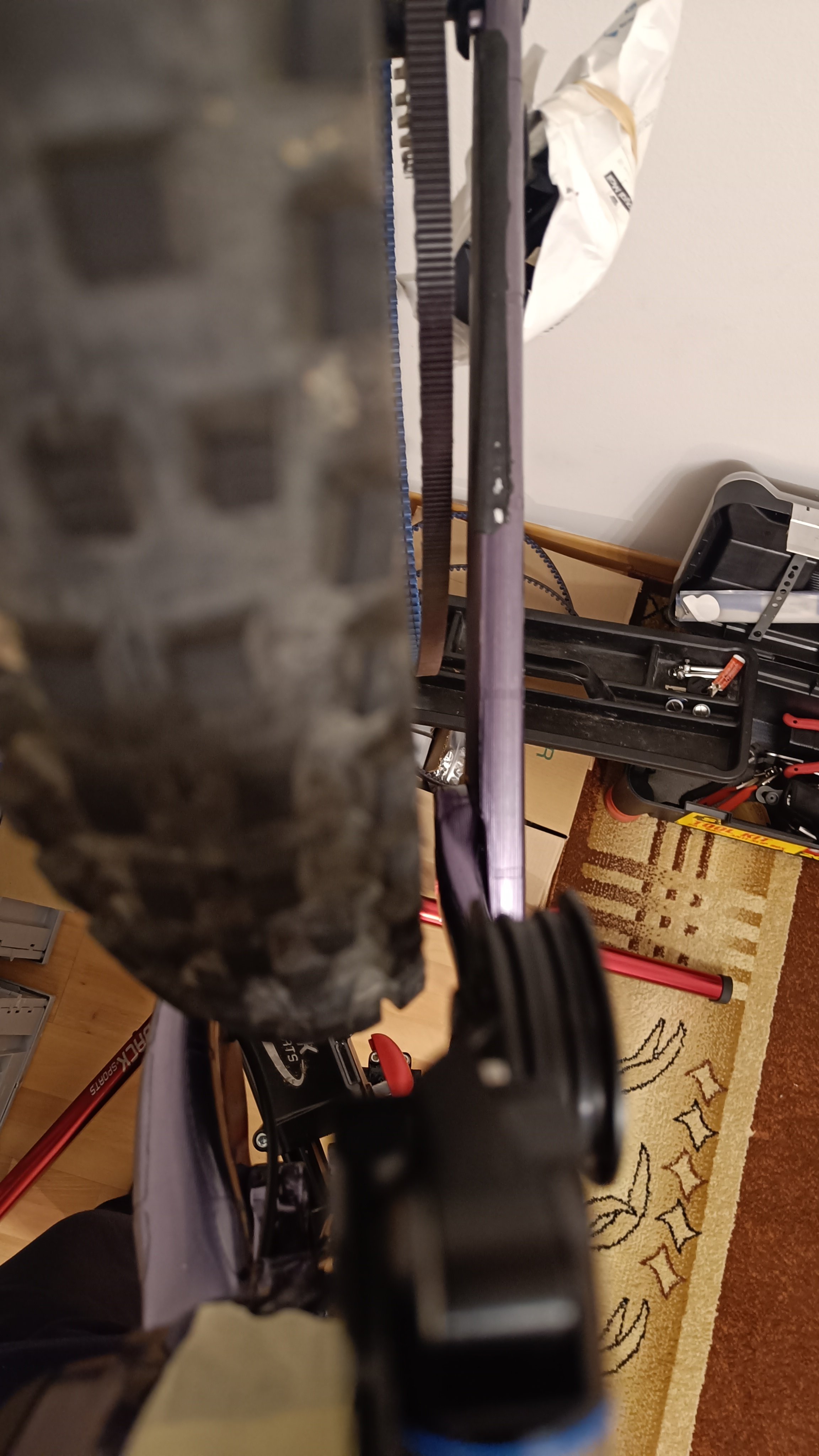

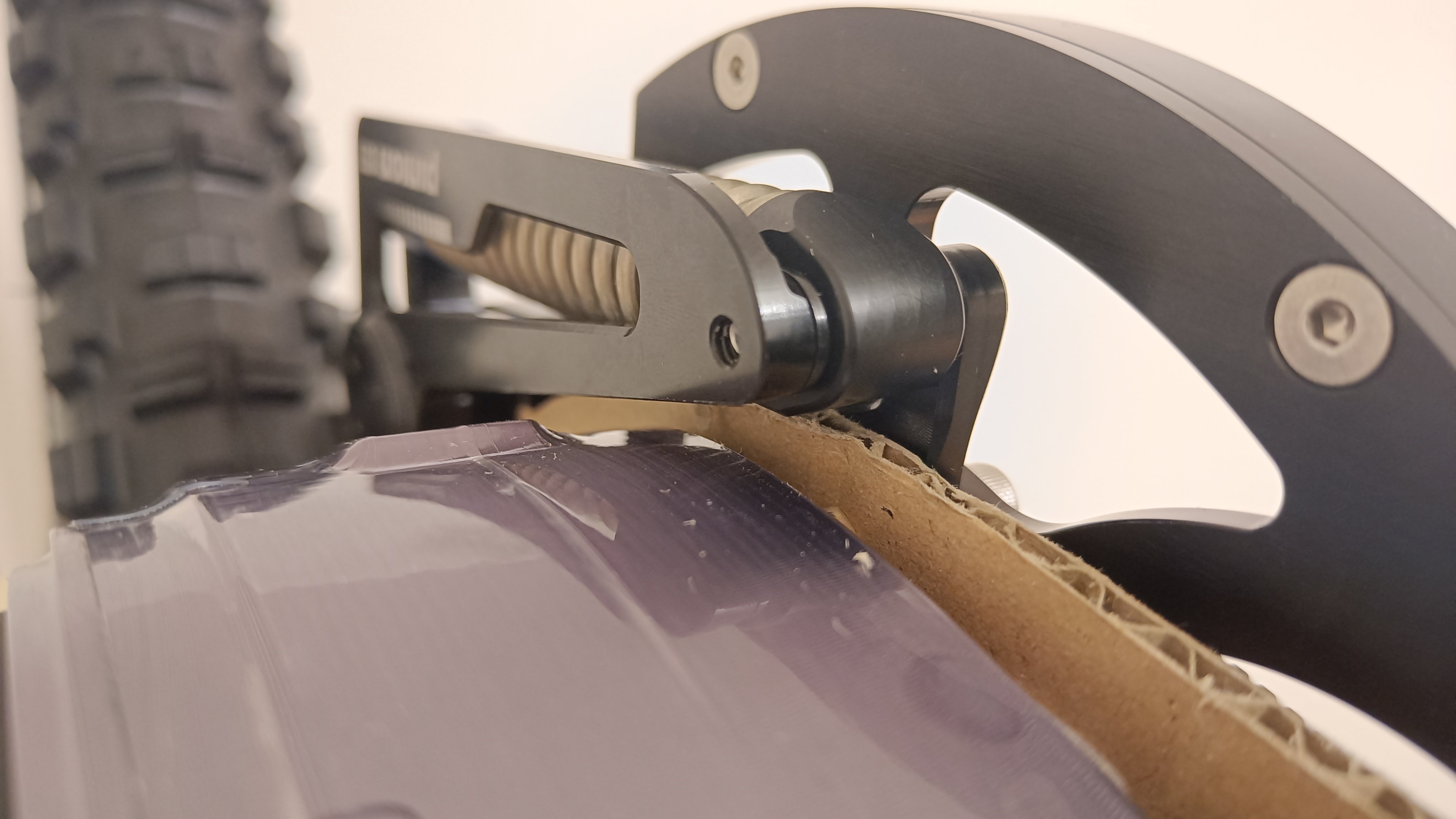

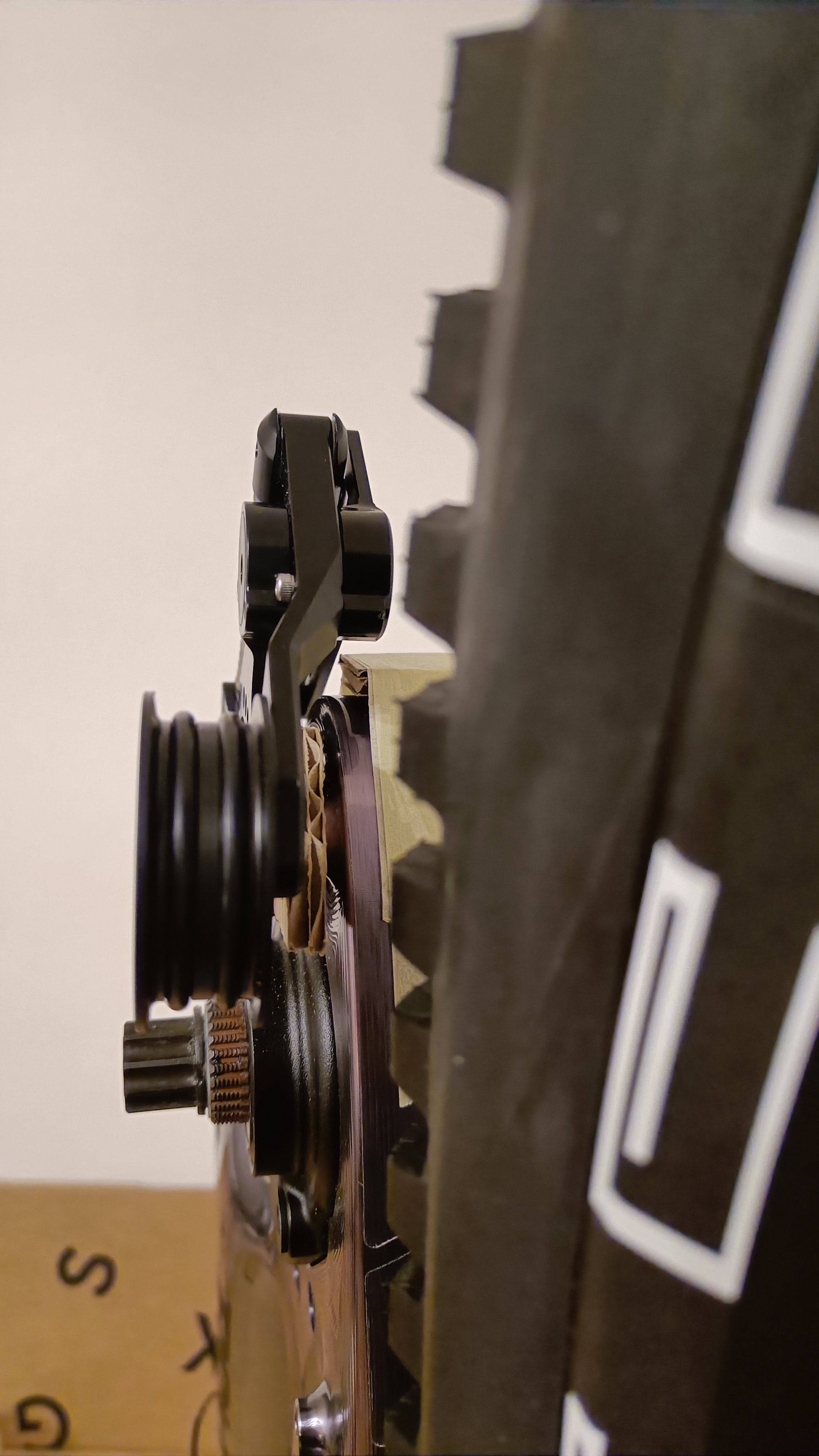

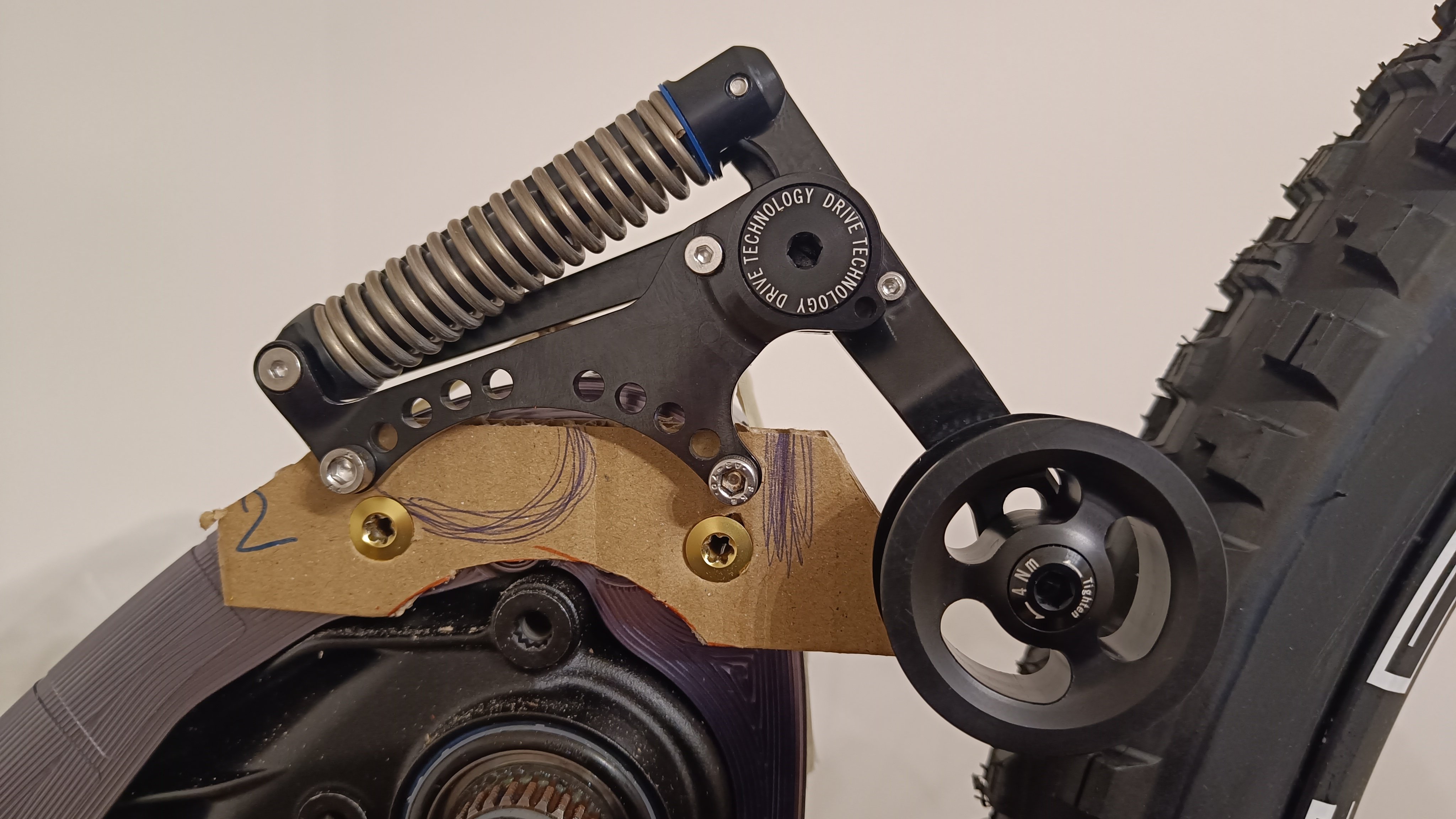

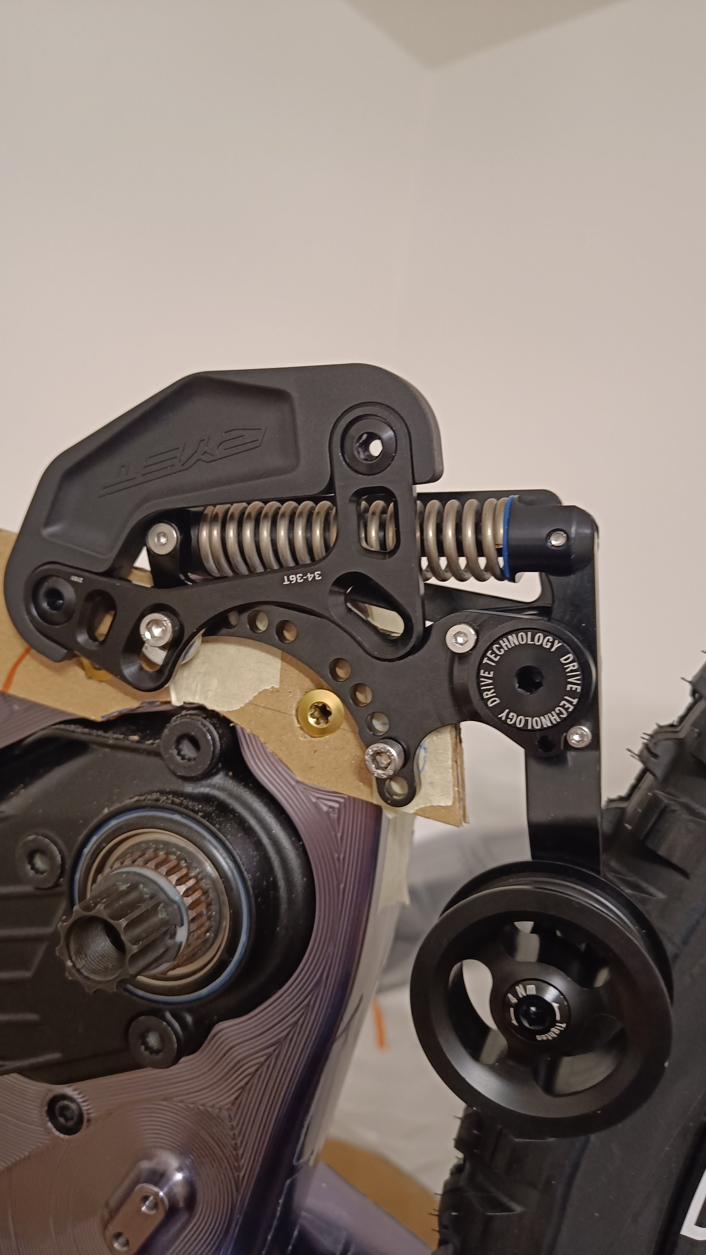

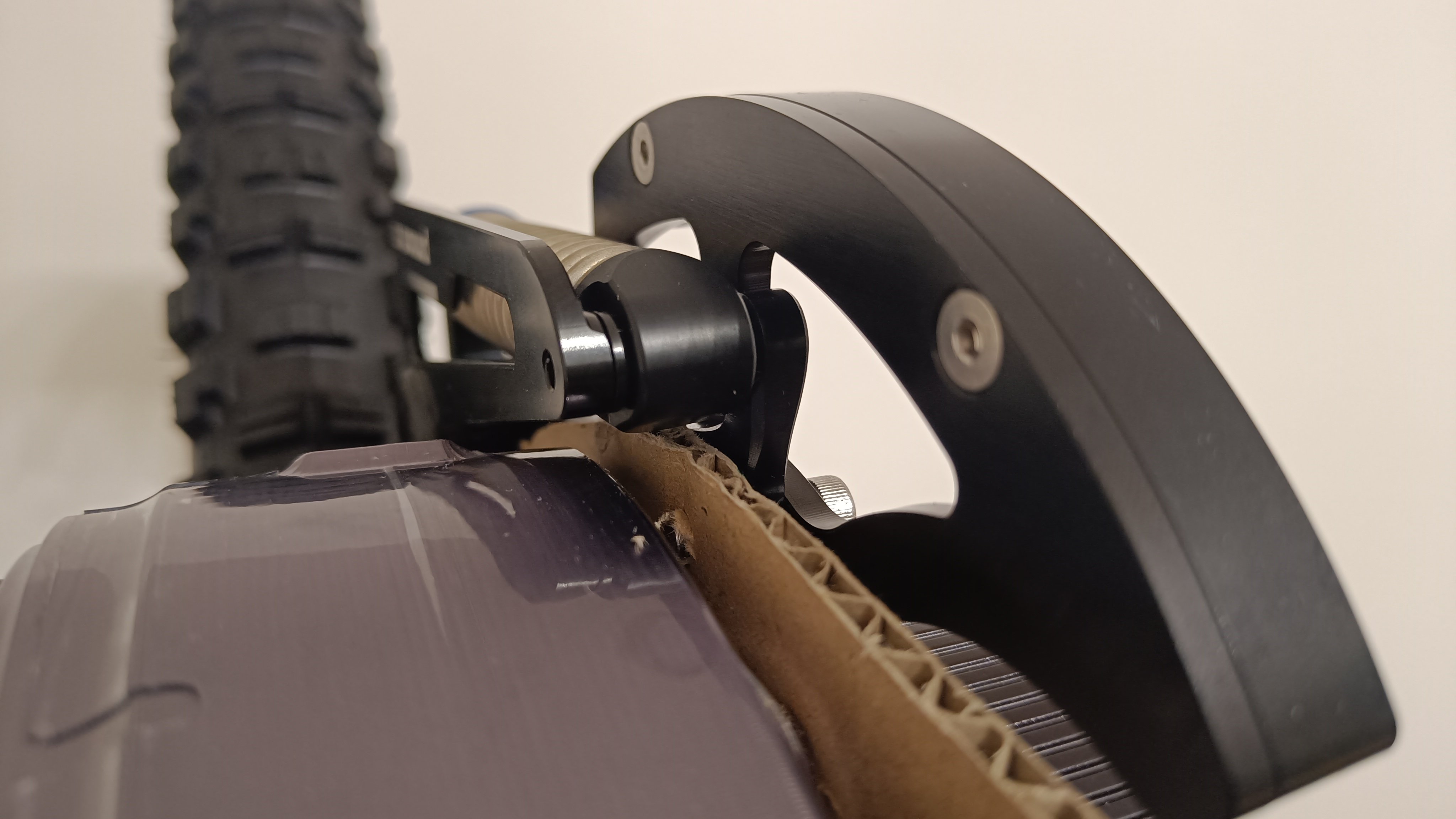

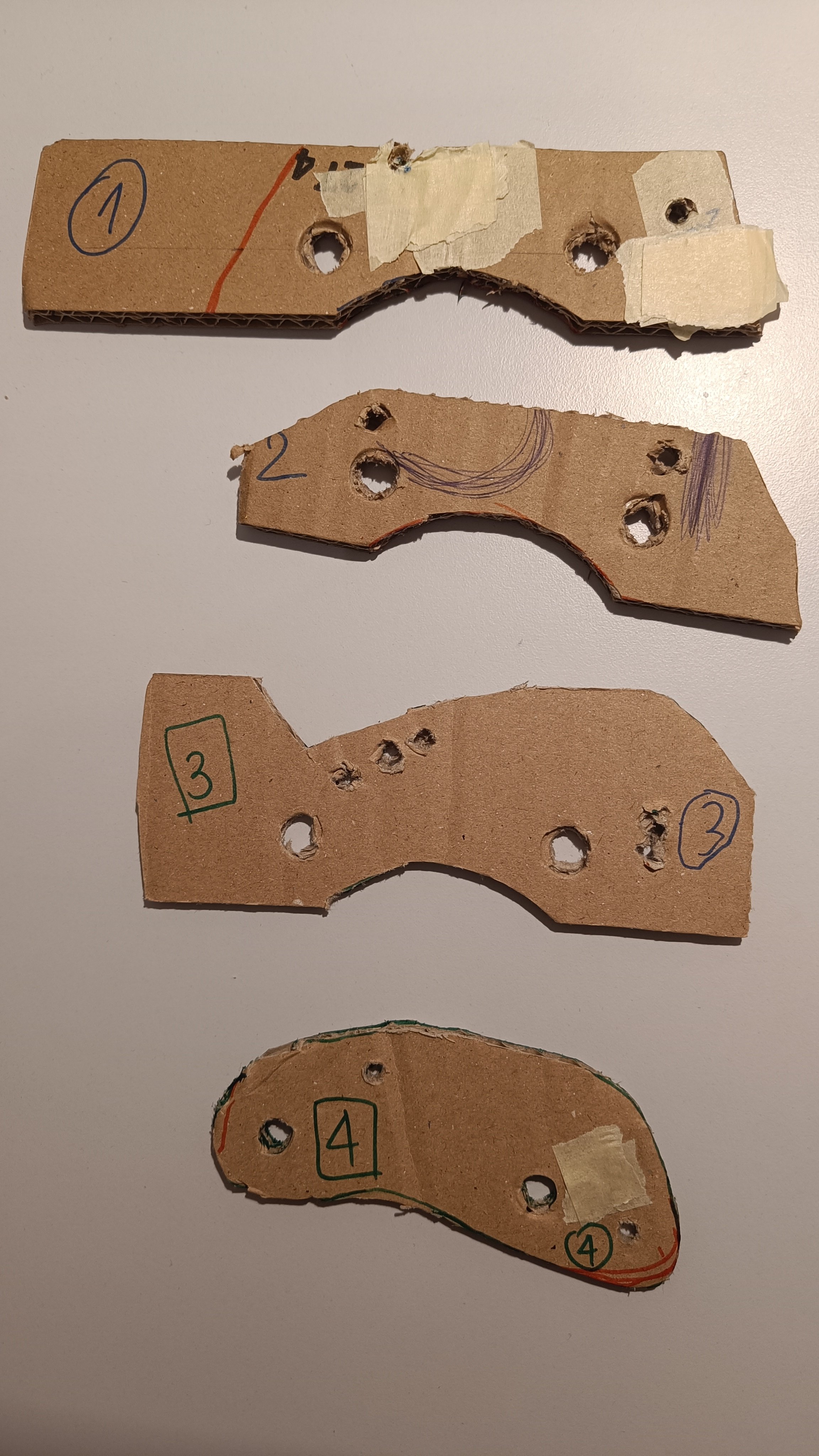

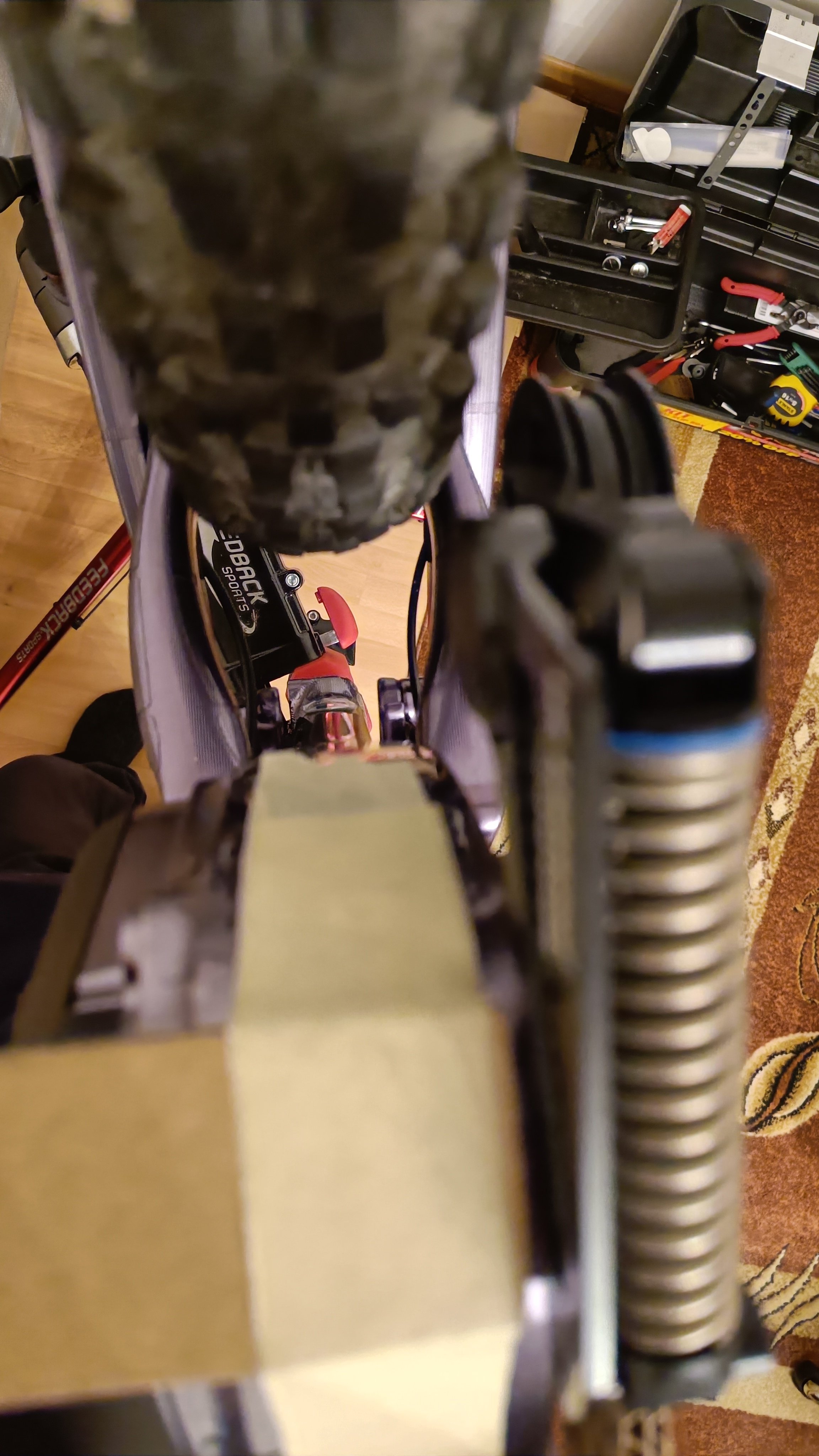

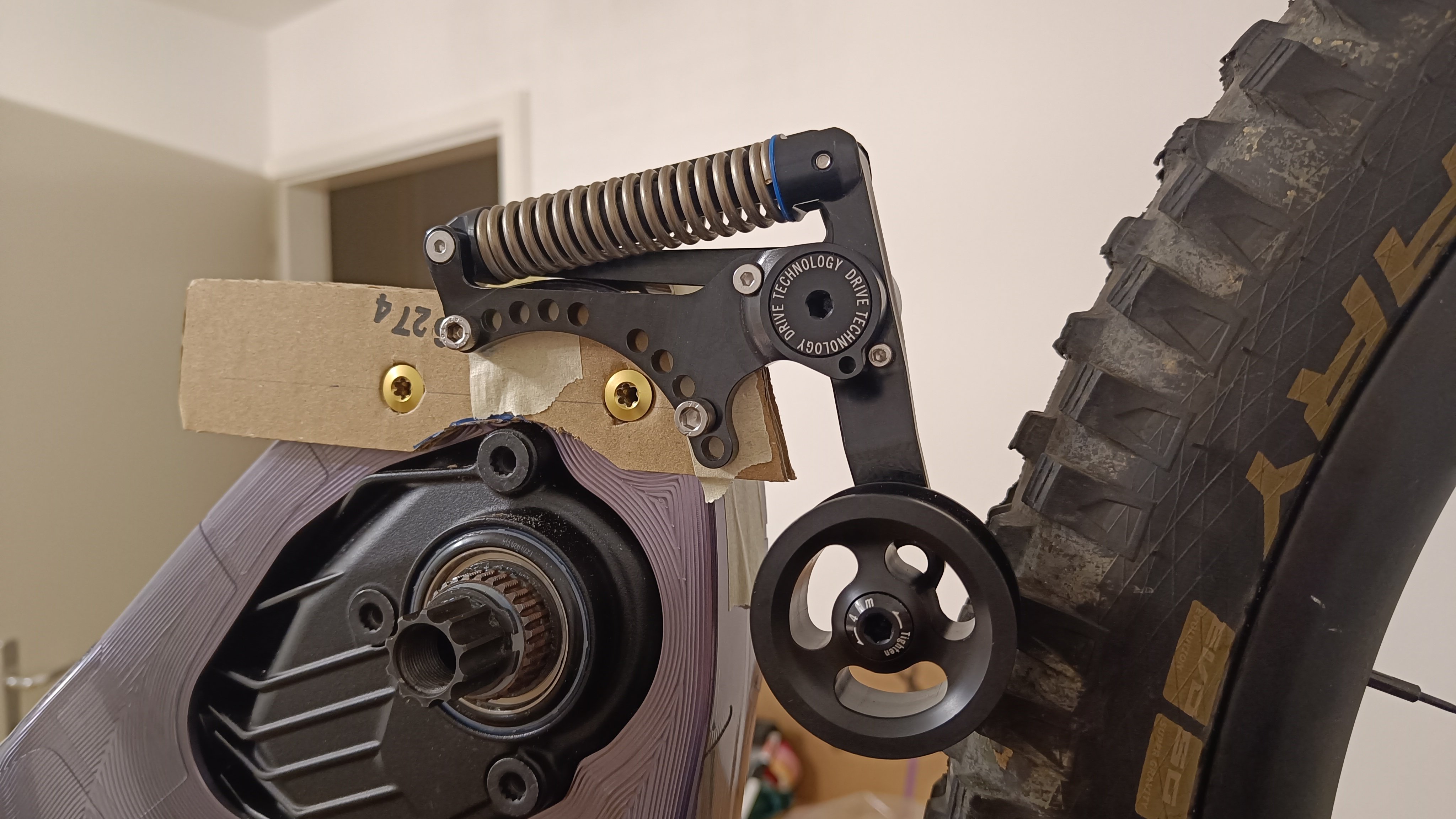

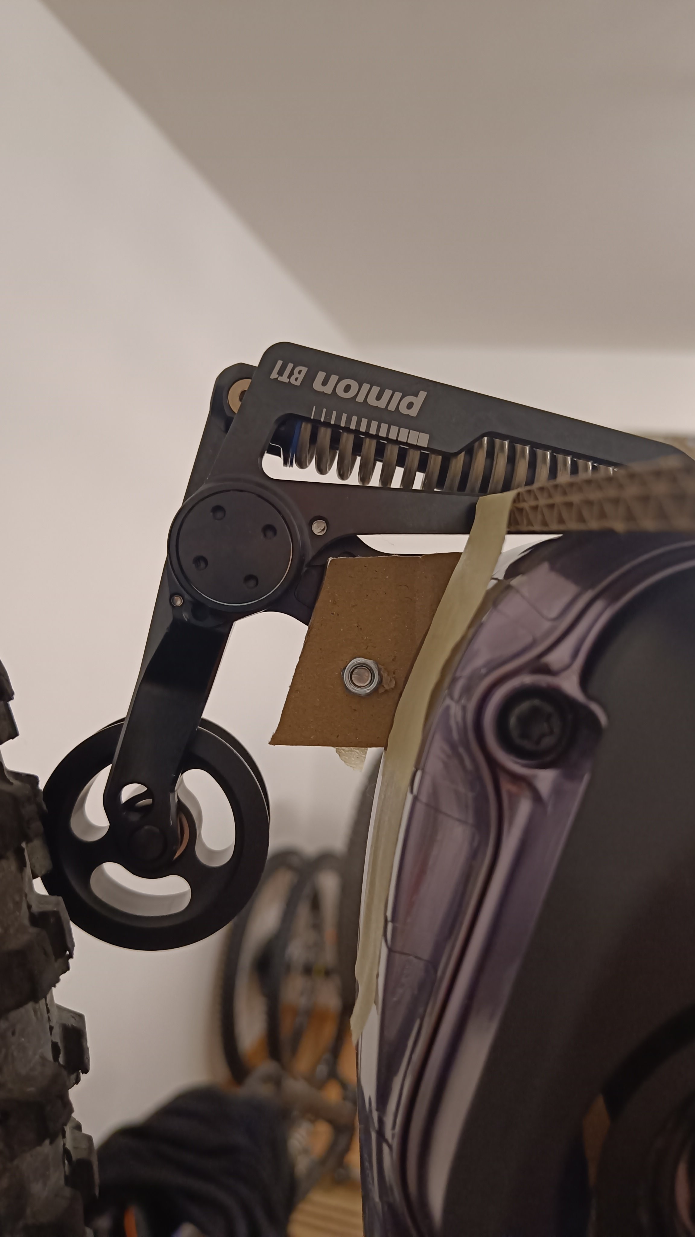

Welcome everyone and a Happy New Year 2024!
Indeed I have been on the case to somehow buy these.
For Voima, it would not be a straight fit. An adapter would have to be made. Since I do not have access to 3D printing or a professional machine shop, I guess the process would consist of (1) CAD (cardboard aided design) prototyping; (2) plywood or hard piece of plastic testing; (3) aluminium plate hand cutting, shaping and fit testing; and perhaps (4) designing something in some sort of CAD software. The final stage would be getting this laser cut.
However, since I do not have access to a professional shop, I am likely to stop at step 3. Good enough for me, though. One tiny issue here, I would need to have the tensioner in my hands, which proves to be a massive problem right now.

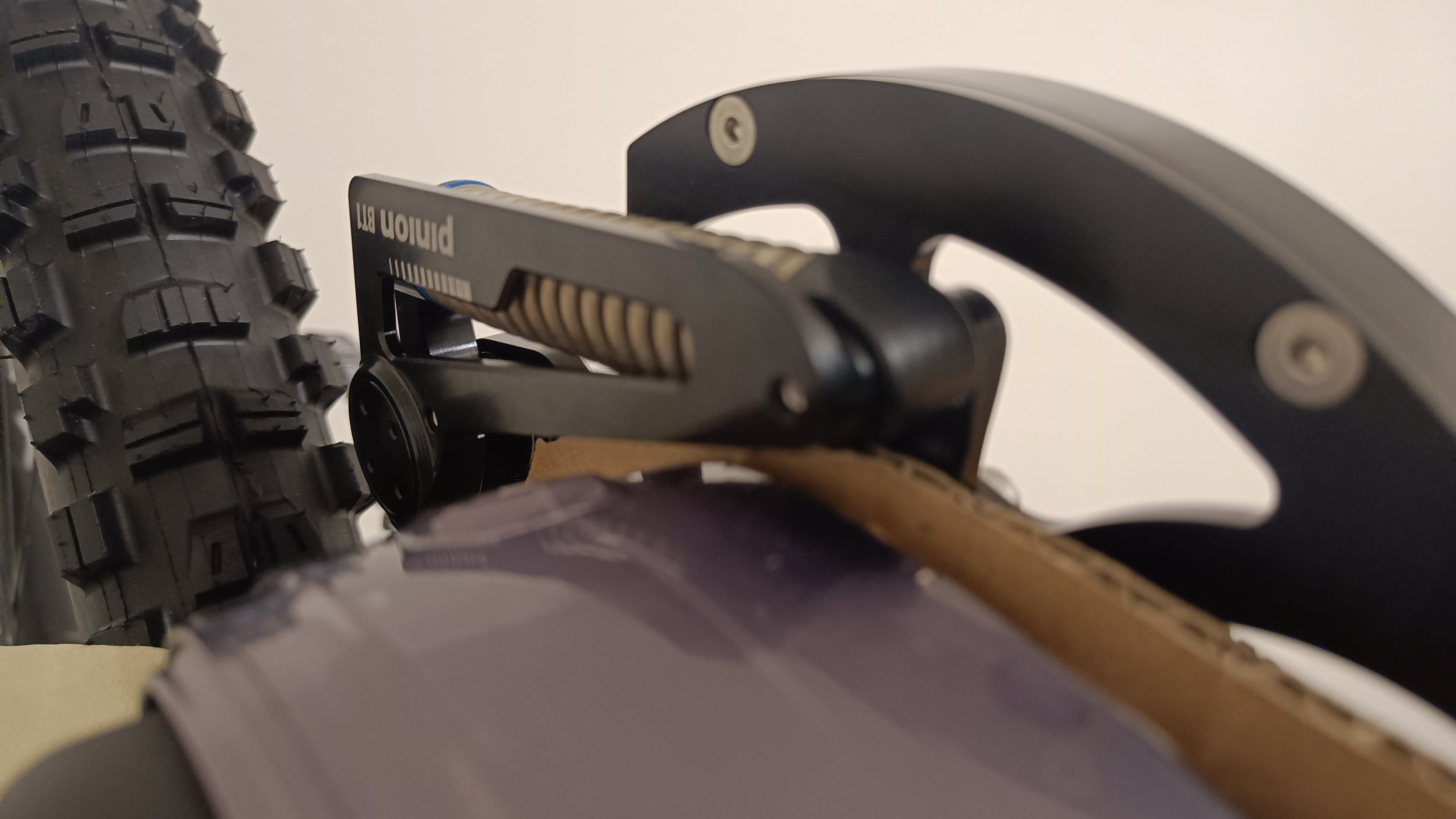

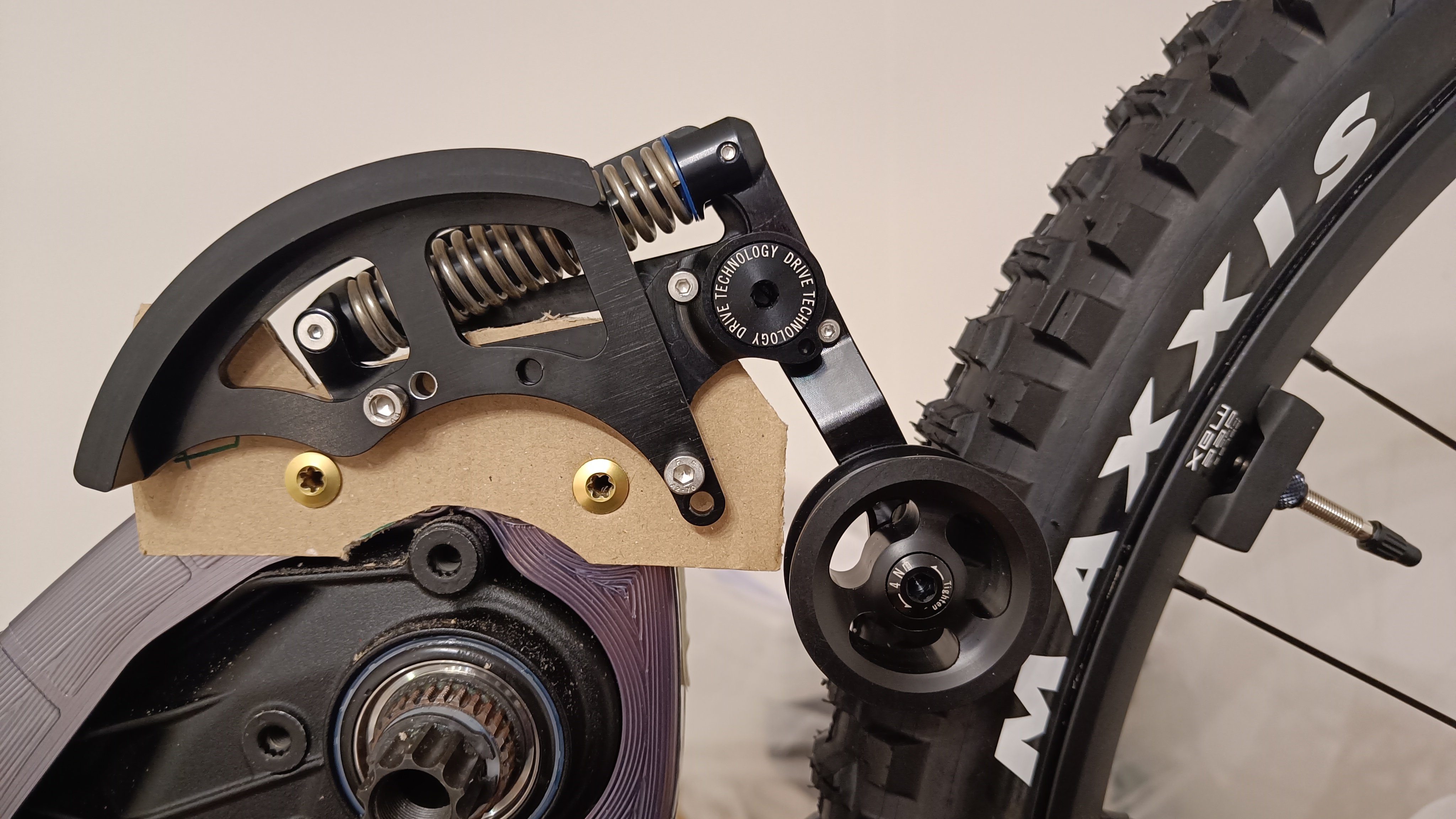

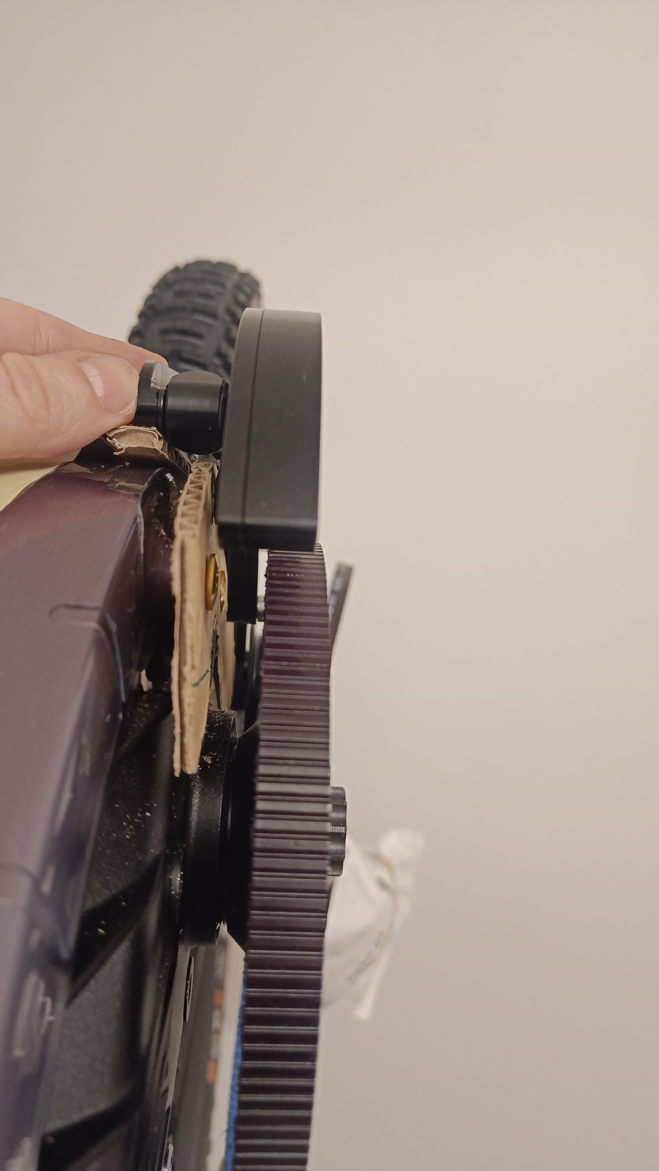

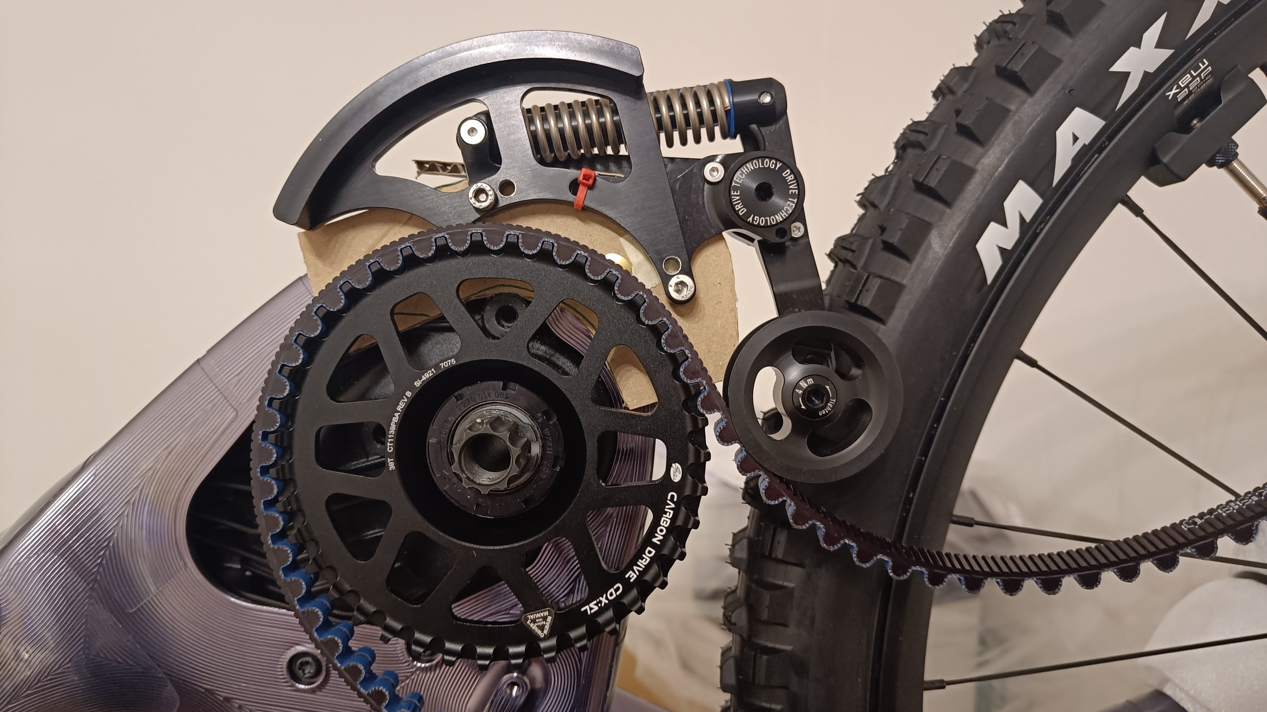

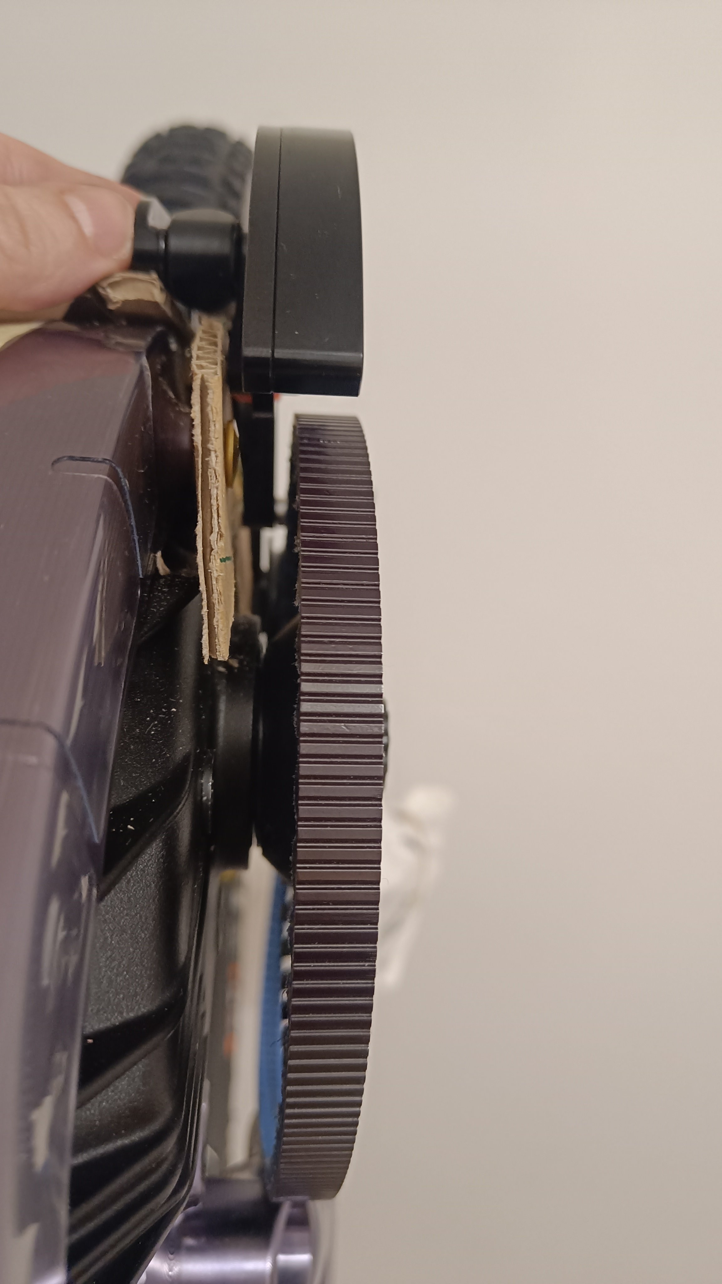

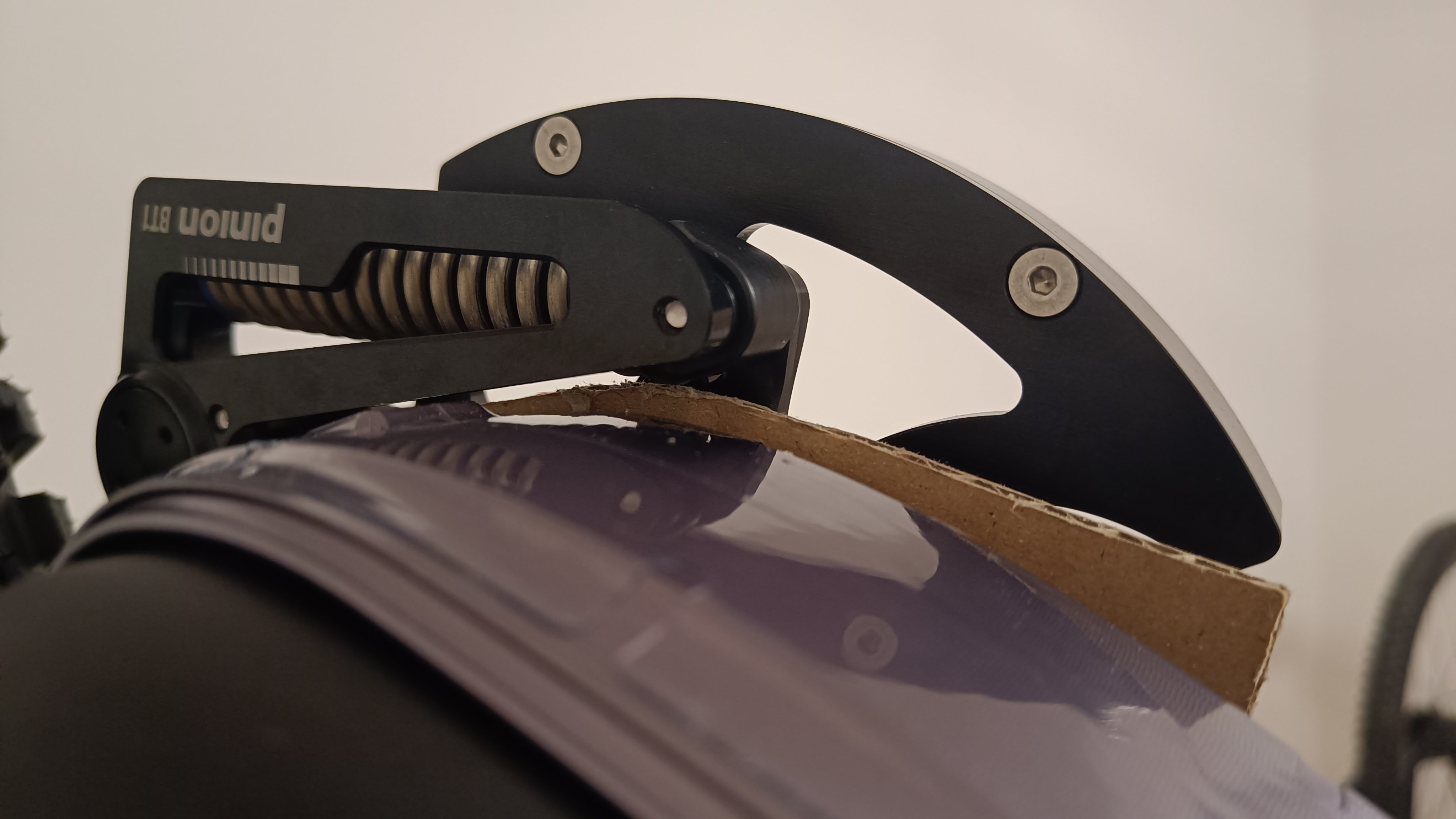

For your entertainment see below pictures of the stage 1 (CAD prototyping) of the Pinion belt tensioner in action (this would might end up being fitted to my belt driven Nicolai bike):
So far four prototypes :)
The Gates belt tensioner would be a more elegant solution but that is not happening for obvious reasons. Above all, it would be better protected between the frame and the wheel.
Any constructive feedback is welcomed.
View attachment 132007 View attachment 132017
Kudos tooFat. Excellent progress which begs the following:
  1. BT1 is an available tensioner that can be purchased now, unlike the Nicolai tensioner at the moment.
  2. Arguably this tensioner might be better for the Voima than the Sonni, simply because it is not transverse mounted like the Nicolai, which, in my self-serving need to support the Sonni, has been what I've been pushing for thus far.
  3. To me the biggest BT1 design flaw is it's undercarriage exposure, but that huge bash guard would definitely help!
  4. So is #4 design that latest iteration of what is needed? That is only a single plate adapter is required?
  5. The material you end up using might be dependent on getting your chainline aligned. Fo example hi-impact plastic could be used if it needs to be thick to counter a larger chainline difference. Or steel if the opposite is the case. Or aluminum if in between.
Keep dem updates coming.
Re 1: Indeed, this is why I could start prototyping. I have the tensioner and a bashguard in hand. Even from the stage when I was just visualising, having it in hand made some realisations. For example, I would have wanted it to sit closer to the engine axle but there is not room.
Re 2: The Gates tensioner would most likely be a better solution. If the adapter is well designed, it could be positioned right behind the frame, in front of the rear wheel. The exact coyld be achieved with the grass-roots type of engineering involving pieces of cardboard and plywood but it takes time as it is my first foray into this high-tech area :)
Re 3: In my view the tenstioner without the bashguard would end up smashed in no time, although I am rather careful with my riding in a rocky environment.
Re 4: Design No 4 is the latest based on cardboard. The next stage will be with a 5mm plywwod. The cardboard stage was just to have a basic shape. Unfortunately it lacks ridigity even though it is a thick piece of cardboard. Plywood should provide ridigity so that I could check what thickness would be required. I have three thicknesses available to me: 5, 7 and 10mm. This should help me with the alignment.
Re 5: The cheapest and easiest to work on without access to 3D printing is an aluminium sheet. These are available in a variety of thicknesses so it should help minimalise the use of shims to align the entire setup.
Once I have the template ready and the adapter cut-out, the first weeks/months the bike will be run as a single speed as this is how I could test it. The rear wheel hub things takes forever to organise so at least I will be able to test the belt length (have three belt option ready and waiting) and its tension, which appears to be crucial for longevity and performance of Gates belts.
I hope to start prototyping with plywood this weekend. Let's see how this goes.
Prototyping continues. Not pretty or fancy, but should do at this stage.
Excellent progress. So how's the chainline looking with this piece of plywood?
BTW, what an cool idea to go single speed to get the tensioner mechanics worked out before committing to a internal gear hub setup. Even better, you could get a sense of what a single speed Voima would be like to ride. Or a 2-speed setup with something like Powershift if they had a single speed adapter available.
Houston, we have a problem.
Today I have received the 122T belt. So far I have the following belts: 120T, 122T and 125T.
The problem I discovered is the chain growth:
  • The 120T belt is too short. Nothing to add here.
  • The 122T belt is slightly too long when the bike is unweighted. Yet it is too short when and no full wheel travel could be achieved.
  • The 125T belt is too long when the bike is unweighted. It allows, however, the full wheel travel.
I suspect the chain growth is too great for the existing setup (Pinion BT1 chain tensioner, 39T front sprocket, 34T rear sprocket).
So far this is a bike stand-testing. Next week I will have my forks ready so once they are fitted, I will test the system with my own weight. I do not expect different results but I want to confirm it.
So, it is time for the collective brainstorming. What to do here? Any thought and/or suggestions?
Potential solutions:
In both videos a full wheel travel was tested to see if (1) the belt's teeth do not touch at zero wheel travel; (2) the belt tensioner was still able to extend (squeeze the spring) at a full wheel travel; and (3) the belt was long enough at a full wheel travel.
Prototype 6 was ok-ish at test 1, and passed tests 2 and 3.
Prototype 7 passed all three tests.
I still need to test the belt tension with the Gates app.
Still nowhere near a working solution but that's just the nature of prototyping. The true difficulty will start when the shape and length of the tensioner arm established. At present time I have no idea on how to incorporate it into the existing belt tensioner.
