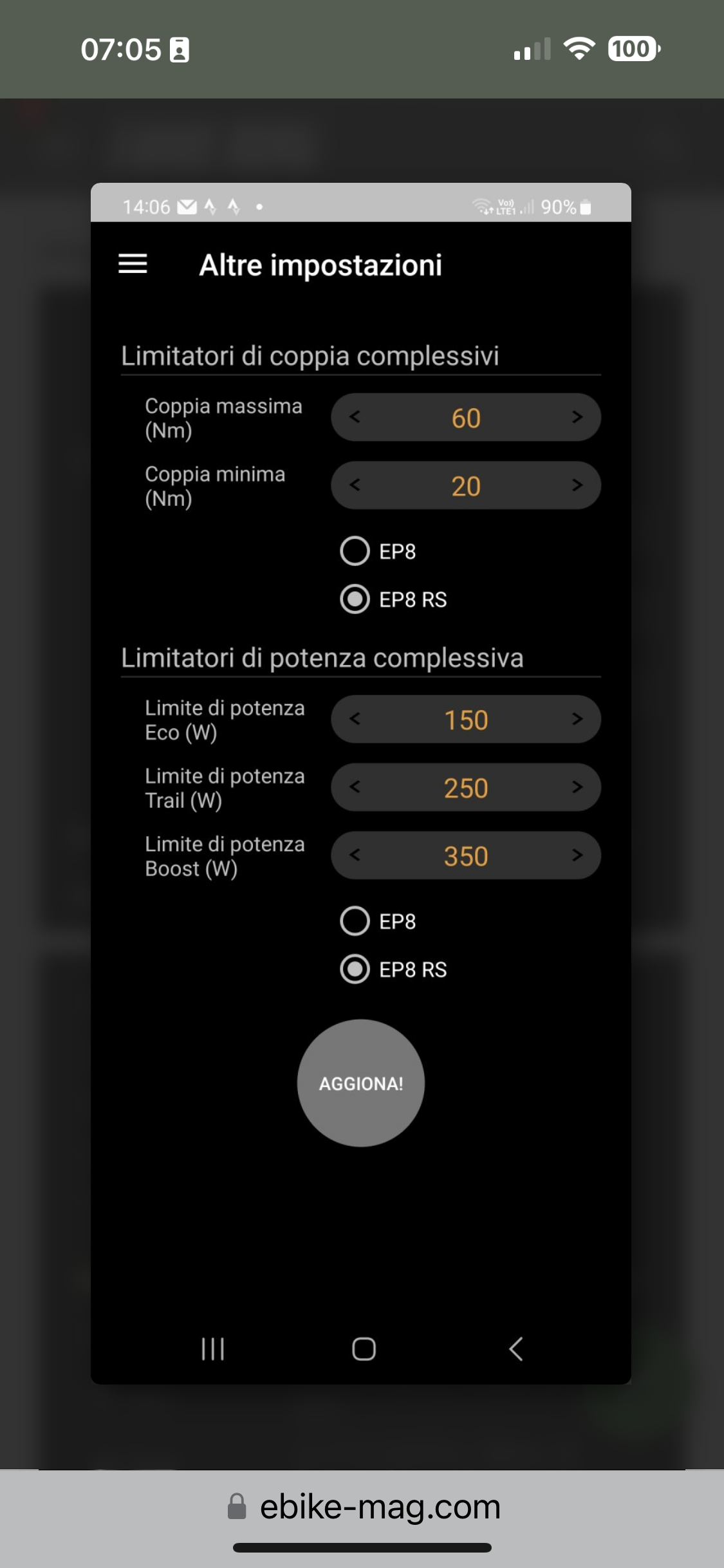

Connection with ep801 tested on new orbea rise 2023 yesterday system is connected and display data on the app unstlocker.
App not update to the new feature E-TUBE 15 level of assistance and it is still on 10 ( screenshot highlight it). Still not tested the possibilità to move from Rs to full power motor.

i have used the app Stunlocker with new ep801 rs … everthing works fine with exception of the power limitation… i can not change it
which area of STunlocker are you unable to change with ep801rs?
For ep801 when i try to change the power limit moving from rs to full power this does not change and go back to the oroginale configuration rs
I am not using any additional licenze Just the app.
Do i need the PCE02 modulo and labtop Windows connection?
I use windows version of STunlocker with a license. I connect to the bike at the EW-E100 junction using the PCE02 module. This method avoids all of the firmware issues when using only BT. I am able to customize the "Power and Torque" settings in the screen shot in my previous post, I don't think this is possible using only a BT connection. My question for anyone that might know is will this work on the EP801rs as well on 2023 model Rise? Works perfectly on my 2021 EP8.
I connect as shown below to bike, this is an extra EW-100 I have just for an example
As far as i know does not work for ep801 … i will test it ne t week anyway… instead minimax With pce02 should work
ok, pls post what you discover, very interested to know outcome
