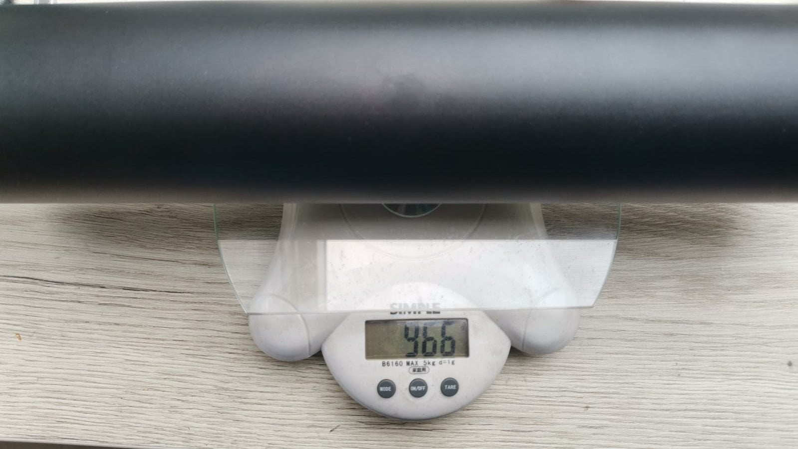

Well I started to build the bike and dropped the motor to install the cables. Unfortunately I found both endcaps of the Bafang battery housing broken during shipment.
Don't worry. You have the opportunity to throw away the 1 kg case and stick a strong adhesive tape on the aluminum guide. I would add some mounting foam inside the bike body so that the battery holds up well.
1kg! Crazy.. Did anyone consider 3d printed case as a replacement?
@LAnton thanks for your response. I would be concerned about the battery "swinging" without a bolted connection to the mounting bar...
I ordered new 720W batteries. I will receive them in 5 days. I have two empty cases for 720W. I will do the assembly without the case. The 720W case has a non-removable strap, I will have to ruin 1 case in order to cut the strap from the case.
To prevent the battery from swinging, TCFlowClyde suggested gluing it onto the mounting foam. I like this idea. I'll try to do it. Assemble a light bike and carry a piece of iron weighing 1 kg in the frame.

The 720Wh cases are very robust. The mounting bracket is molded as part of the case. It would take a lot of cutting to remove it.
Instead, why not just order the 360Wh mounting bar?
Will the battery configuration in my Bafang case fit in the round 720w case. I can remove the BMS from the old battery and install the new BMS for the round case but I have no welder to reconfigure the batteries.
View attachment 120086 View attachment 120087
The case looks pretty robust, could you mill out some material to make it lighter?
